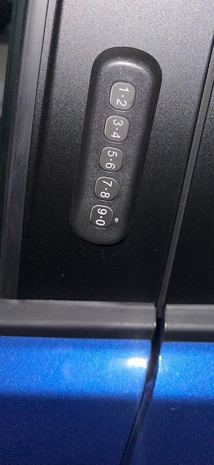

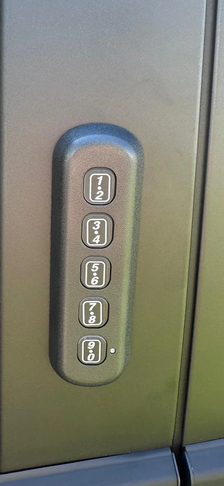

So I decided to place the wireless keypad vertically similar to the location of the OEM wired keypad for the Maverick. I then added 2009 Ford Explorer keypad stickers to the buttons to make it look better!
