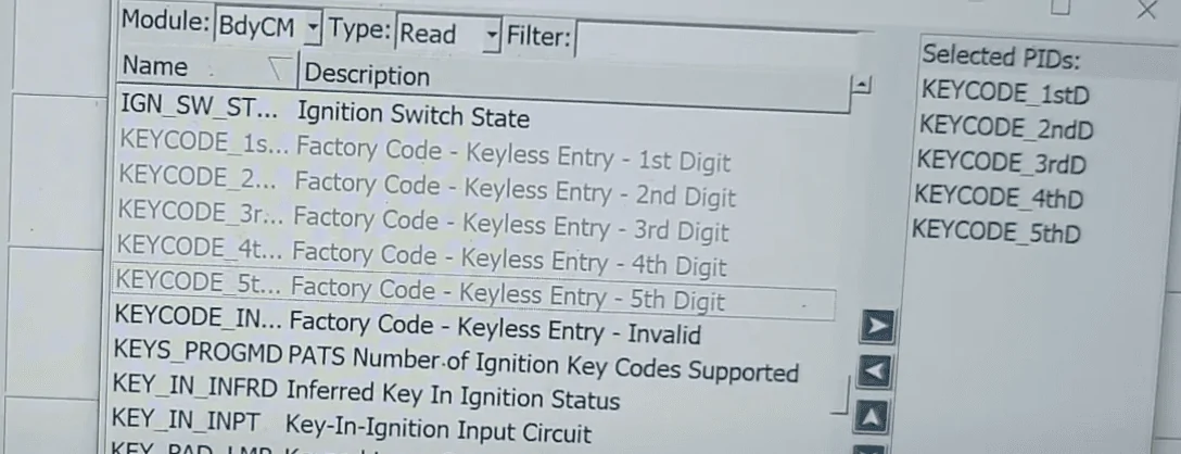

I guess the proper name is "Remote Keyless Entry Pad" and the setting is found in the BCM. Does FORscan have this capability?? Here is a video of some setting it with the dealer PDI(?)

I am going to try to use forscan to install this. I will let you know how it goes

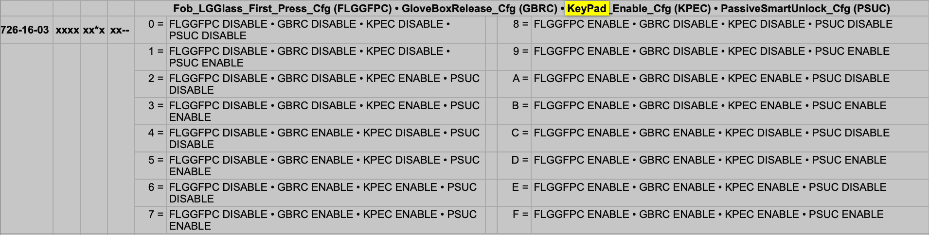

Is that for the keypad that they no longer provide on the newer models (like my 2024 Lariat) or for the add-on wireless keypad?? I am new to FORscan (but not computing) so I am not sure how to read those options as to what they do.

Hey so I was wrong and I ended up purchasing a 2 day license for FDRS (Ford Software) and using a OBD2 cable I purchased. This allowed me to I install the wireless door keypad myself. I would think the wired one is theoretically possible to install and enable with forscan but probably much much more difficult and the easier way is to just go with the wireless keypad and use FDRS or have the dealer do it. I found that Forscan cannot code the wireless keypad to work with the Maverick.
