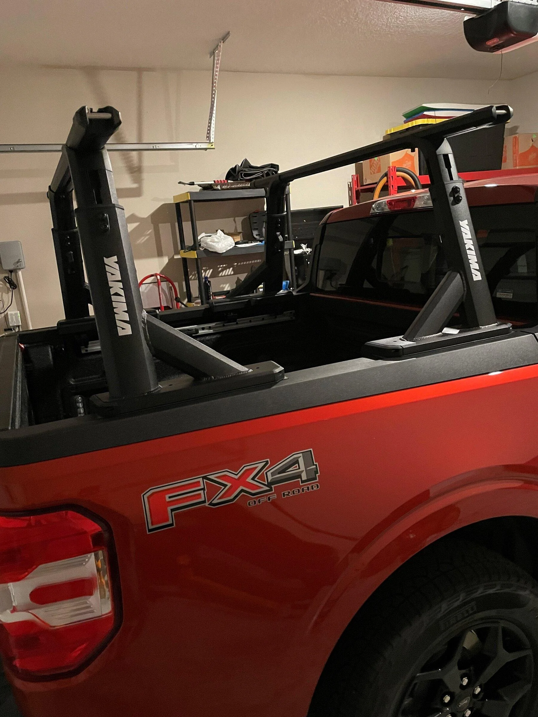

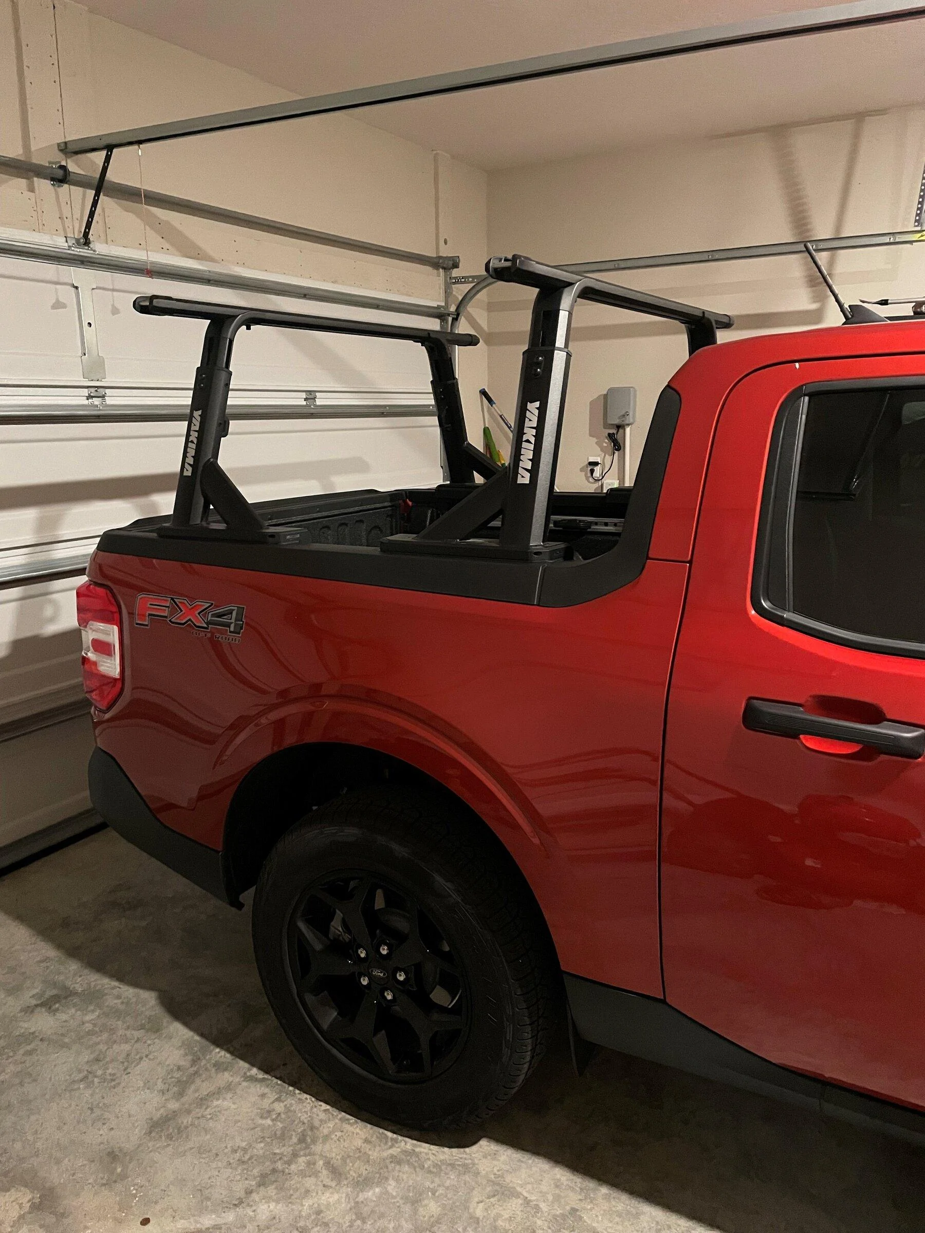

I have installed my bed rack using an 1/8" thick 2-1/4" wide rubber strip to keep the bases some what level (from McMaster-Carr - High-Strength Multipurpose Neoprene Sheet with Certificate, 12" x 24", 1/8" Thick 70A Hard). If you don't use a shim/spacer the bases will be tilted inward and you won't be able to attach the towers or they will will attach but be in a bind.
Ford Maverick Yakima BedRock (low profile bed rack) installed with Yakima basket Yakima Rack 1.1
Ford Maverick Yakima BedRock (low profile bed rack) installed with Yakima basket Yakima Rack 2.1

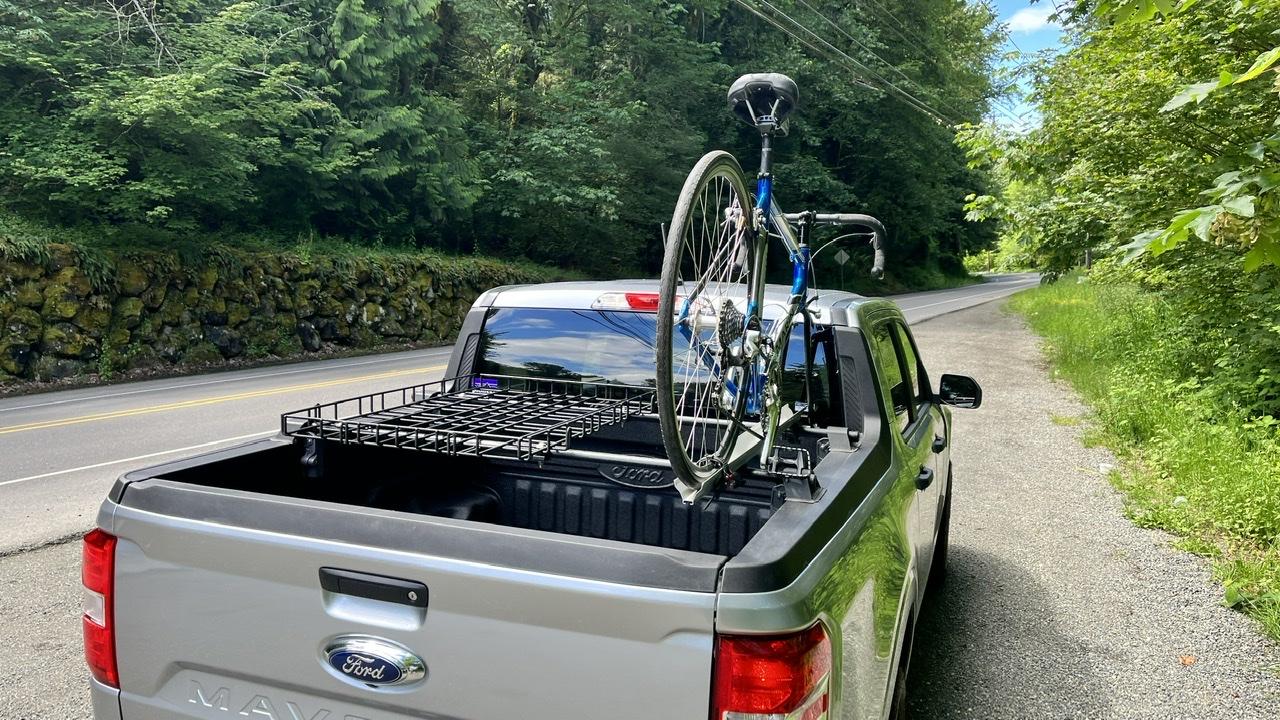

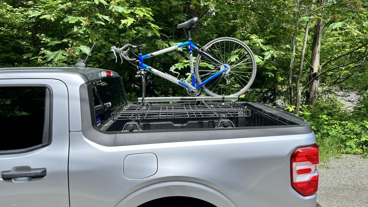

Had to shuttle a bike out to my daughter. So I dug around and finally found my old Yakima fork mount bike attachment.
Here it is on my Bedrock.
Round bars! Old Skool baby!
Ford Maverick Yakima BedRock (low profile bed rack) installed with Yakima basket DAC4E4DD-6746-48AA-8AF1-CE488DB8AF3F
Ford Maverick Yakima BedRock (low profile bed rack) installed with Yakima basket 0E2DD917-B2BC-4F78-97C7-0E208F6628F4
