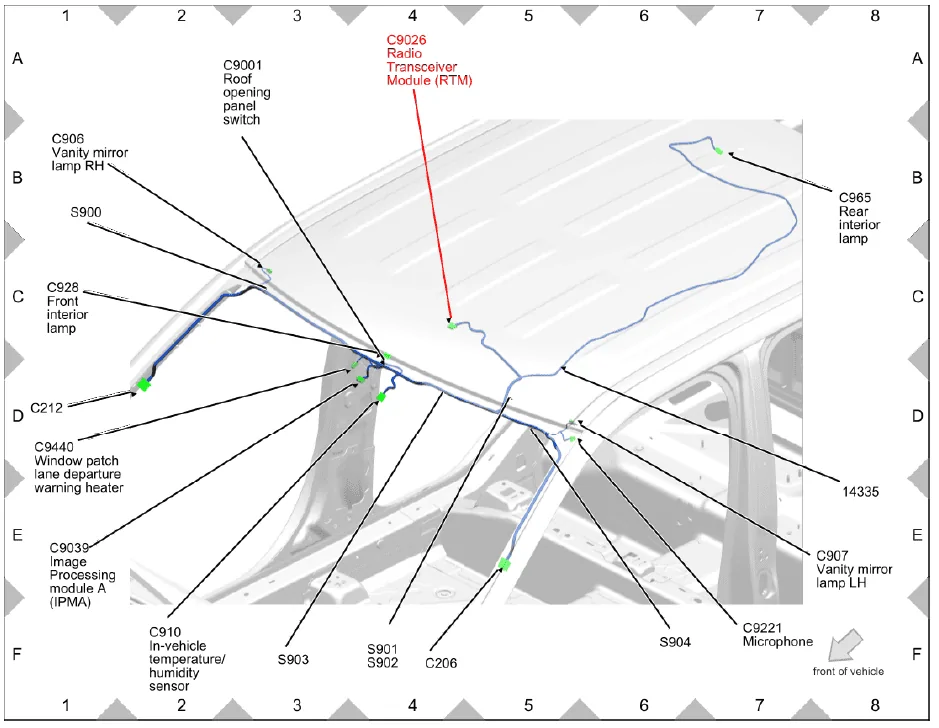

Does anyone with a service manual have a diagram of factory-antenna location(s) for the keyfob transmitters? I'm hoping its a matter of the factory either not including enough or placing them in a location with interference.

Think I found it:
RTM
The RTM communicates all RKE and passive key information to the BCM over a LIN circuit and when awake the CAN . The RTM is an antenna that receives the high frequency signals from passive keys. For additional information:
Refer to: Handles, Locks, Latches and Entry Systems - System Operation and Component Description (501-14 Handles, Locks, Latches and Entry Systems, Description and Operation).
Refer to: Tire Pressure Monitoring System (TPMS) - Vehicles Without: Keyless Entry and Push Button Start - System Operation and Component Description (204-04B Tire Pressure Monitoring System (TPMS), Description and Operation).
Refer to: Tire Pressure Monitoring System (TPMS) - Vehicles With: Keyless Entry and Push Button Start - System Operation and Component Description (204-04B Tire Pressure Monitoring System (TPMS), Description and Operation).
The RTM requires PMI when replaced. For additional information,
Refer to: Module Programming (418-01 Module Configuration, General Procedures).

Radio Transceiver Module (RTM)
Removal
NOTE: Removal steps in this procedure may contain installation details.
NOTE: If installing a new module, it is necessary to upload the module configuration information to the diagnostic scan tool prior to removing the module. This information must be downloaded into the new module after installation.
Carry out the PMI procedure for the RTM .
Refer to: Module Configuration - System Operation and Component Description (418-01 Module Configuration, Description and Operation).
Lower the headliner.
Refer to: Headliner - Lowering (501-05 Interior Trim and Ornamentation, Removal and Installation).
Disconnect the electrical connector, then release the RTM bracket clips and remove the RTM .

So the short of it is likely a new RTM is needed for my case, reprogrammed keys n tested votages already but that's also where the service manual seems to end on it. Dealer already said they'd not prioritize (duh) and even if they had the RTM is definitely, for sure, on backorder.
