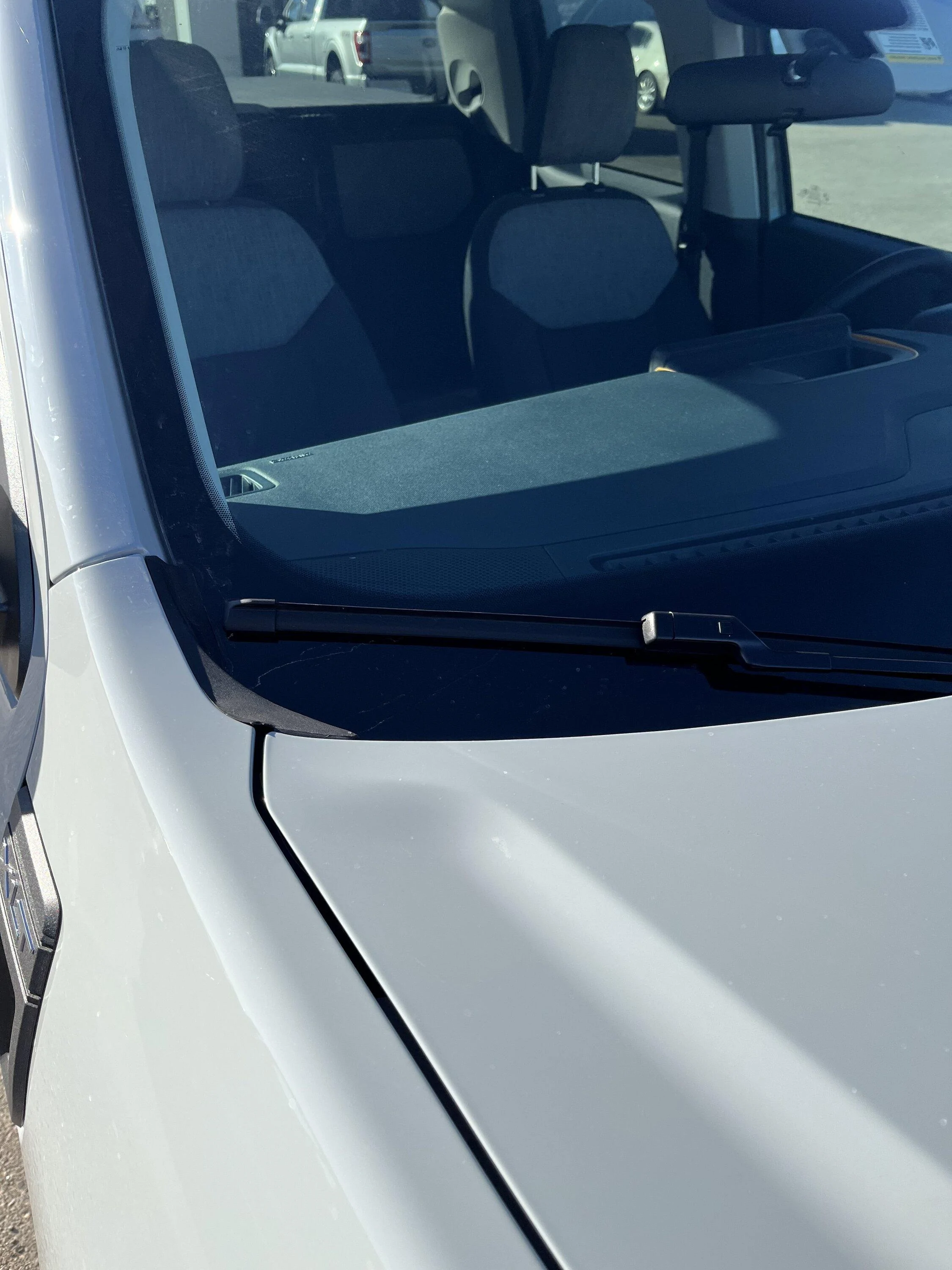

I went to dealer today for first oil change, complained about the wipers not “parking” all the way down, they said this is normal
Ford Maverick XLT Hybrid - Issue with windshield wipers 78FC242F-A964-4DAC-83CF-D6CF87E2A991

this is normal.
When close to the wiper park position the gear mechanism ratio changes quick for it to get more movement. Nothing to worry about
I drive 2 Mavericks, neither one of their wipers work like the video.
Train transportation covers all the cars with metal dusts (mostly from train wheels) that dealers are supposed to clean off...some dealers do a really lazy job of removing the dust. Neither of my Maverick do anything close to what your video does..
I'd clean lower part of windshield with Dawn soap and give it a try.
Looks like they are parked where they are supposed to be, about 1/8"-1/4" from the small piece of trim.
That's normal.

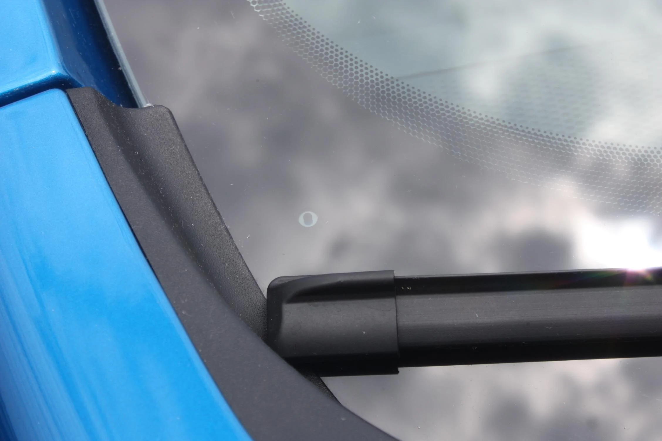

If you want to know if your wipers are truly parking correctly look closely at the windshield near the tip of the blade. There will be a clear circle with a black dot in the center. That is the alignment mark your wipers should be resting at.
Ford Maverick XLT Hybrid - Issue with windshield wipers img_3313-jpg
(From this thread, This wiper is parked too low, for instance)

Well I will be damned….mine is right on the mark…..I would have thought they would nest lower than that so that the heating element in Lux package would be more effective…..as the late great Rita Radnor used to say “Never Mind”. Thanks for your help
I believe her name was Gilda.
