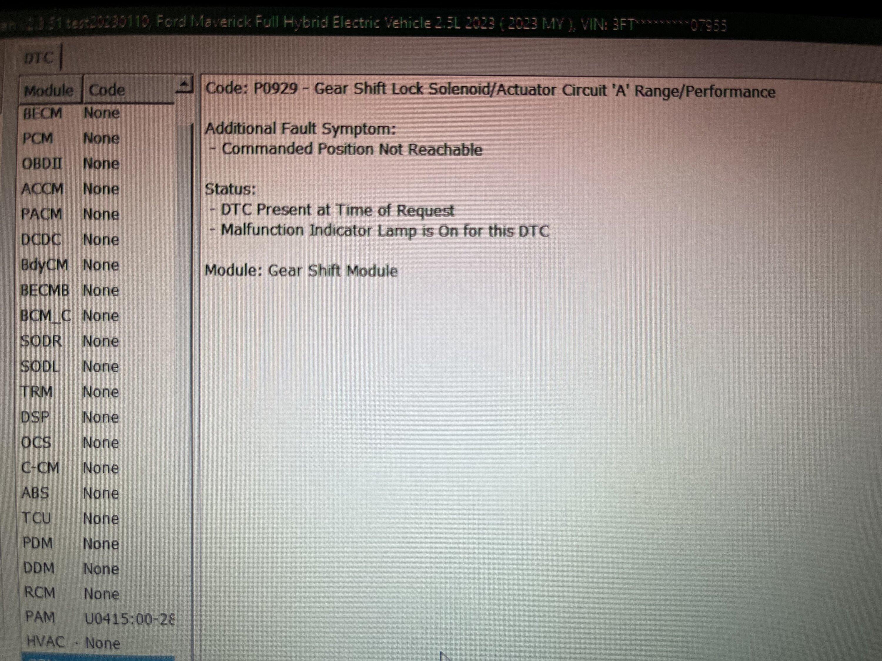

I’ve had it happen twice on my ‘23 hybrid. I jiggle/spin the gear dial around while the vehicle is in accessory power (when it should be locked but isn’t) until it does eventually lock. This resolves the problem.
I’m waiting for some TSB or other action to cover 23s before I waste my time taking it to the dealer.
Ford Maverick Wrench/Service Soon Light?? 11A89BD2-82FE-4851-8042-20149486A112

I was attempting to quote tom_trucker but failed.
Because this thread is the top result using the search tool, I hope other 2023 model owners run into it. The sea of warning messages and lights is probably this same non-issue.
