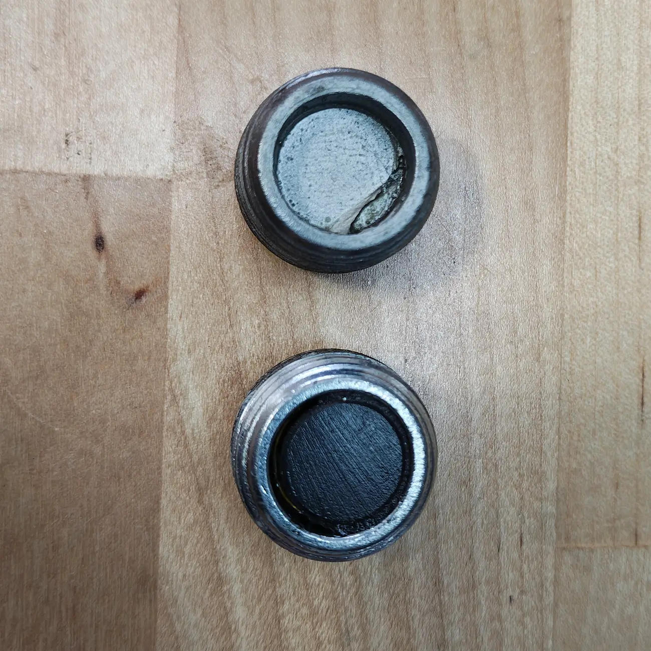

Did my RDU & PTU last weekend, I've had the Mav for a year, but have clocked less than 6k miles on it, the fluid refreshes were pretty easy overall, both seemed to be just under proper fill.
The RDU fill plug situation was a bit troubling, the magnet was missing. It's my understanding that the RDU fill and drain plugs are the same 6C2Z4N282AA part.
Whether the magnet gone missing happened prior to plug installation or the magnet got munched by the RDU gears is unknown. The drained oil was dark, I ran it through a fine steel screen and there was no obvious magnet residue.
They arent the same. The top does not have a magnet. Don't worry. If they are the same thread pitch, you can have a magnet installed top and bottom no worries.
Yeah, it's taken me awhile to respond, too much life goin' on.
Anyway, thanks for the response.
If you peruse the top plug in my photo, there's a chunk of something in the lower right quadrant that was firm to a dental tool poke and didn't appear to be magnetic, I assumed it was the remnants of whatever adhesive is used to glue the magnets into those plugs.
I'm not too worried about it since screening the used fluid didn't reveal any magnetic bits . . . of course any magnetic debris could be stuck to steel parts inside the RDU.
