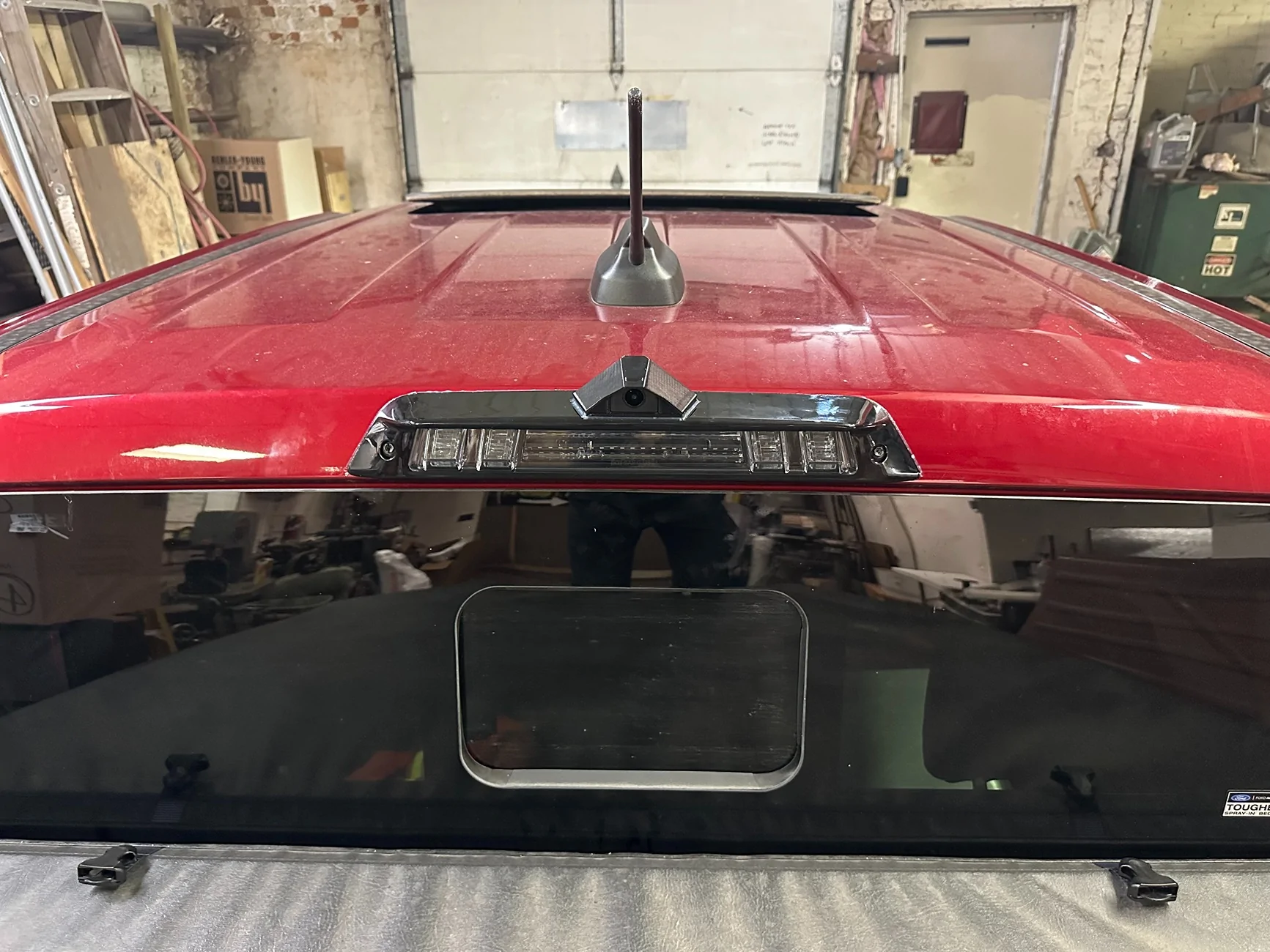

Ford Maverick Wolfbox rear cam installed inside 3rd brake light assembly PXL_20260929_191612951

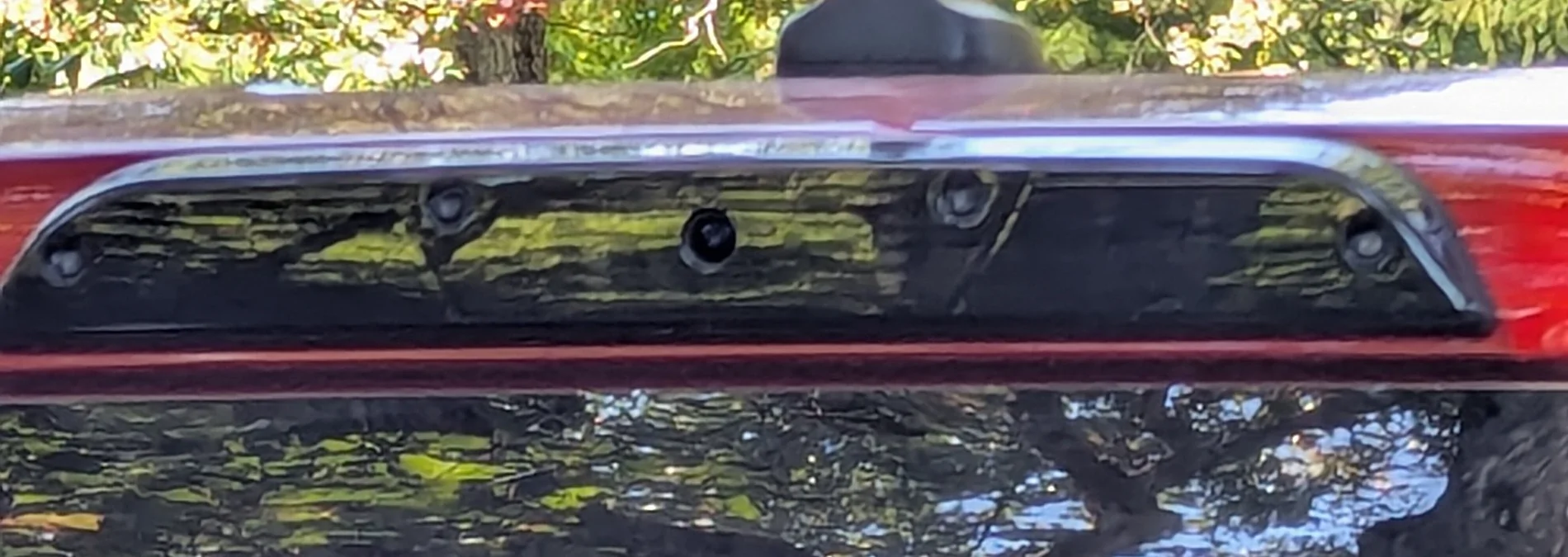

Wanted Wolfbox G900 Dash Cam for 3 reasons: blind spot mitigation, better view of cargo, and rear view with tailgate down.
Took me forever to install it because I hate hate hate the way it looks as an exterior installation; it looks like an afterthought to me. My eyes go right to them like a magnet, which is odd for me because I don't normally care about the way vehicles (mine or other folks') look.
Anyway, one day it hit me that maybe I could install it inside the 3rd brake light assembly. I asked an AI and it said yup, it'll fit. As an experiment, I ordered a $28 Nilight replacement brake light off Amazon. It is smoked, which helps hide the camera inside the unit. User Dave O did make a mention/question about this idea here, but I didn't see any followup by anyone.
Ford Maverick Wolfbox rear cam installed inside 3rd brake light assembly PXL_20260826_173745332

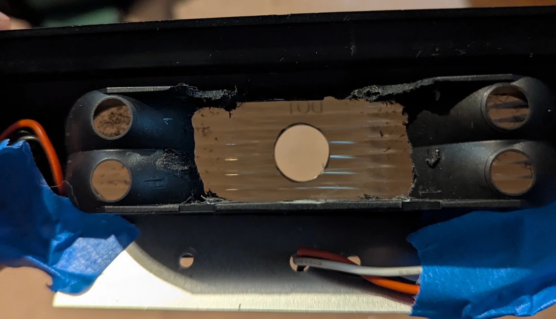

Used a Dremel to chop out space for the camera. Black urethane roof sealant holds camera in place. Yes, this was a no-going-back sort of experiment. Worth noting that in chopping out some of the guts, I did lose (cover) 2 of the 6 red brake leds. The 4 remaining are plenty bright, and I'm not concerned about violating a DOT rule about # of lumens here. I like that the finished job looks 'intentional' and it disappears from notice. I do need to get a pic of the red lights when the brakes are on; 2 on each side of the camera hole, so it looks balanced.
Ford Maverick Wolfbox rear cam installed inside 3rd brake light assembly PXL_20260929_195653798~2

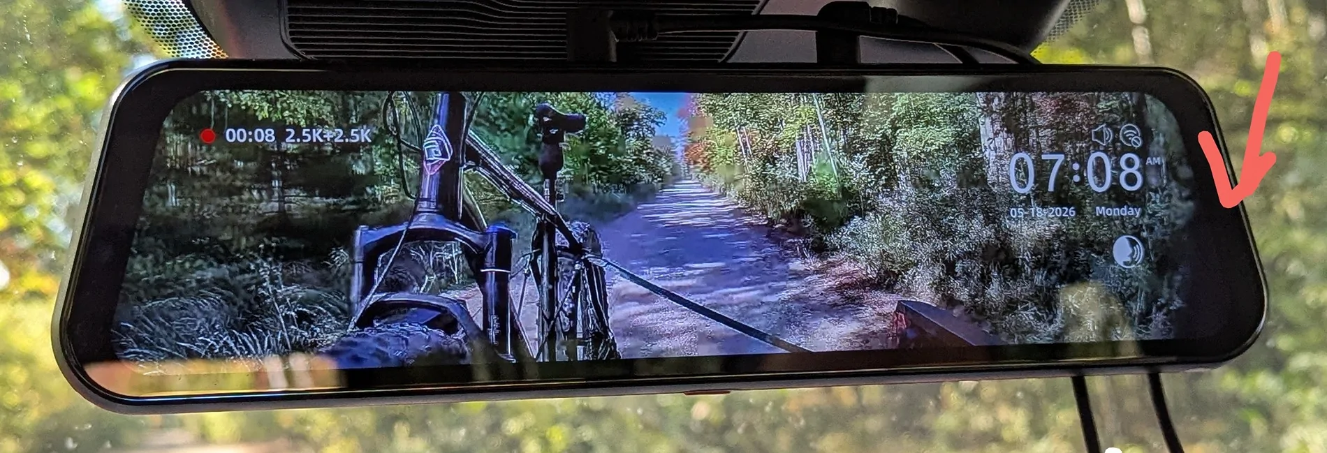

The results? I'm delighted! I had originally thought about installing camera inside the cab, but the tinting costs too much light for my liking. See post here. Did I do a perfect job? Alas, no. While the urethane was curing (for a week), I failed to notice that I placed the camera a tiny bit off-center: see red arrow in above pic for the area I lost on that. I could bevel that edge of the hole and likely recover that area, but I'm guessing future me isn't going to do that. Walking around the truck, no one notices this; it looks perfect to passersby.

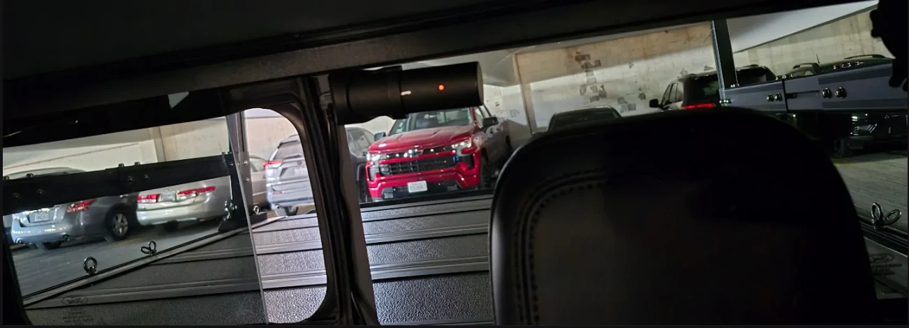

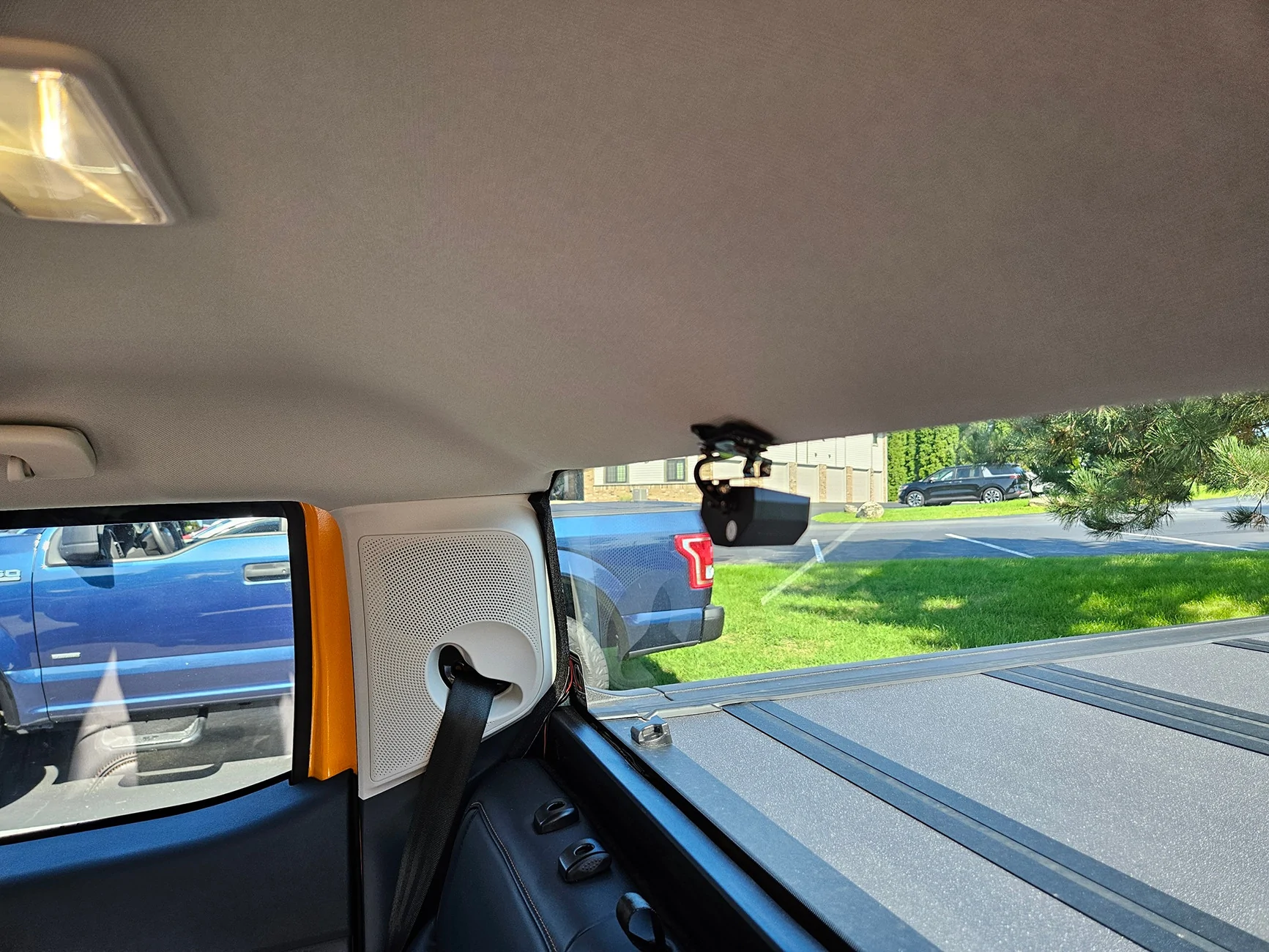

I chose to keep the rear camera inside the cab.
Ford Maverick Wolfbox rear cam installed inside 3rd brake light assembly 20260822_094820
No extra tint beyond factory window. Yeah I pulled the back seat headrests for better visibility out the back.

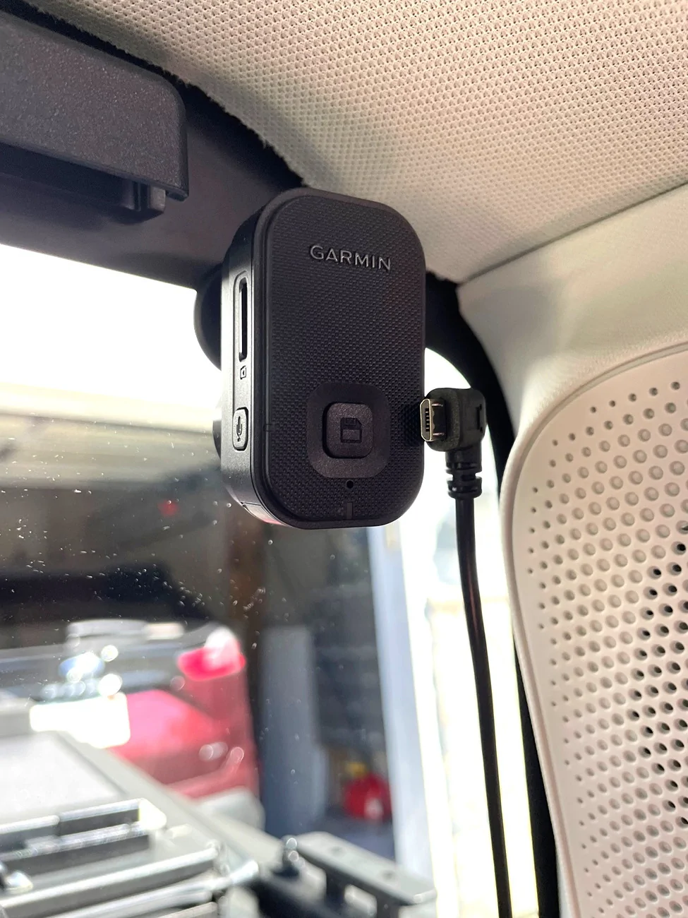

I like this install ...very clean. For now I'm using the same camera that I've moved from my last vehicle, mounted inside:
Ford Maverick Wolfbox rear cam installed inside 3rd brake light assembly 1790795460355-3s
Ford Maverick Wolfbox rear cam installed inside 3rd brake light assembly 1790795507621-wu
