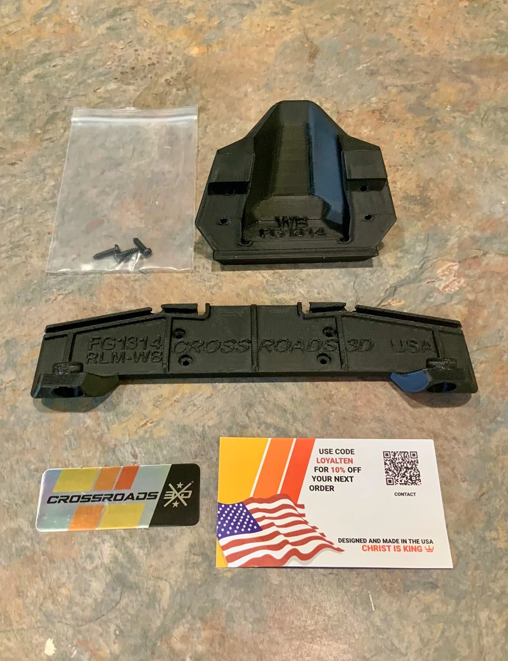

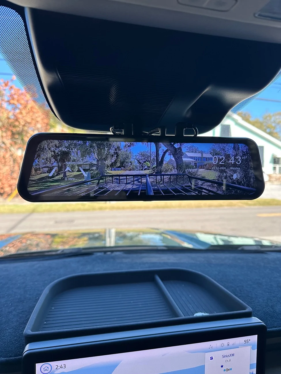

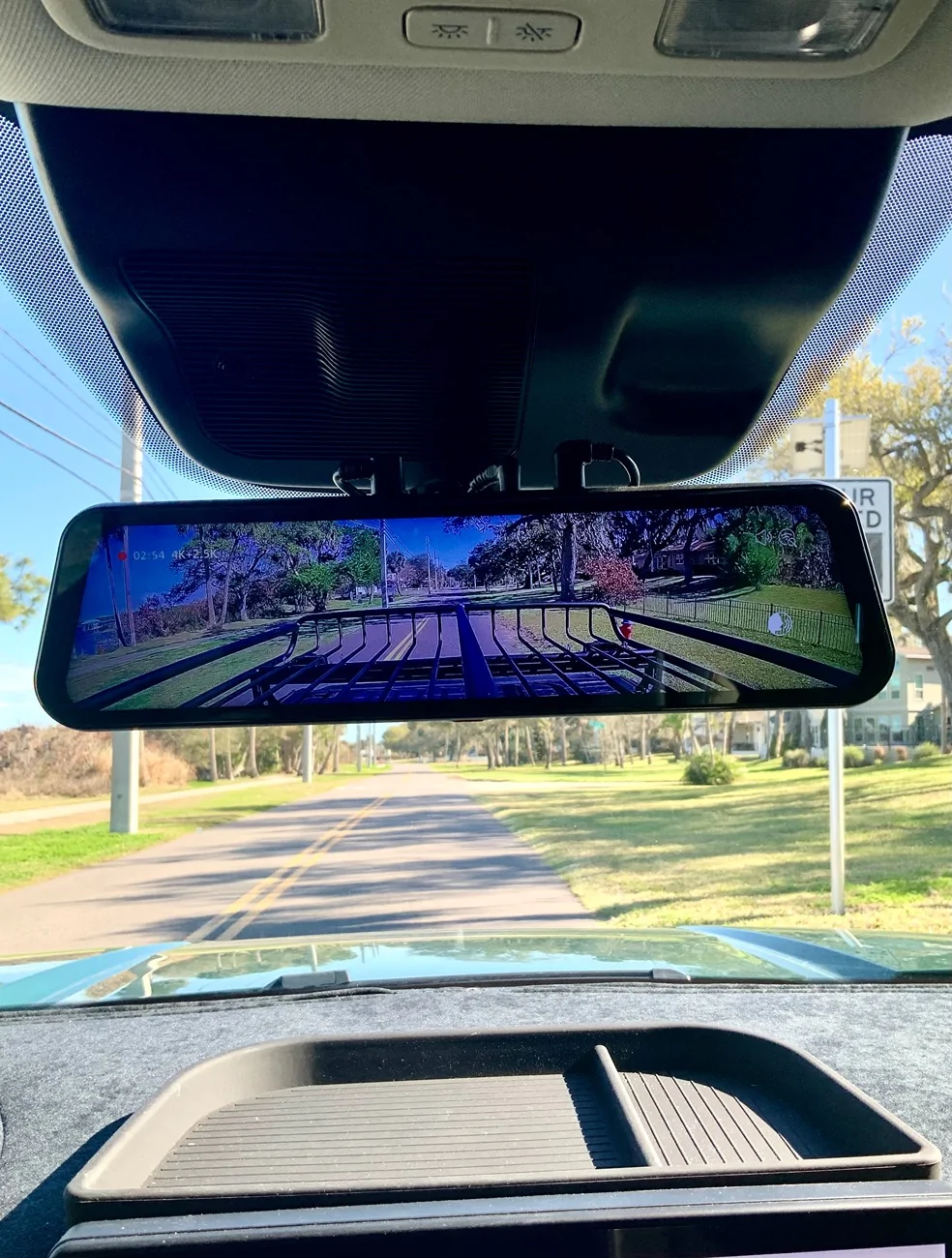

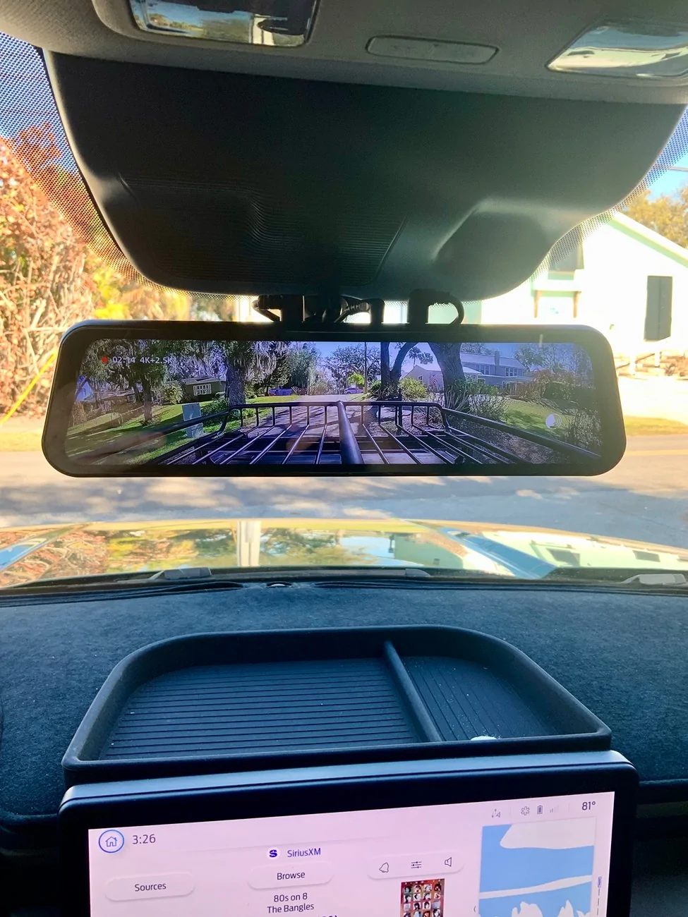

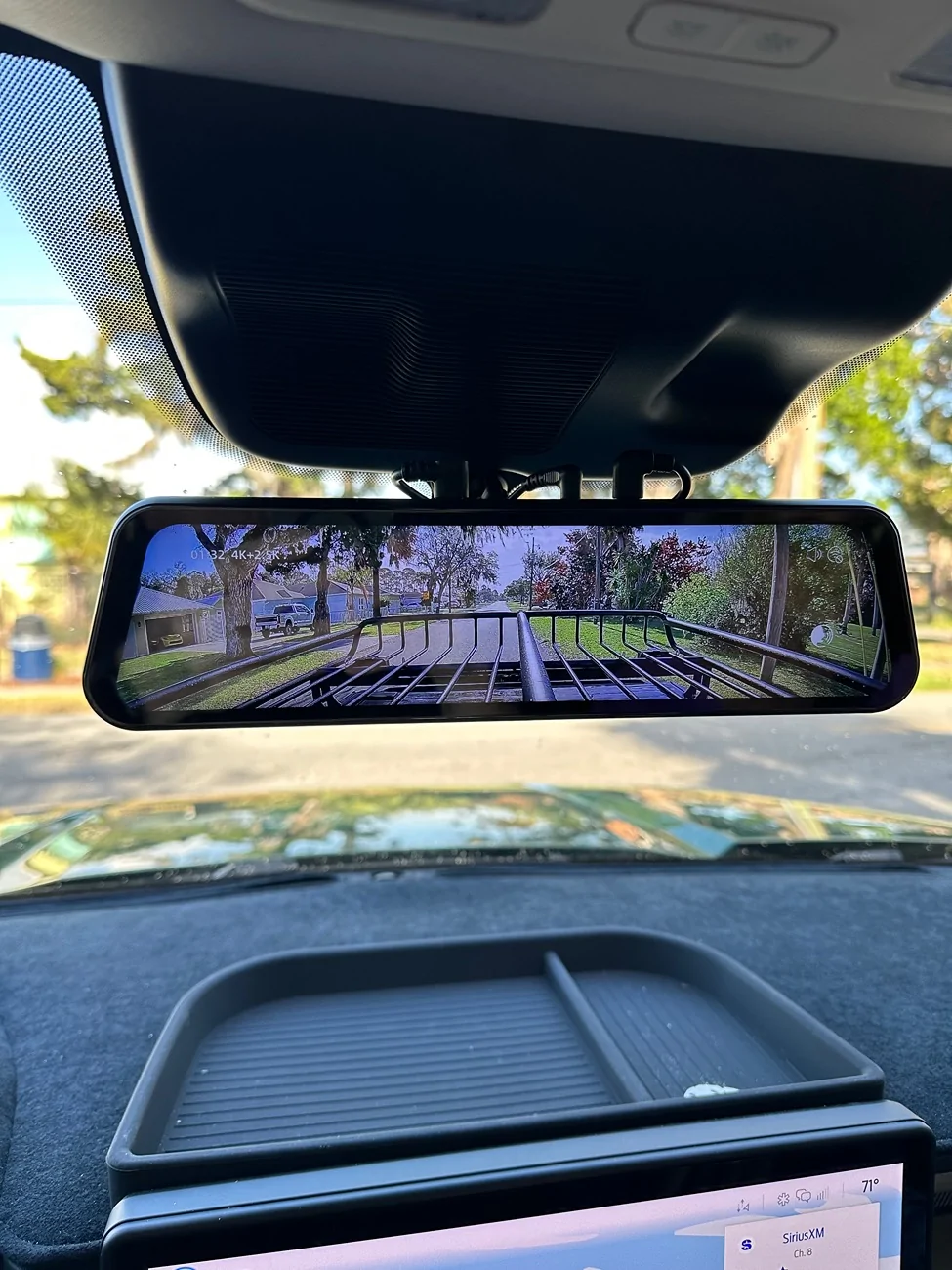

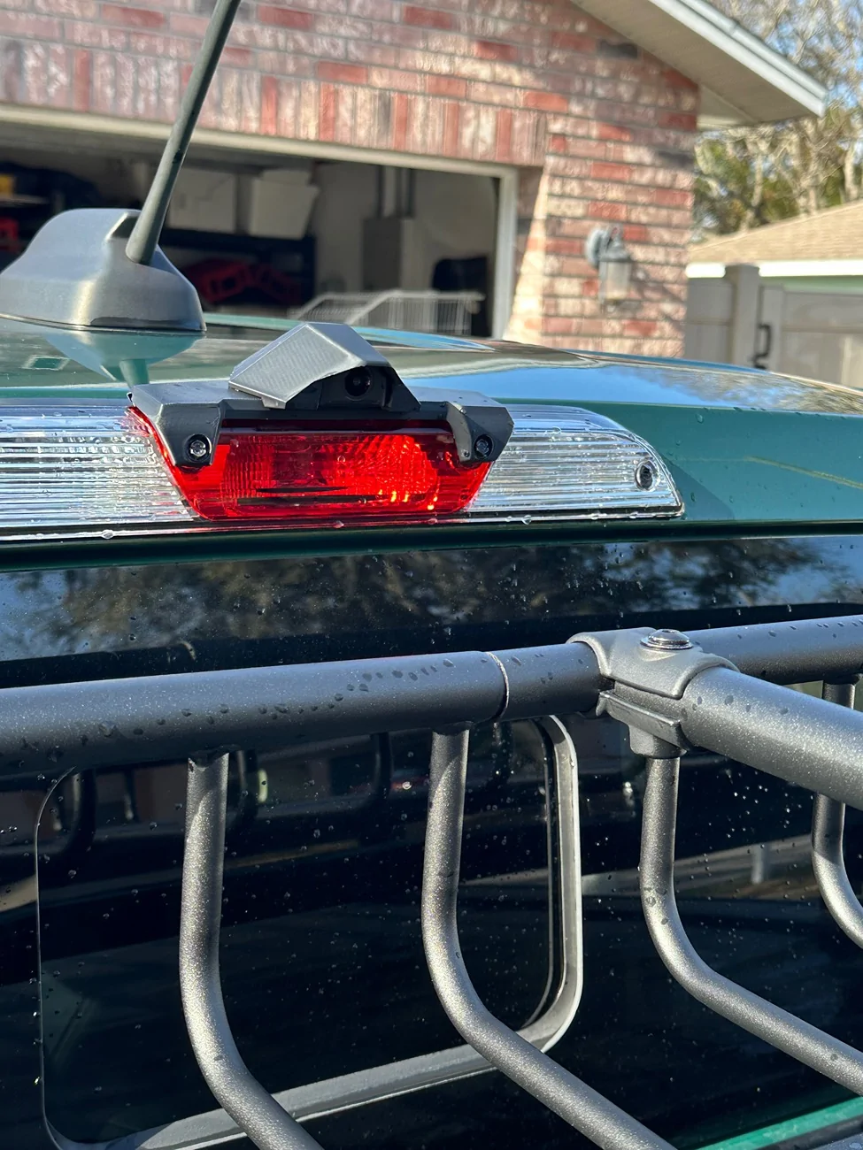

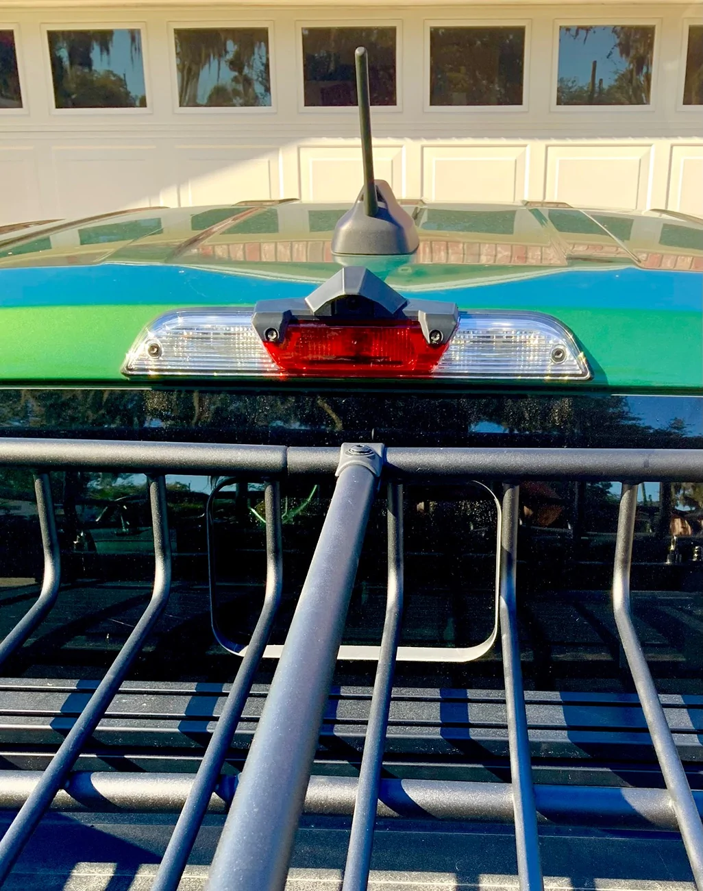

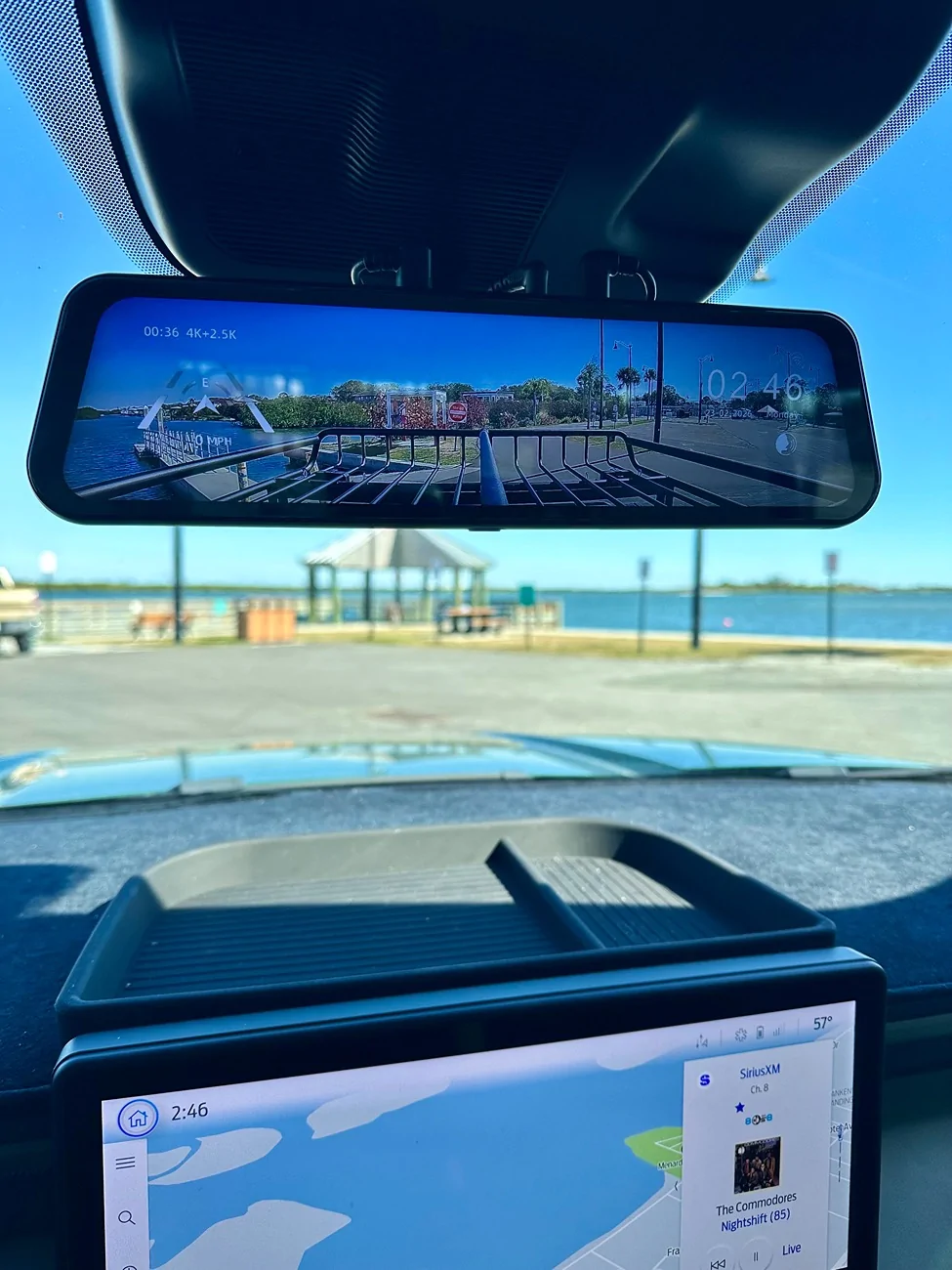

Got the new Crossroads 3D WolfBox Rear Camera Mount for the 3rd Brake Light today. The materials are a good quality as well as the 3D Printing. The installation was very easy and all the parts fit well together and all the screw holes lined up perfect. This camera mount is specifically for the WolfBox G900 TriPro Rear Camera and is designed to mount on the 3rd Brake Light using the two OEM center screws it is my understanding this mount will fit multiple Mavericks and F-150 Models years.
i added a few few pictures to show the Mount and the views after installation - I feel the camera is very well protected from the elements and it is very secure I would have no worries going through a high pressure cash wash with this unit.
Note the camera has to be mounted upside down compared to the original brackets supplied by WolfBox which is not a problem - if you go to settings on the dash cam and ”Flip” the view that is corrected, you will also need to go to the “reverse line” option and switch that as well so the view is correct in the image left to right.

Does the camera angle seem good?

I’m really impressed with the quality the angle seems fine I know the picture may not do it justice but it’s good. The WolfBox has so many setting you can adjust the view without physically moving the camera and the range of adjustments are pretty good - I really like how sturdy the mount is this baby ain’t moving it’s a well thought out design - the hood over the camera lense protects it from dew or water dripping onto the lense everything is true with close tolerances and the mount lines up perfect with the OEM holes on the brake light…

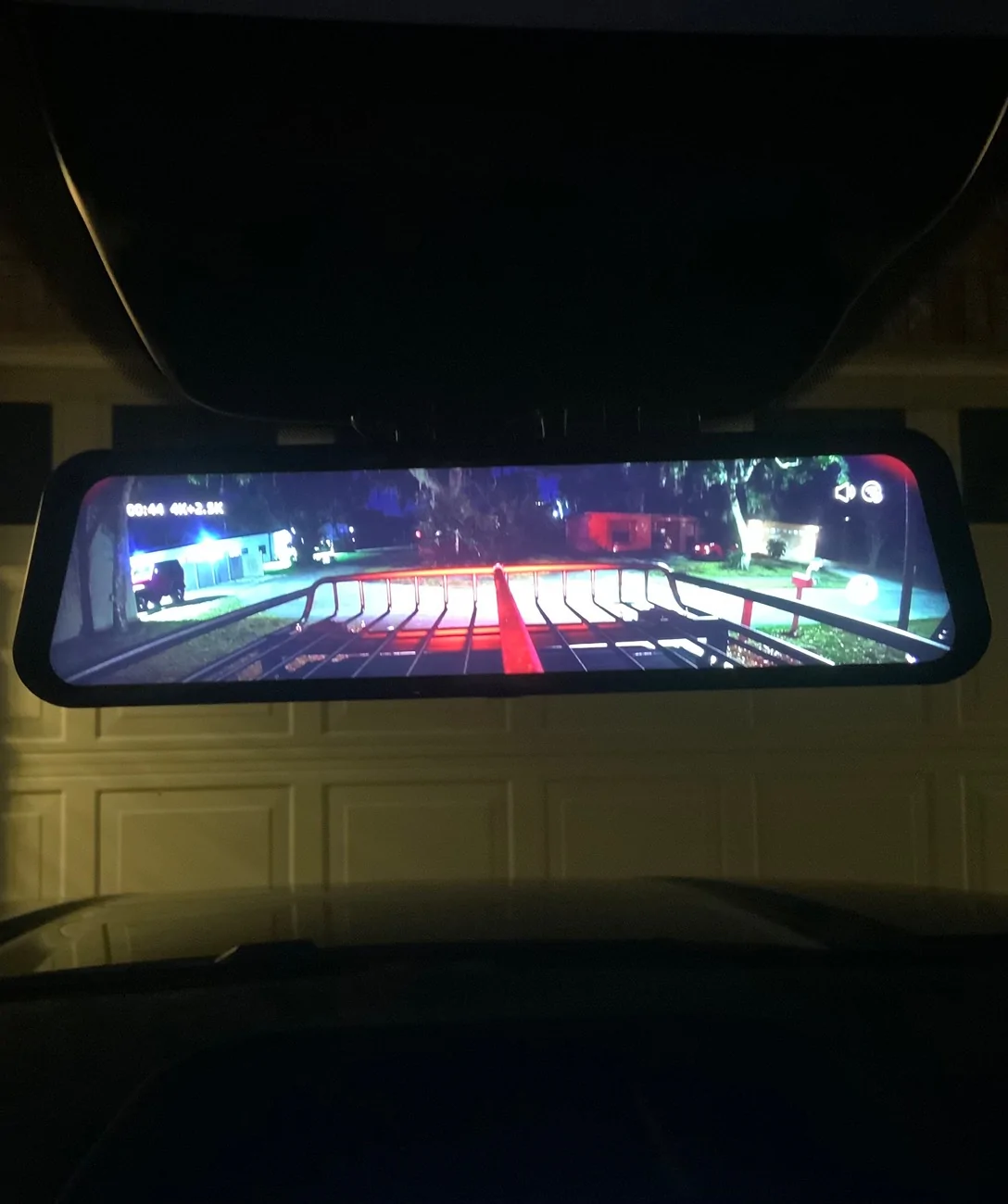

I will go out and take two night photos one with no brake and one with the brake depressed so you can see

My driveway is dark with street lights behind me so the pictures are not as clear as it is driving down the road at night - one photo with no brake light the other with my foot on the brake
You really didn’t have to do that right now. It is extremely appreciated!
Doesn’t look like any light bleed/reflection from the shroud which is really nice to confirm. Thank you for sharing the find and running the test.

no problem I was curious as well since I just installed it this afternoon - I have a Yakima basket on the truck now which is pretty high you can see the bar illuminated I’d say if I removed the basket you may not even notice the brake light at all

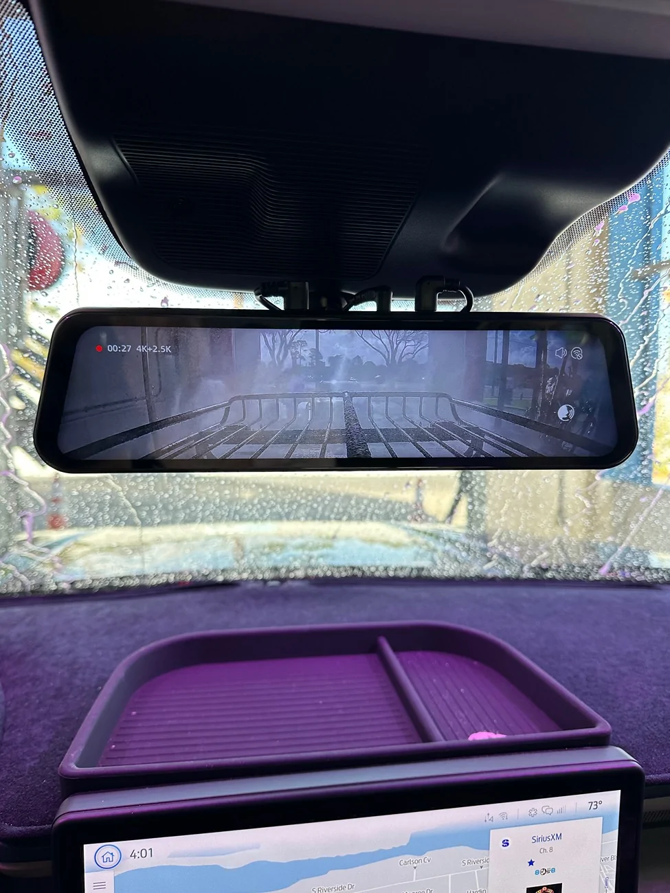

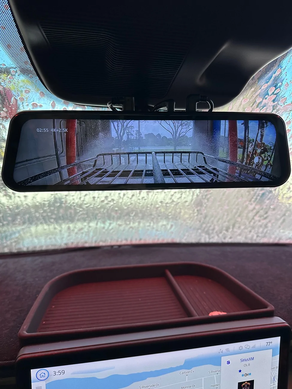

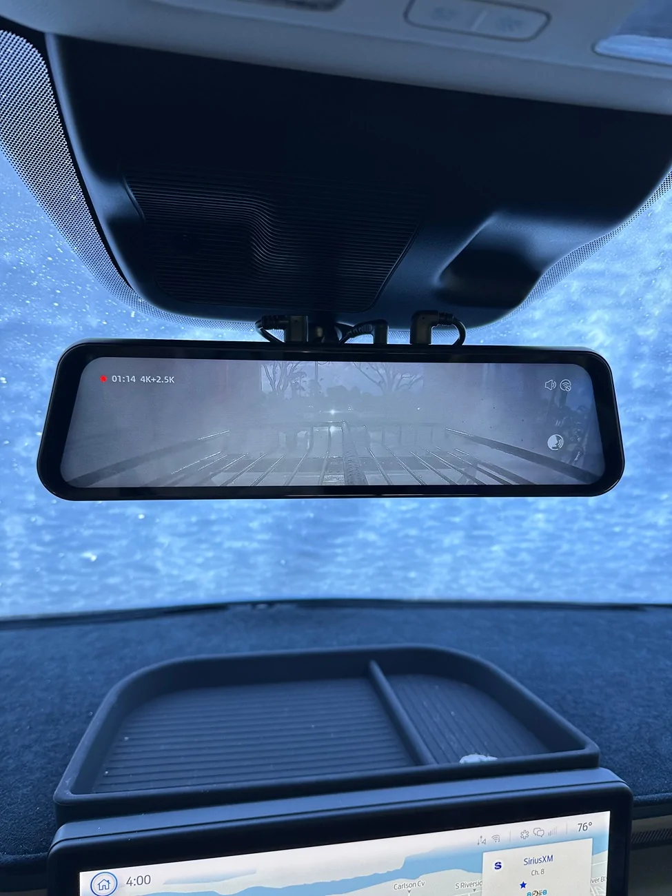

Automatic High Pressure Brushless Wash Results
I took the Maverick in for her first high pressure brushless wash since installing the WolfBox G900 TriPro Camera and Crossroads 3D exterior 3rd Brake Light Rear Camera Mount and I couldn’t be more pleased with the results.
The clarity of the Rearview Camera less than 15 seconds after exiting the wash bay was impressive, the exterior camera mount performed just as I was hoping.
i attached a few photos of the view while in the wash bay and one showing the mount after I got back home - absolutely no issues…
