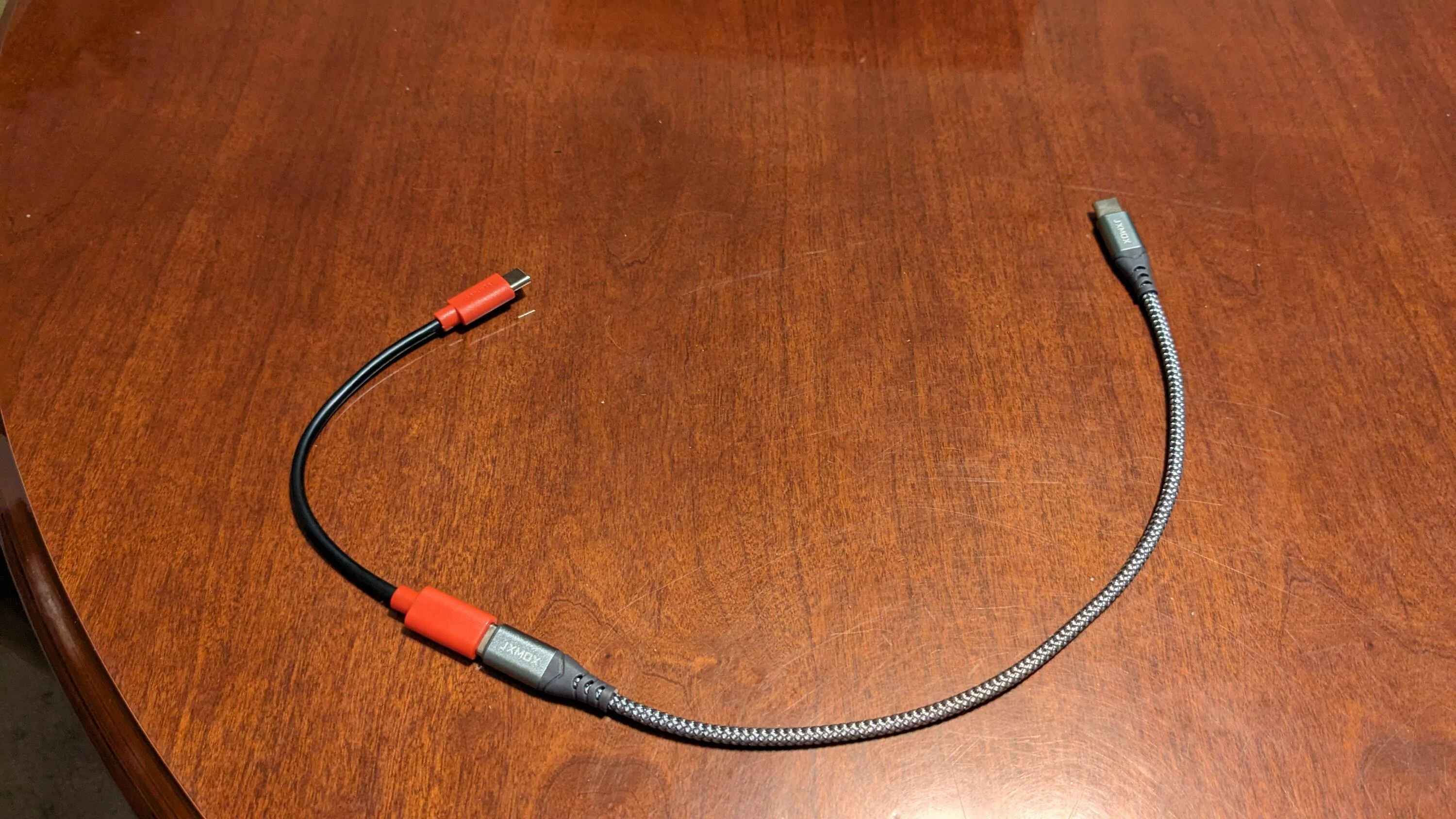

I have a Motorola MA1 Android Auto wireless dongle I use with a Pixel 6a phone. I've had flawless service using these except for a recent incident.
On a longer trip my phone battery was running low, so I plugged it in only to charge since it was connected wirelessly already. I plugged it into the USB-C port above the USB-A port in the lower center console. This didn't cause an issue at first.
We stopped to eat for about 1/2 hour. I left everything connected as is during that time. When we returned and I started the truck the Sync 3 lit up and Android Auto started normally, but Google Maps was stuck and pressing AA buttons did nothing. It was all locked up. I had to unplug both the phone and the MA1 and replug in the MA1 to get things to work correctly again.
After some reading I learned that others have had the same issue when the phone is connected both wirelessly and via a cable to data ports and the system is restarted.
So, I ordered a "charging only data blocker" cord to place inline with my charging cable (short red & black cord in pic). This prevents the cord from transferring data but still allows it to be used for charging.
After retesting a couple times by hooking everything up and restarting the vehicle, I've not had the problem again.
Thought I'd share in case it could help someone else. A person could also just plug their phone in via the rear seat USB to charge since that one is not a data port, or unplug the wireless dongle and use a cord for both charging and AA, and get the same results.

Where did you get the charging only cord? I to have the Motorola dongle and the wireless charger. The 12 v is used by a radar detector
However that cord would be nice to charge a passengers phone. But would love a usb c to usb c charge only.

I got it from E-Bay. They're on Amazon too, but it didn't have free shipping.
https://www.ebay.com/itm/404789971790
I plugged that into a short USB-C male to USB-C Male cord.
