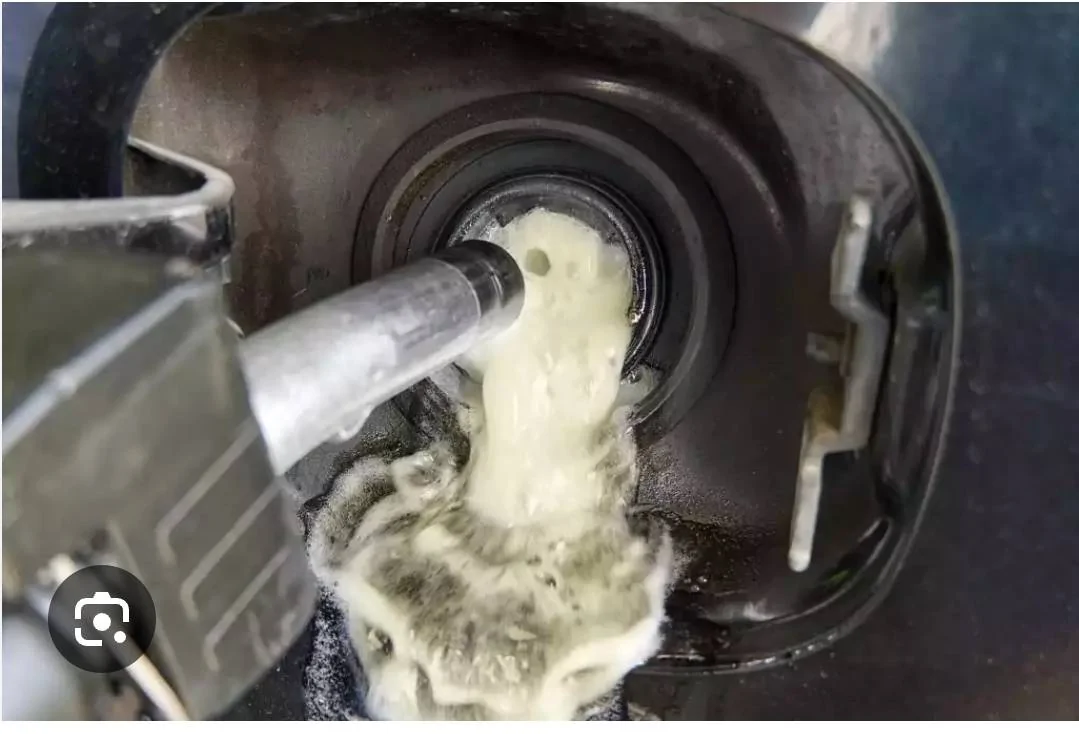

I fill my tank till I see this.
I'm trying for that coveted 1000 Mile per tank full trophy.
That's how I roll.
That's what the yellow triangles are for in that book likely found in your glove box.
Did AI draw that?
