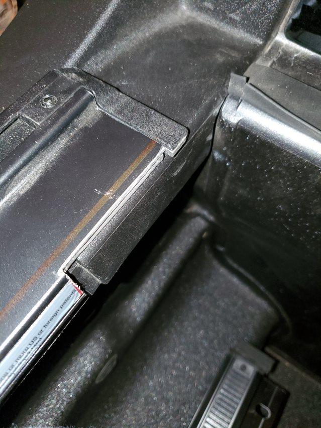

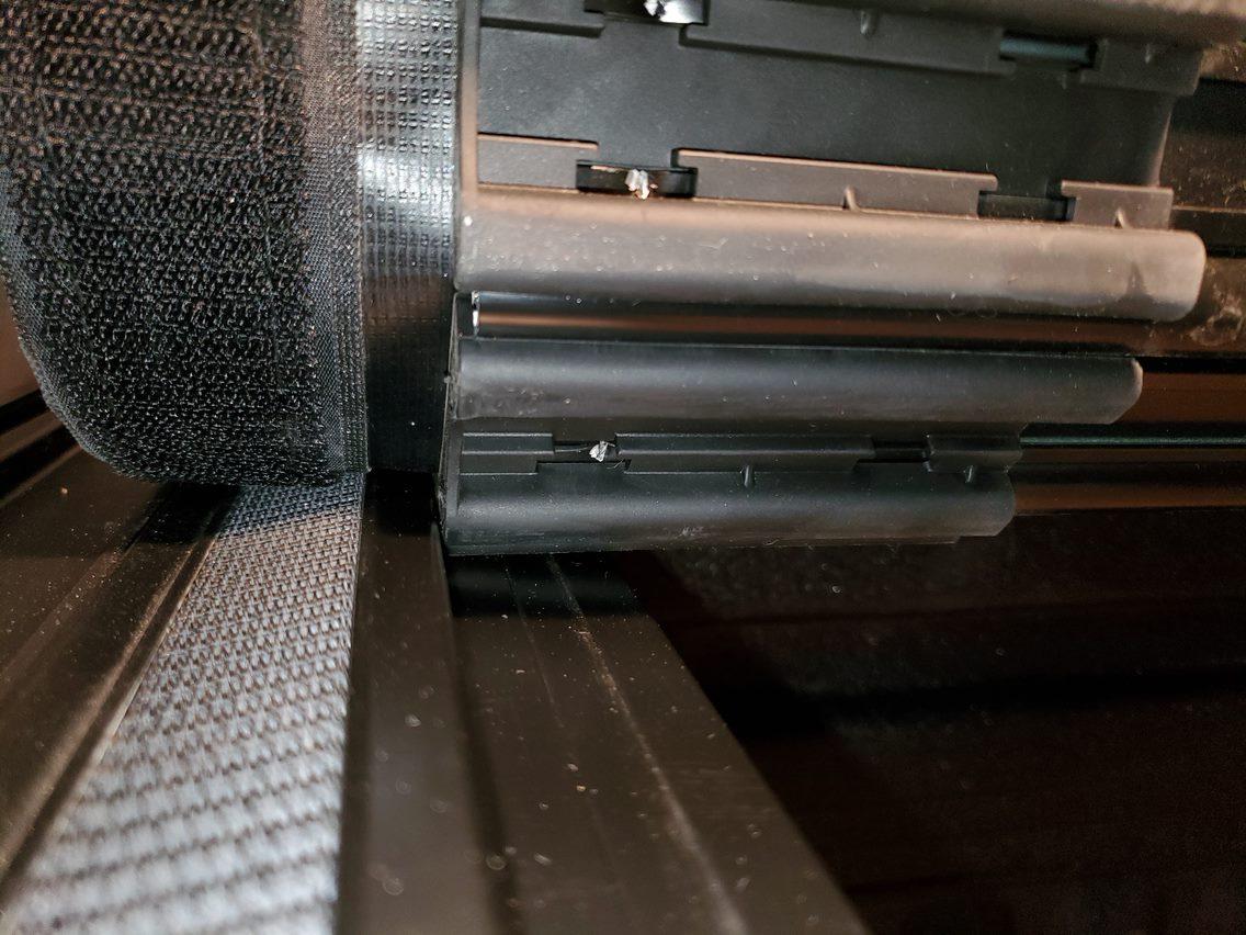

I use the Elevate TS rails to support a self-built folding ladder rack, and I've been searching for a hard folding cover that will fit between the T-slots with my mounts installed. I tried an early version of the BAK Revolver but it would not fit with the Elevate rails sandwiched in too. That experience also made me want to avoid any cover with wide/fragile extruded aluminum mounting rails that impede side access to the bed. Can you comment on the shape of the rails regarding their interference when reaching over the side into the bed, and how tight the fitment (width) is with the Elevate system in place?
I bought a Sentry CT for my 2023 XLT and the TS rails and had major headaches with the installation since the box was simply not wide enough - especially near the cab. We ended up having to cut 2.5" of vertical leg from the front of the TS rails as well as two small pieces of the overlapping vinyl box cap alon the vertical too. This then gave us a perfectly square box to work with (53" clear cap face to face). Eventually managed to get 1/16th inch clearance when rolling it up/down but only by not replacing the factory Sentry weatherstripping with the superthin stuff provided.
Realtruck started out with good support and said the modifications wouldn't affect the warranty. However it took a while to convince them of the problem and to get answers over the better part of a week and they STILL don't really believe me that the fit is this tight (it is!).
So far it's working fine and I think we can live with this as long as the Sentry width doesn’t expand in the track on a hot summer day. I suppose time will tell.

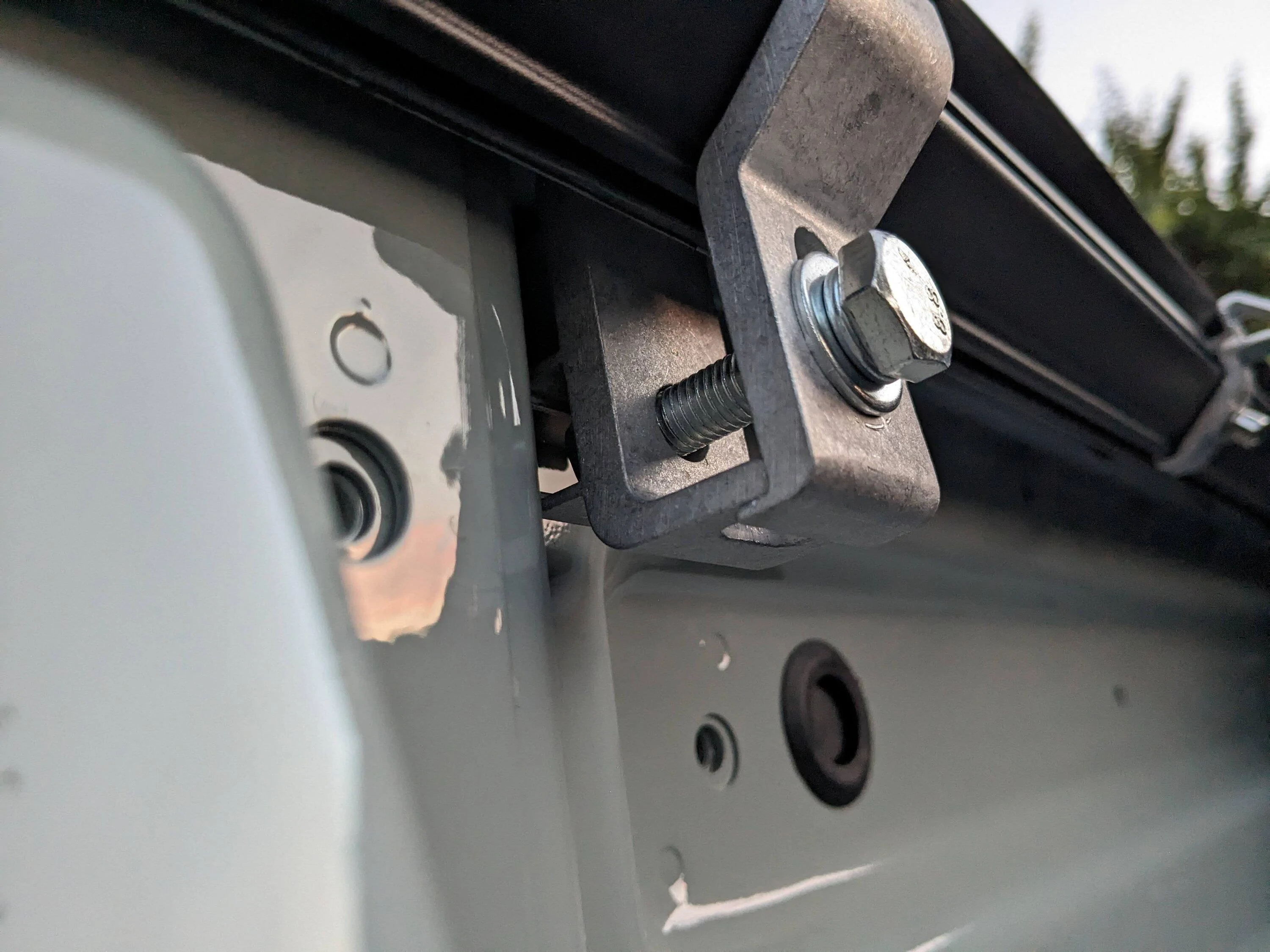

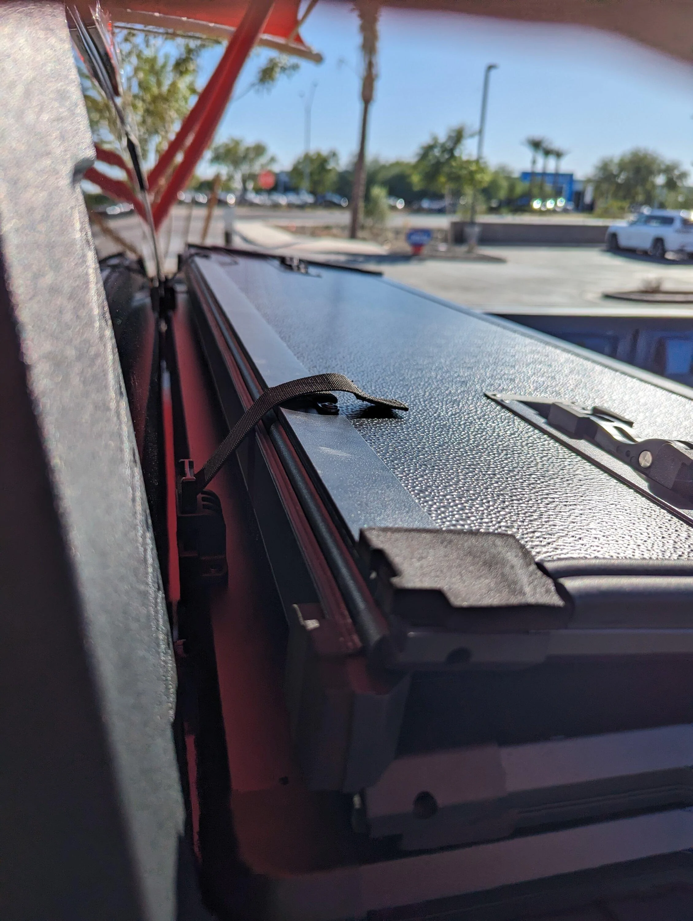

Sorry I took some pics before we went camping last weekend and didn't have time to post them. Also forgot to put a tape on it, but I think these can help. (I haven't bought or installed the TS rails yet - haven't had the need and might pick them up if there's a good holiday sale)

Just installed a Rough Country hard trifold on this morning. Did you end up using the drain tube on your's?
Yeah, if you squint, you can see them in the blurry part of pic 2. I trimmed them a bit since they were so long, and cut into the front grommet to fit them.
A bit of water came in when I washed it, not a ton. Need rain at some point to see how that goes...

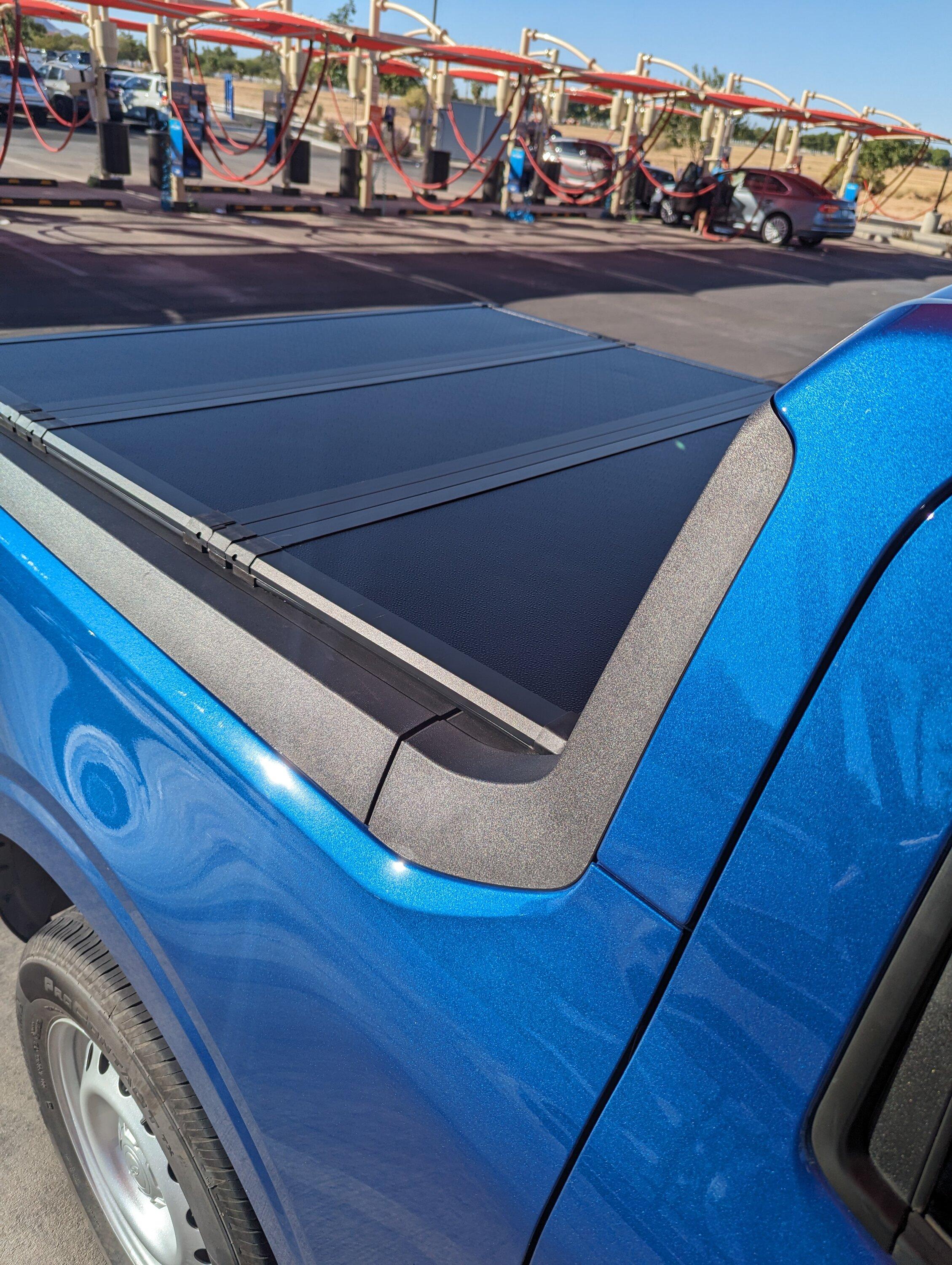

How is this one treating you? Is it easy to remove?
Super easy to remove. Fold it all the way forward and unscrew the front two clips that latch it to the bed. Done. I lift mine off and toss it in the back seat when I need to do this.

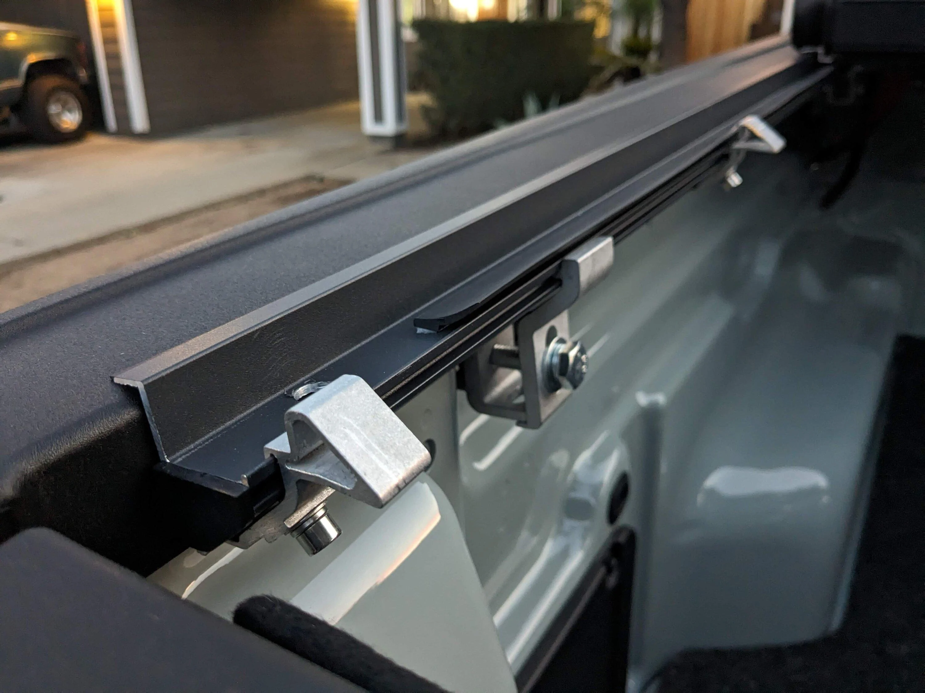

Just curious. On the Amazon covers are you clamping onto the steel rack inside the bed or the plastic truck bed cover? My Yita motor hardcover t-bar bolts aren't long enough to connect to my Lariat inside side steel rack.
