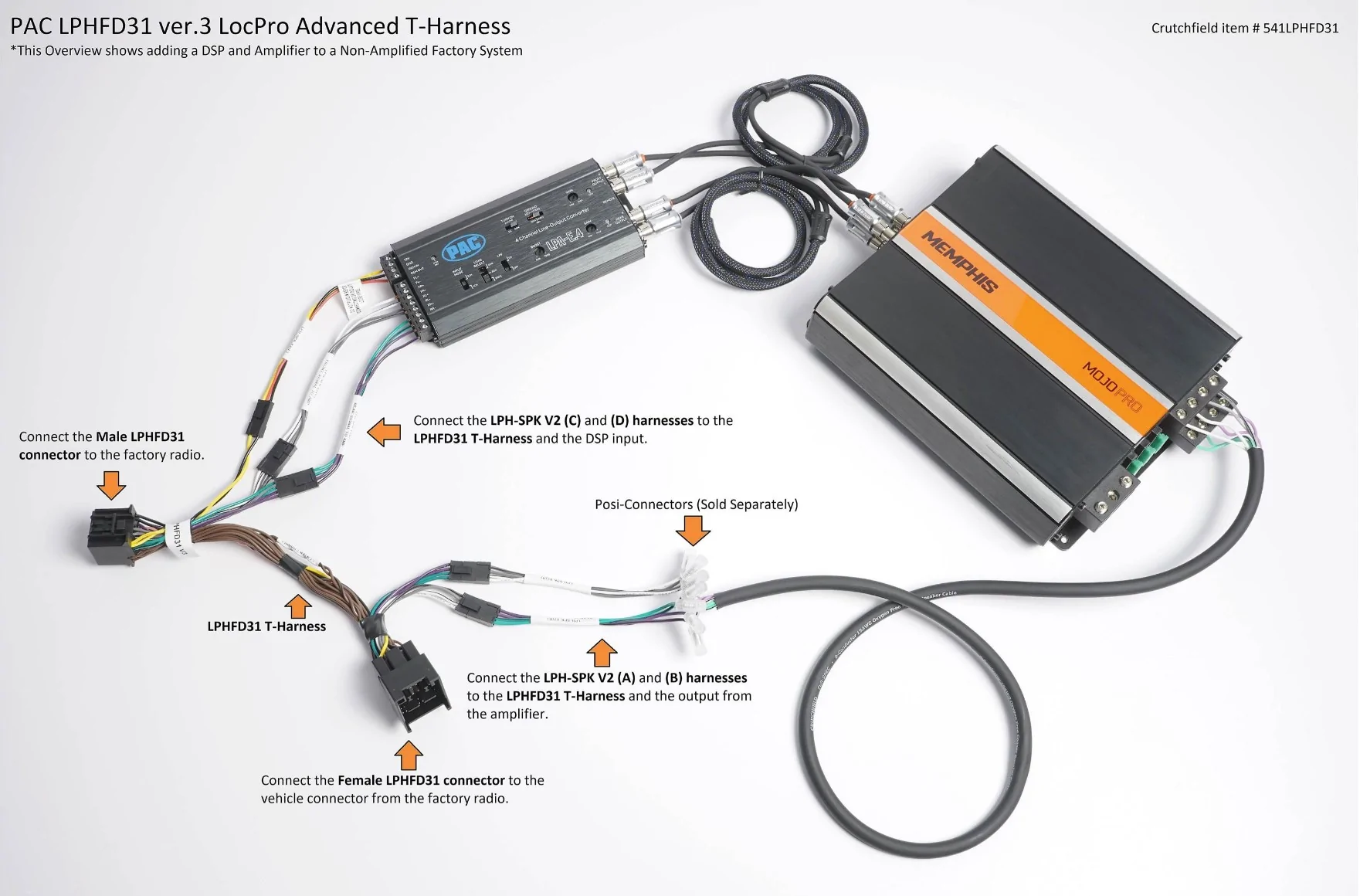

This picture validates my wiring
Ford Maverick White Noise from Speakers after Amp install Wiring
Carlitos_92
Mar 24, 2024
2,346
4,826
Not following. That’s the harness I was hoping you were using 20 posts back, and the one I’m using myself.
What I thought you were actually using, per your posts, is a different custom harness, and that wiring is what I was saying sounded ridiculous.

I was using the plug n play kit, not this one. This kit is how I believe it shoudl be wired. The Kit from Plug N Play has all the Speaker wires connected together and then out to the various inputs and outputs to and from the AMP.

Ok, so I have added the HS10 to my system using the PAC harness. It works exactly like I thought it would. There are no LOCs or other devices needed.
The four head unit speaker signals are going via the PAC to a Key 200.4 behind the glovebox, powering new front components and upgraded rear speakers. The 200.4 has a selectable high-pass crossover built in.
I used the PAC "Sub-T" harness to split off the rear signals before they get to the 200.4, and ran shielded speaker-level cable from that back to the HS10.
If I'm being honest, I don't see what all the fuss about the PnP harnesses is. I basically accomplished the same thing with the PAC harness, maybe $20 of crimp connectors, and a roll of Tesa fleece tape.
