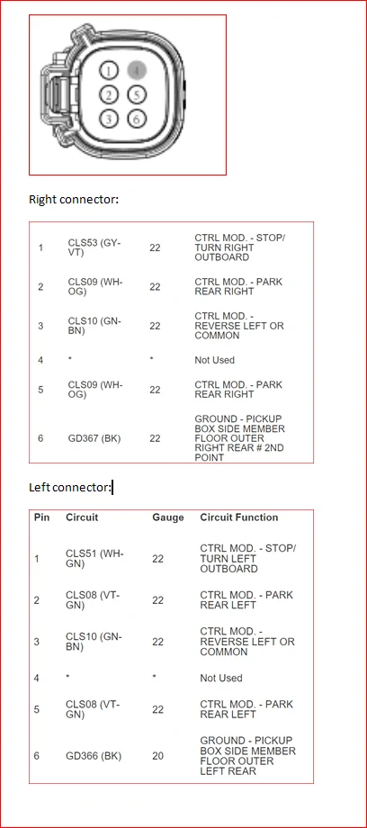

Ron, doesn't this diagram give you the colors you need?
White/Green Left turn
Violet/Green tail lamps (left side)
Gray/Violet Right turn
HRG

HRG, this diagram is for the connector on the truck side instead of the wiring on the tail light itself. Ron
