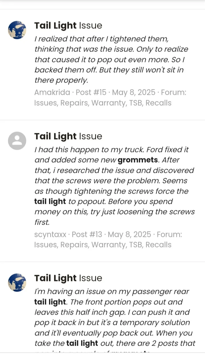

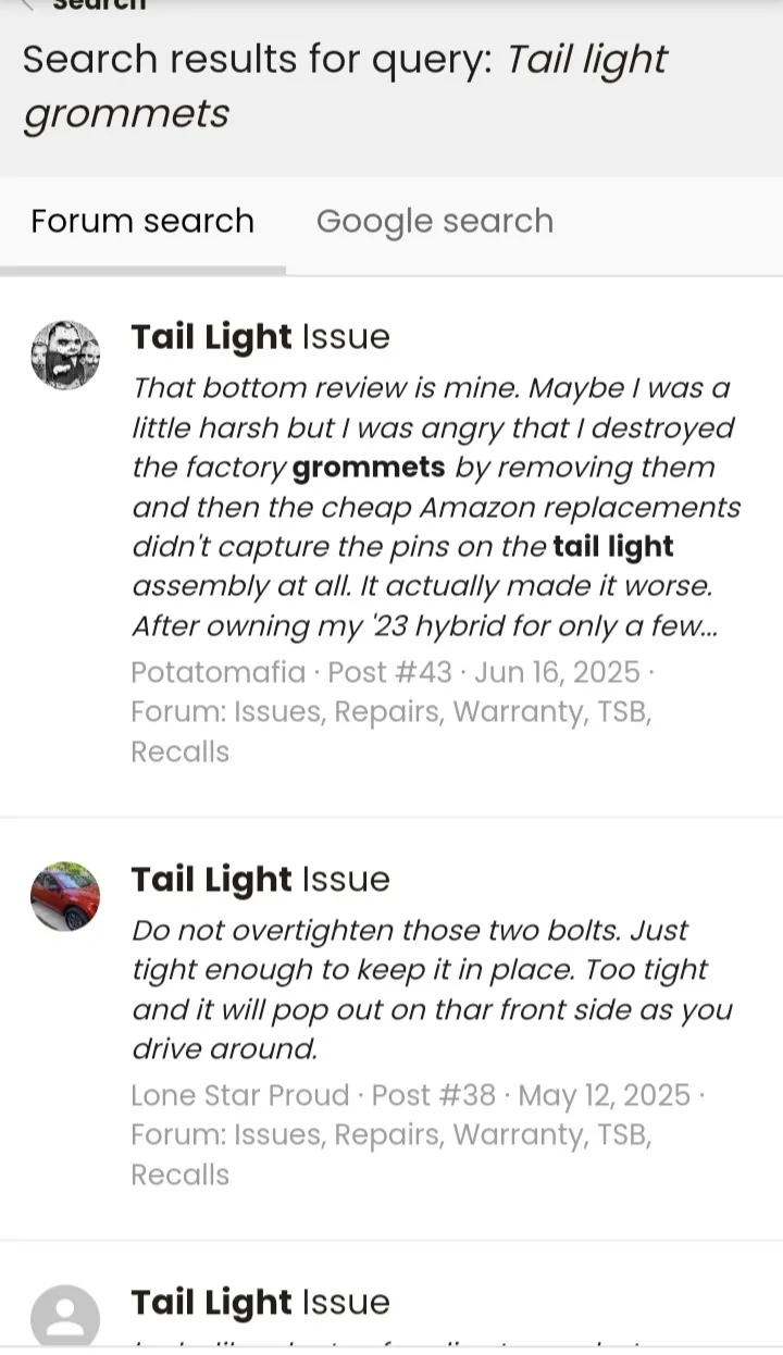

If you input tail light grommets into the search function. This is what you come up with.
Good Luck
Ford Maverick Tailight Removal for LEDs 20251106_065614
Ford Maverick Tailight Removal for LEDs 20251106_065546

So far I haven't had any issues with the light unit itself popping out since I reinstalled. I knew you don't tighten the side screws very tight at all, just snug.
