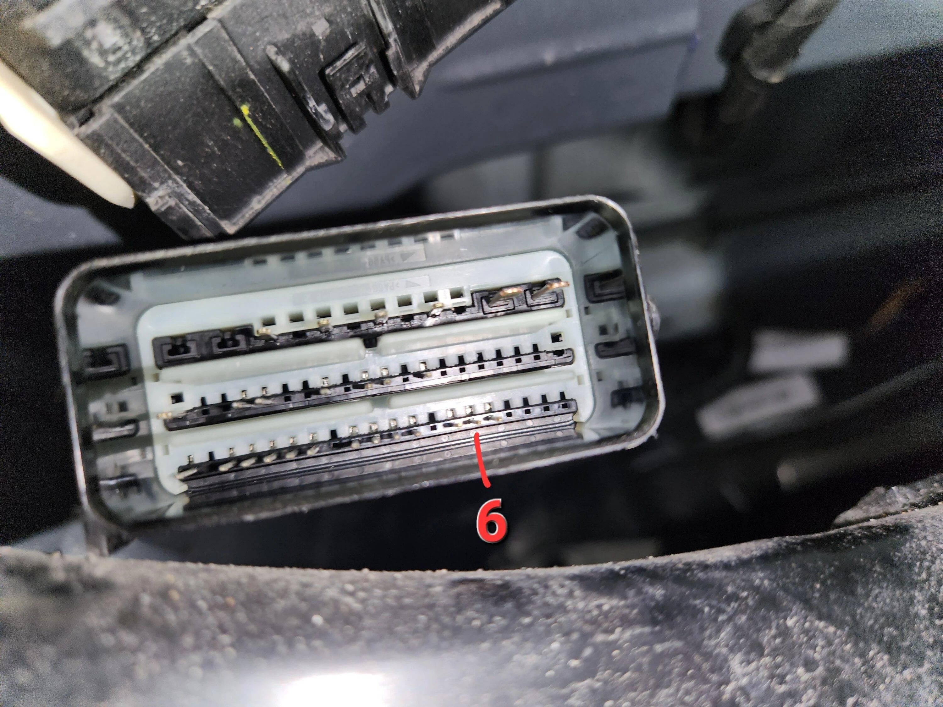

Connector C404 by the muffler, pin 6 carries the power to the bed light.
Tap into this by either adding the female pin on the other side or tap the wire.
Get ground from a chassis screw.

Any idea which color wire coming off the module is pin 6?
