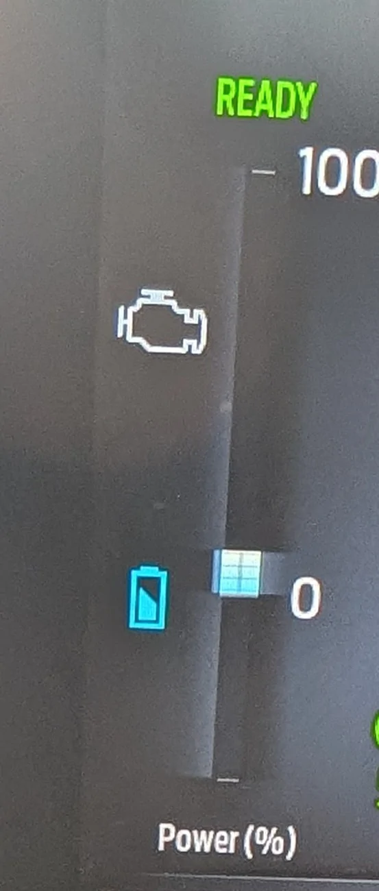

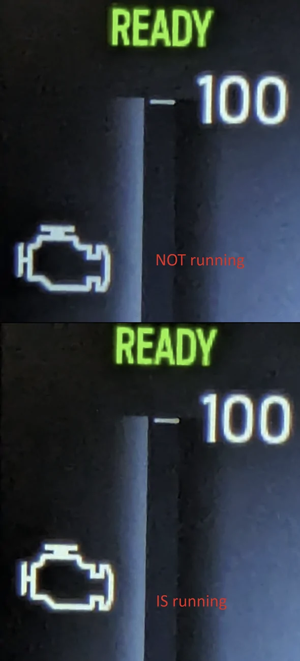

There is also an engine icon that turns from very light gray (engine off) to slightly brighter light gray (engine on) that indicates that the ICE is actively running. No I'm not joking, it is ludicrously subtle.

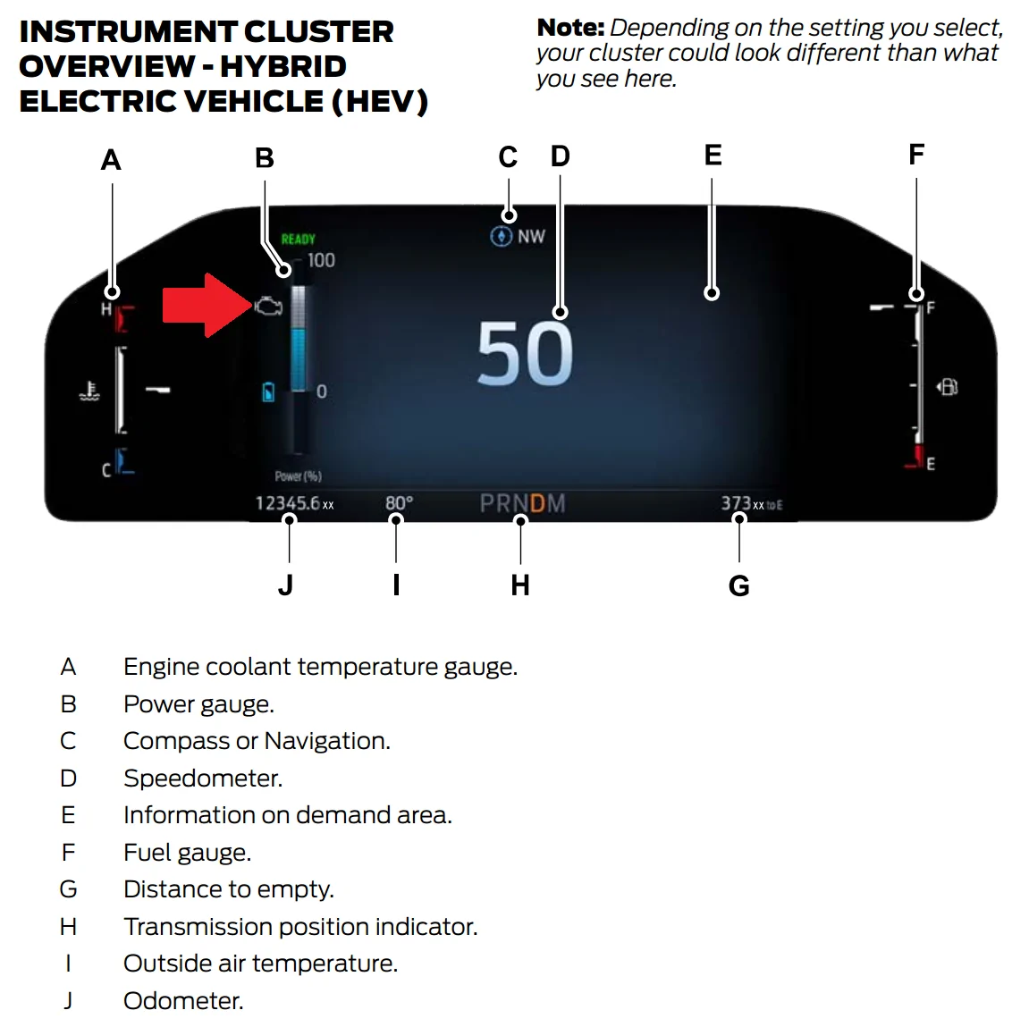

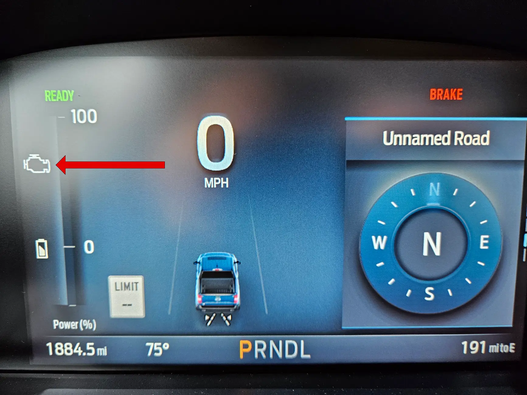

The "power gauge" in the instrument cluster has a little engine icon. It is, in my opinion, a rather poorly designed indicator. That is not actually my true opinion but I am being as polite as I can be so as to at least try and appear to be a well-mannered person.
If I could, I would rub the collective noses of whatever committee that designed and approved this indicator in it while repeatedly saying "no!, bad design, bad".

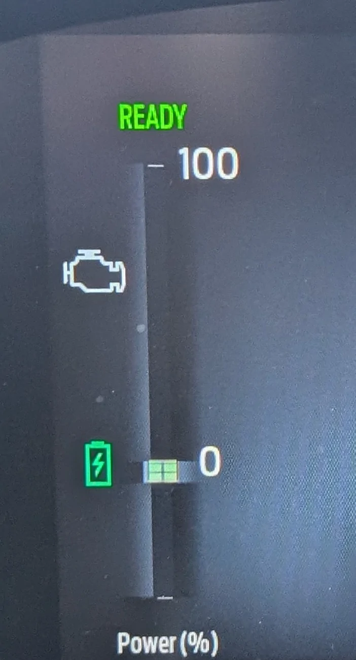

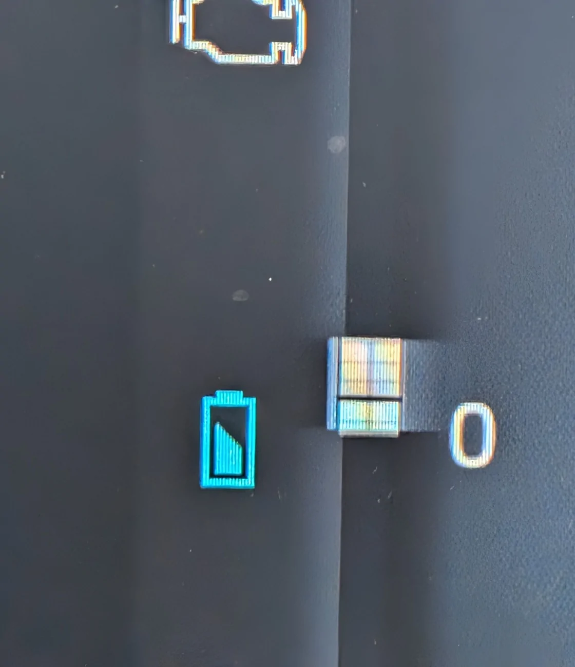

Image 1 below has a red arrow pointing towards it's location. It looks like a check engine light. It's not. The check engine light illuminates yellow (you will see it on the right side when the vehicle does it's power on self test, e.g., image 2).
The power gauge ICE activity indicator is, however, the exact same shape glyph as the check engine light. This is Bad Interface Design Point Number One.

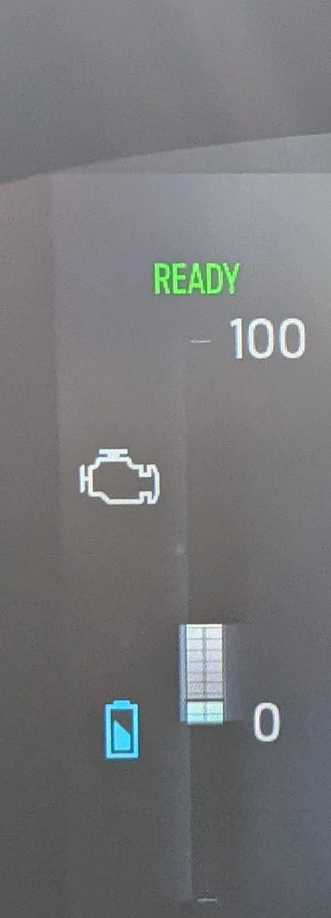

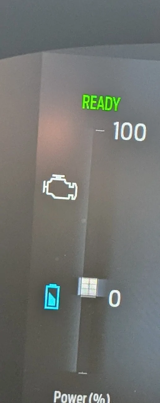

- If the ICE is *not* running, it icon outline is grey in color (image 3, top).
- If the ICE *is* running, the outline is white in color (image 3, bottom).
If you are a normal human being and do silly things like, say, wear sunglasses or drive in daylight or when the sun is down and the moon is out (or not out) it's dang near impossible to tell if the icon is outlined in grey or white without actually staring at it for more than a few tenths of a second which is Bad Interface Design Point Number Two because it takes your focus off of the road.
Of course using the EV Coach mode display lets you know when you are in electric or hybrid mode, but - what if you don't want to use that?
