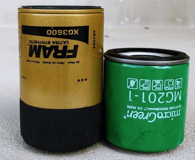

Changed my VERY early. It was easy, compared to just about any car I've ever done. I didn't even use a jack or ramps, just crawled under (on top of a piece of cardboard!).
Switched to a Goldplug AP-04 neodymium magnet drain plug to catch iron particles, and an over-sized oil filter (Fram Ultra XG3600). Turns out, at least on the Hybrid, there's plenty of room for the longer oil filter. I put an XG3600 on a C-Max Hybrid a while back and I had to "stretch" the fibrous splash guard a bit to get it to fit, which is not ideal. No such issue on the Maverick Hybrid. I don't know if the Ecoboost Mav engine has room for the bigger filter; probably does I'd guess.
--- The factory oil filter was super-short. Not even as big as a Motorcraft FL910S off-the-shelf OEM one you might get.
--- The picture below shows the height comparison (Shaquille O'neal vs. Danny Devito) between an XG3600 (4.9") and an oil filter the same size as an FL910S (3.4").
Not pictured, the factory oil filter was even tinier, probably about 2.9". (The green oil filter below is the same size as the FL910S, 3.4".)
--- An XG3600 has the best 4548-12 filtering test results of any I've ever seen, and will last much longer than a FL910S or about anything else you can put on there.
