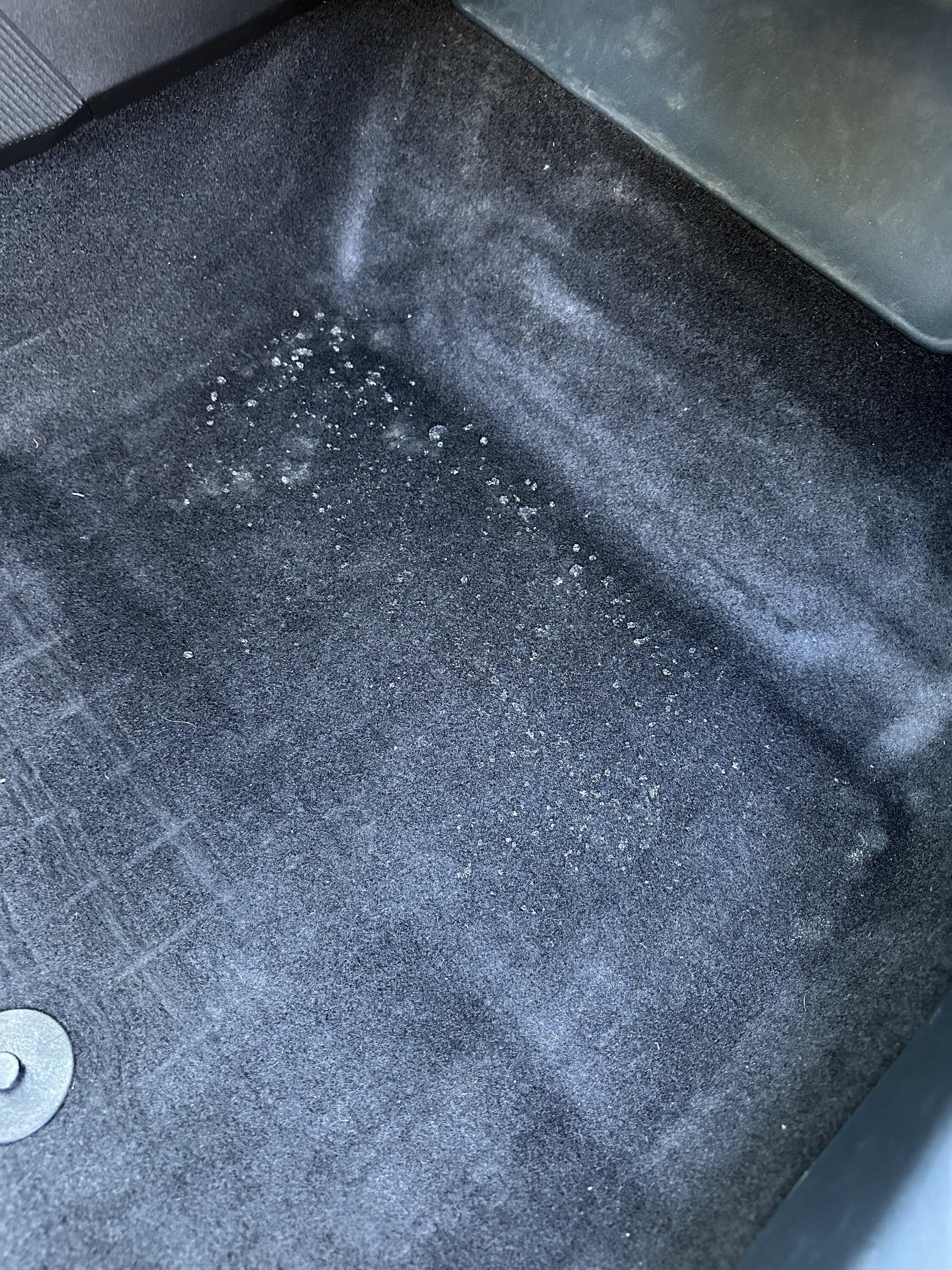

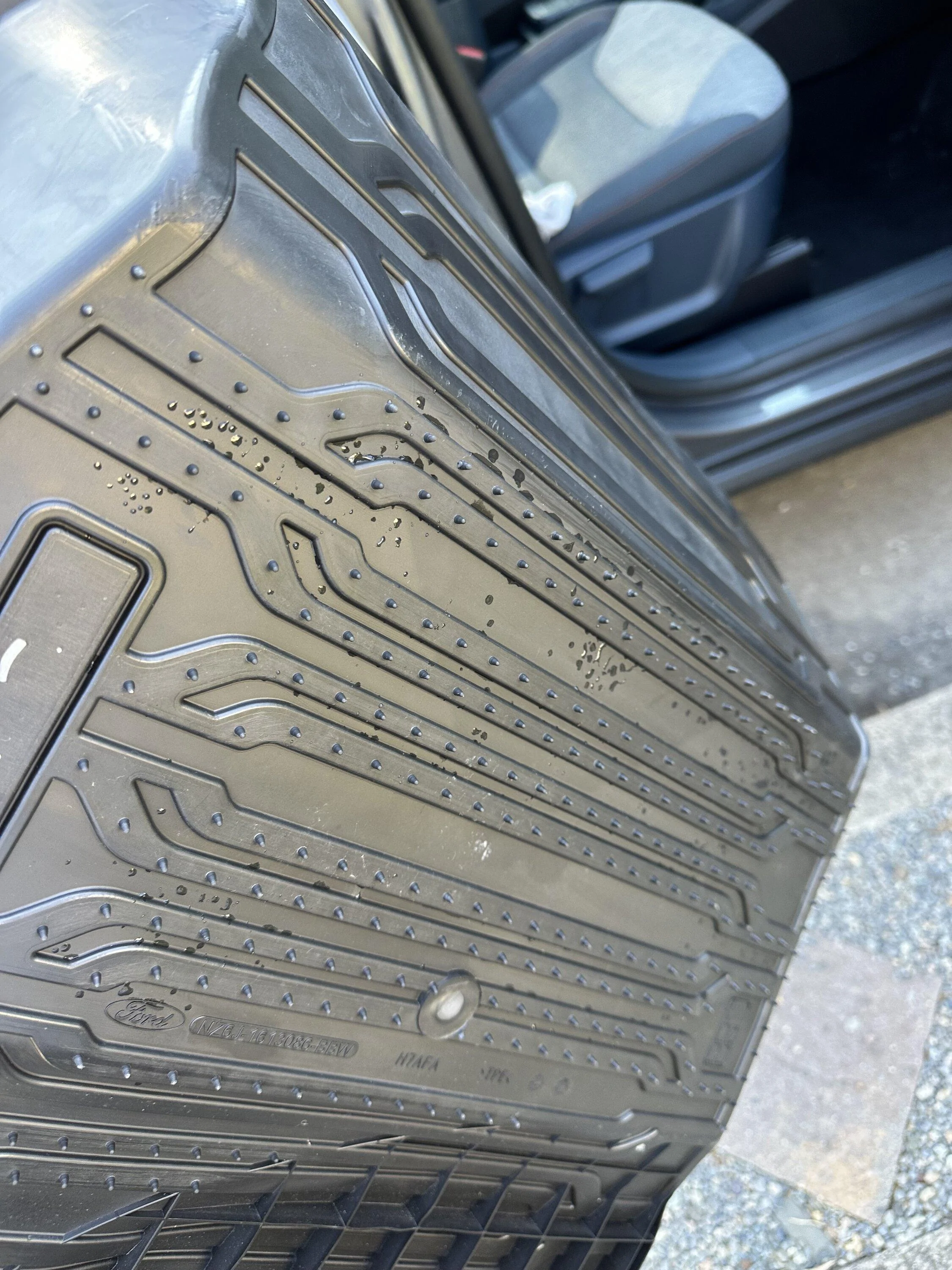

Hi there – send a message to us with your VIN and approximate mileage, I’ll look into this for you. Thanks!
I similarly have water accumulating on the passenger side floorboard. I’ve reached out to my dealership but haven’t heard anything. I’d appreciate your help.
