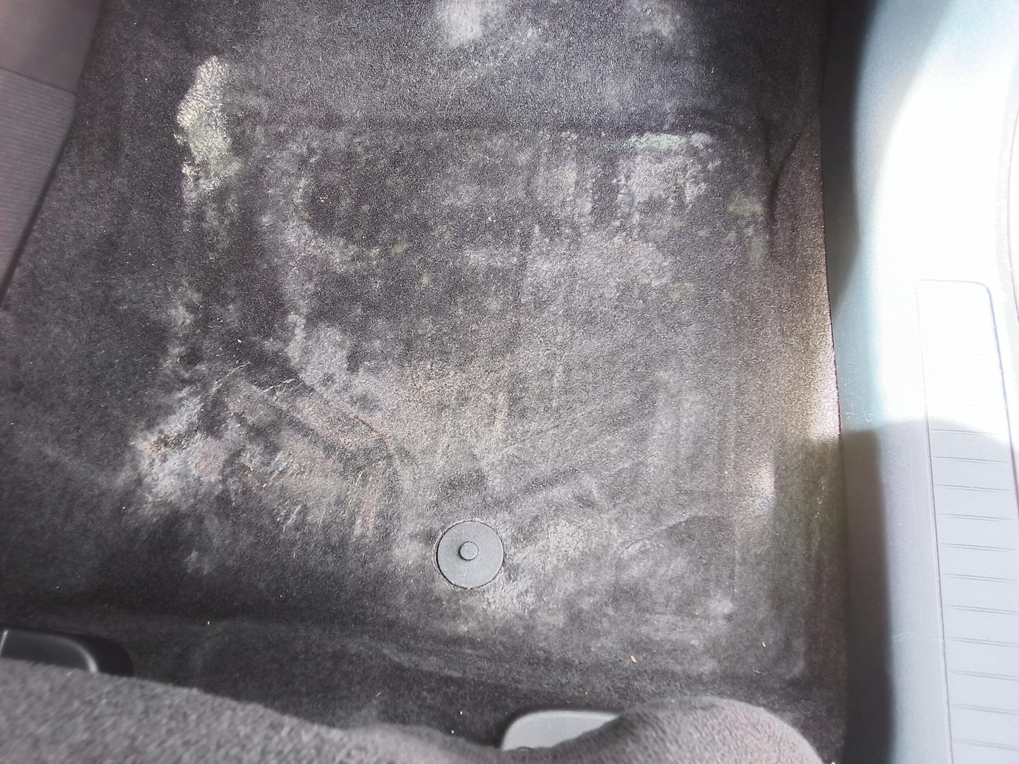

Every once in a while I'd see a drip of water on the mat on the front passenger side floor. This has always happened driving through rain. I bought new mats and when I removed the old Matt (which was a plastic formed mat) the carpet was soaked and full of mold. I called the dealer so its going in Monday. Has anybody encountered this problem, and if so what
Ford Maverick Leak on passenger side front floor. Any ideas? 17148415876254065912575376993364
was wrong and how did they fix it. I did run water in the windshield area but no leak. I think it happens when I go through large puddles. I mentioned to the dealer it should be covered under warranty and she said if they can't find the problem I'll be charged $200.00.

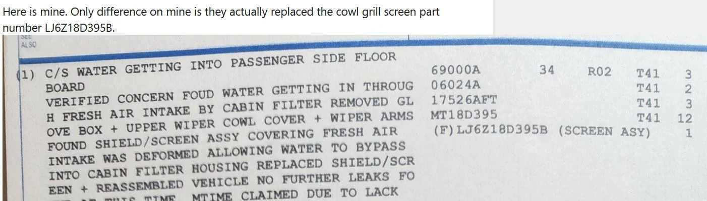

Well, it was the COWL. Thanks everyone! When I took it in I told the dealership what people said on this site. They put a new one in with silicone sealant. Now the carpet which needs replaced is on back order but that's ok. Thanks everyone for your feedback....
