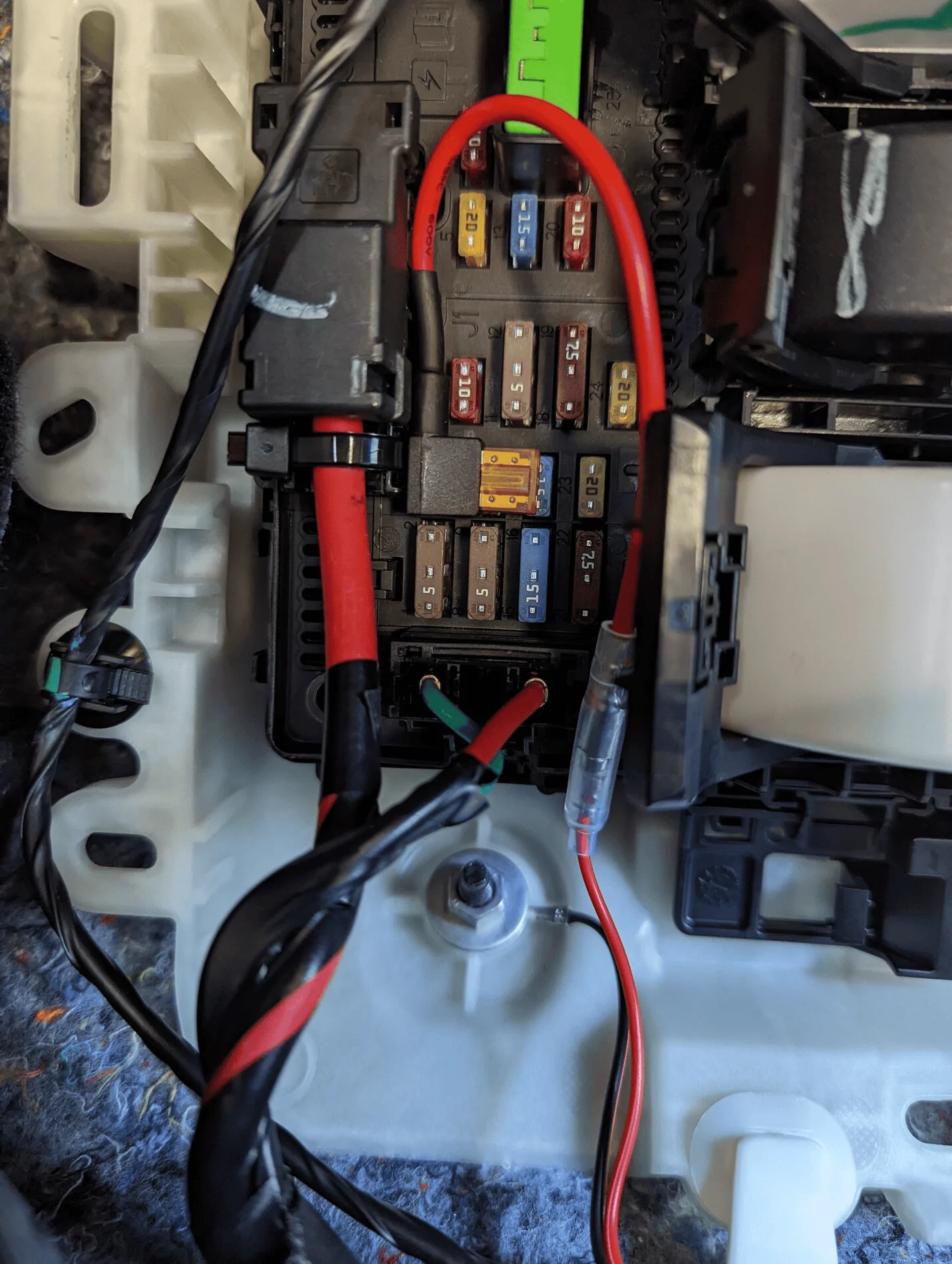

The inside fuse box looks like this with a "fuse-tap" added. We'll probably be seeing a lot more guides and how-tos in the next few months as owners start doing all kinds of mods. I'm planning on doing my dashcam hardwiring this weekend if all my parts come in.

Great photo. Nice and clear. I'm going to assume this is under the dash?
Hard wire is a must if one wants to use the parking monitor feature and I highly recommend using it for a new vehicle.

It's in the front passenger side foot area, there's a plastic cover the easily pops off. I had to just kneel down outside with the passenger door open and lean to the foot area when I was doing some testing in the fuse box. Not terribly uncomfortable but maybe get a knee pad or foam or something if you'll be messing around with it for a while. My driveway concrete didn't feel too comfortable after a while.
