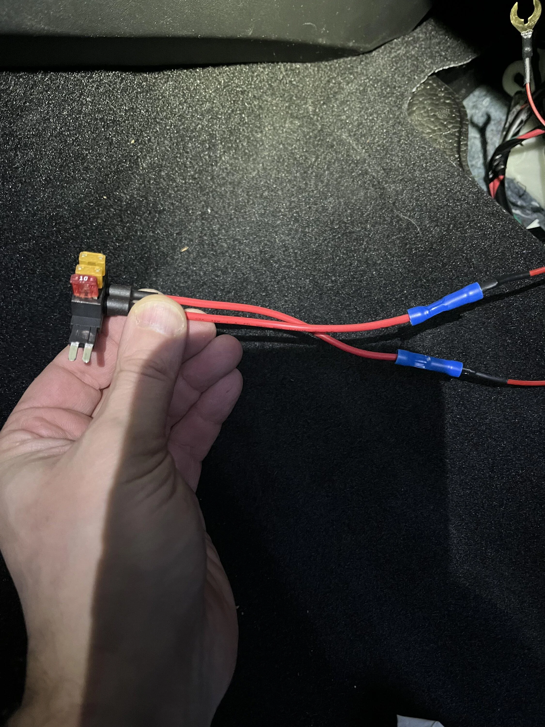

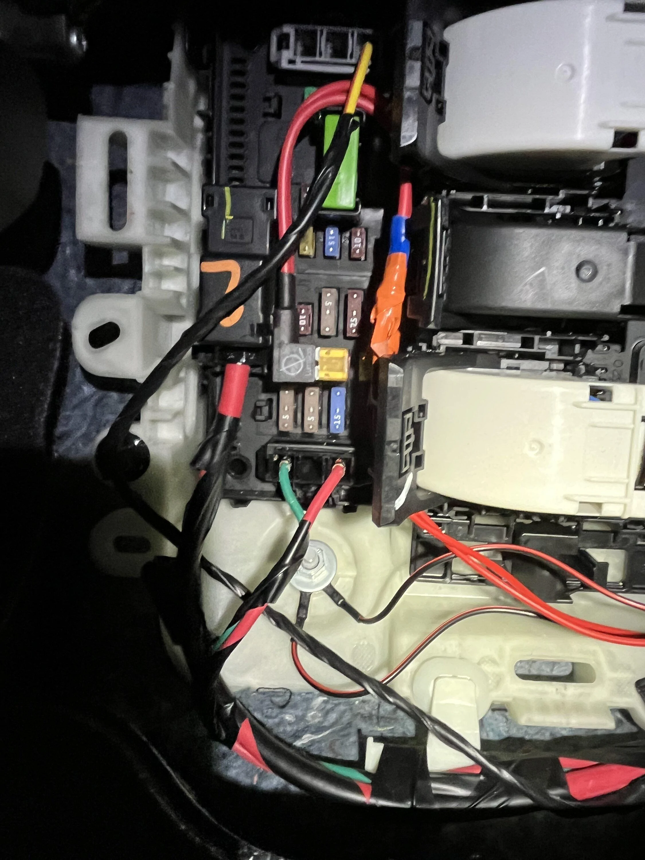

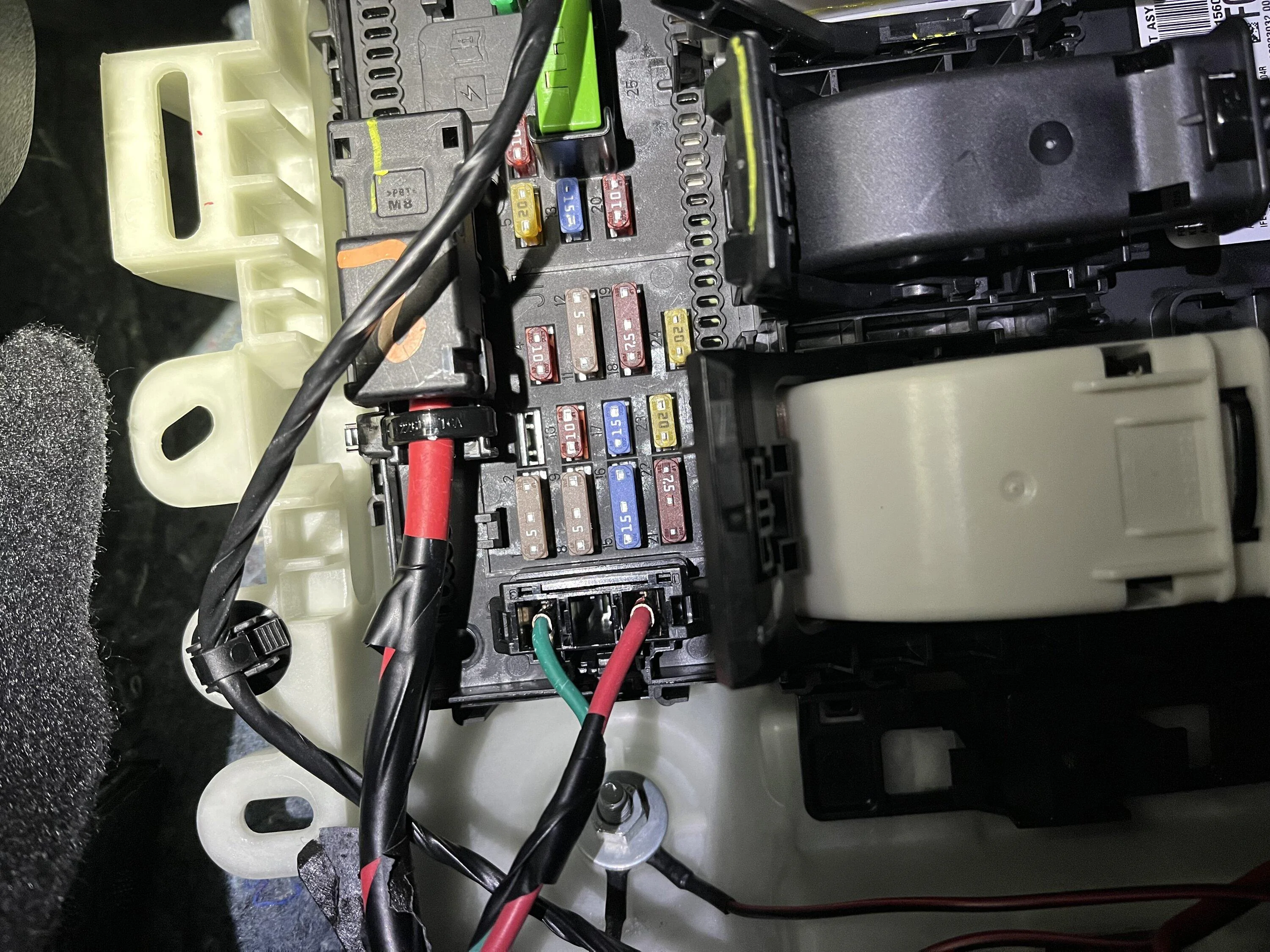

Happy to report it is possible to connect two dash cams to a single ignition only fuse with the use of a double fuse tap.
I used fuse #3 and this is what made it all possible:
https://www.amazon.com/dp/B07919WK9N?psc=1&ref=ppx_yo2ov_dt_b_product_details

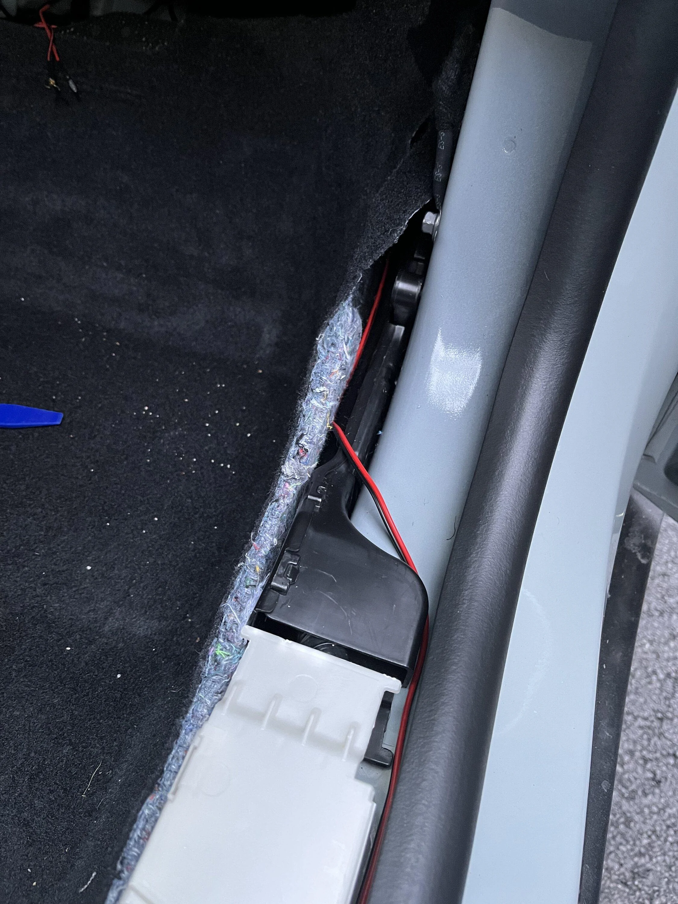

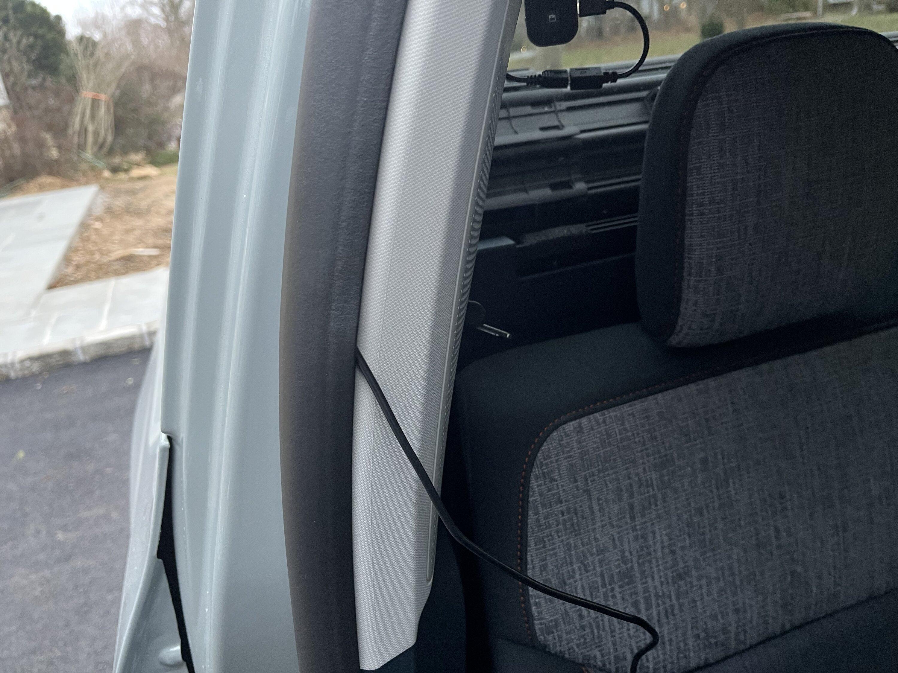

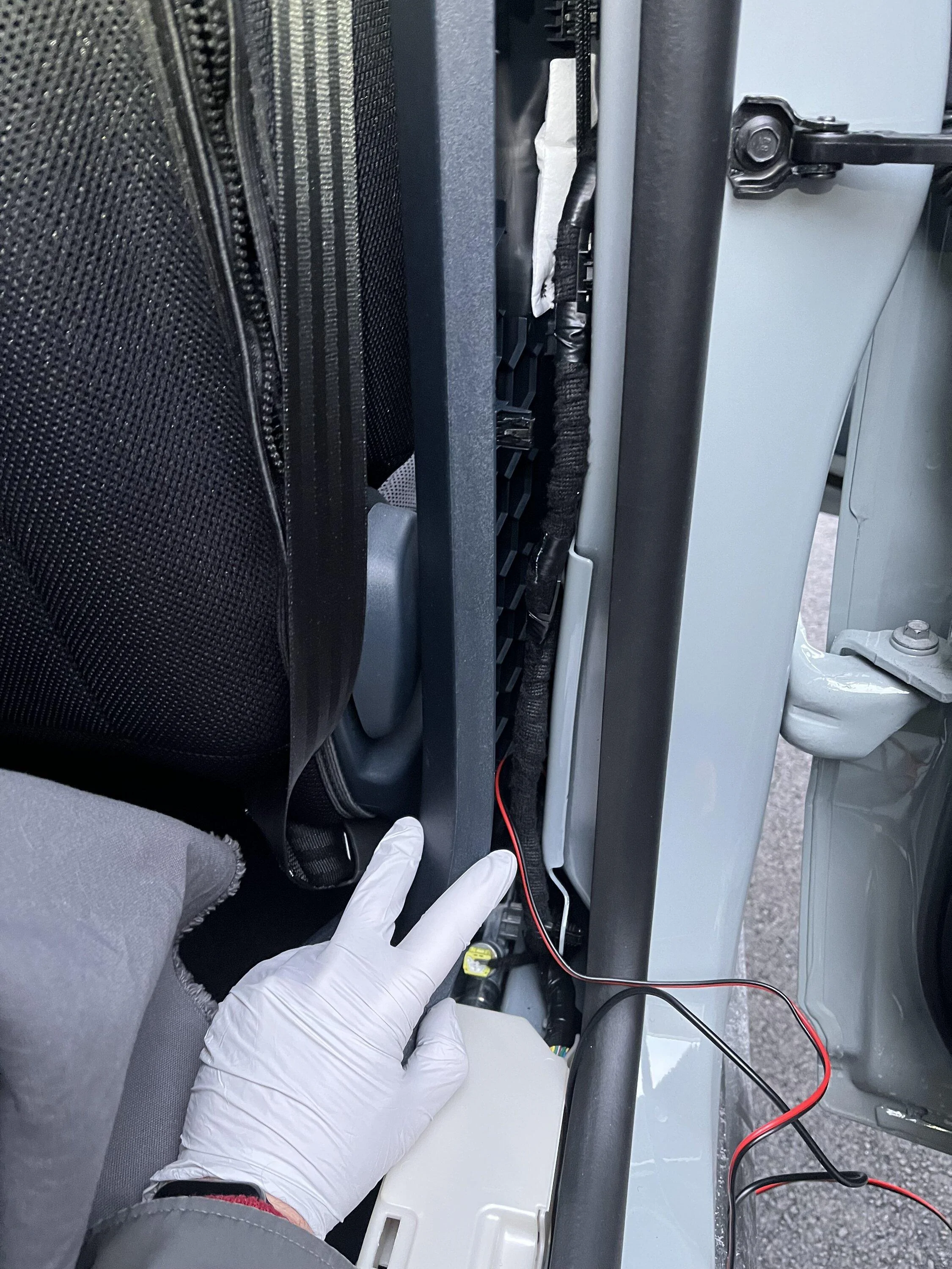

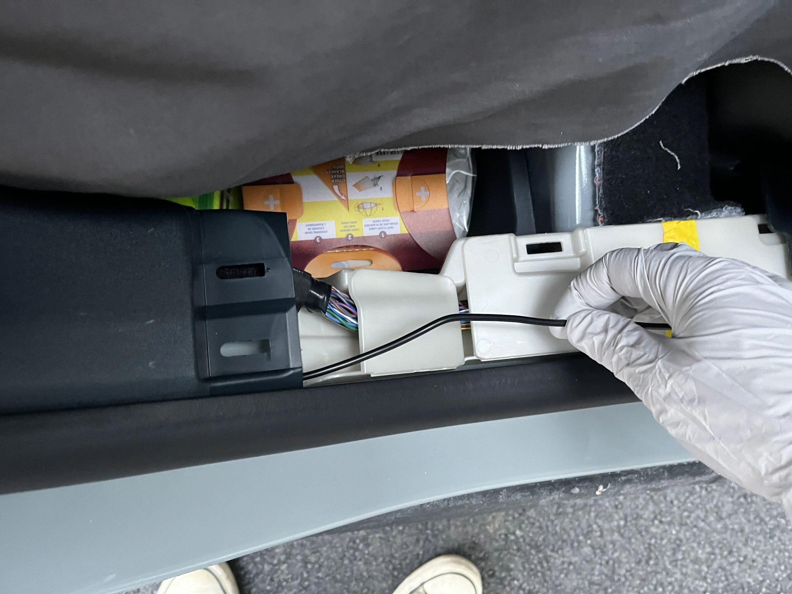

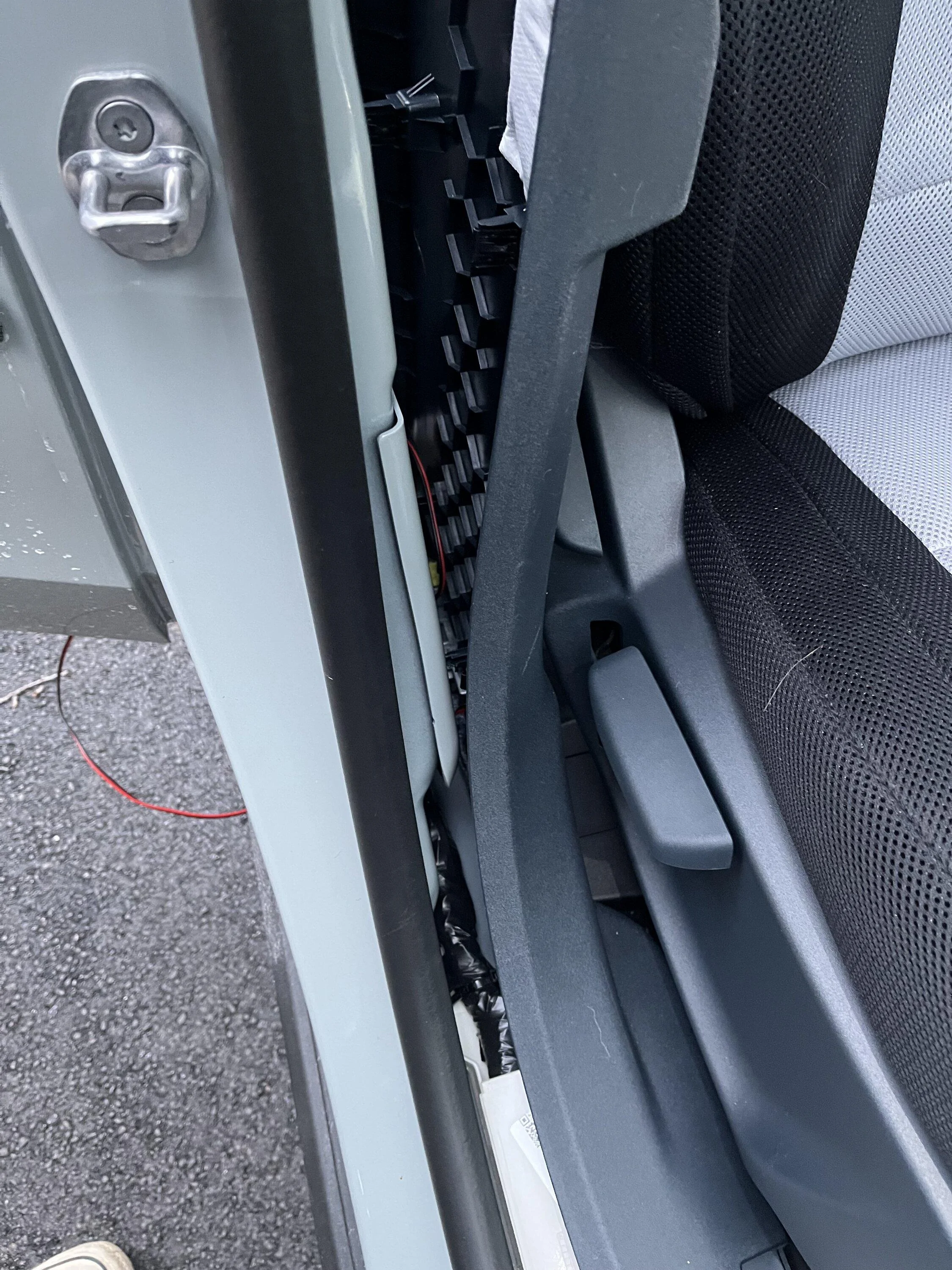

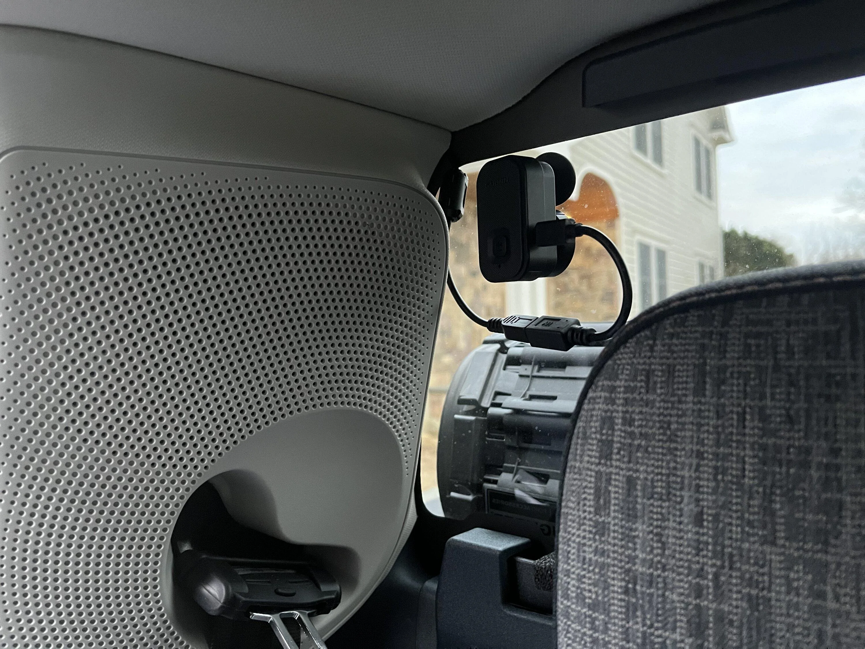

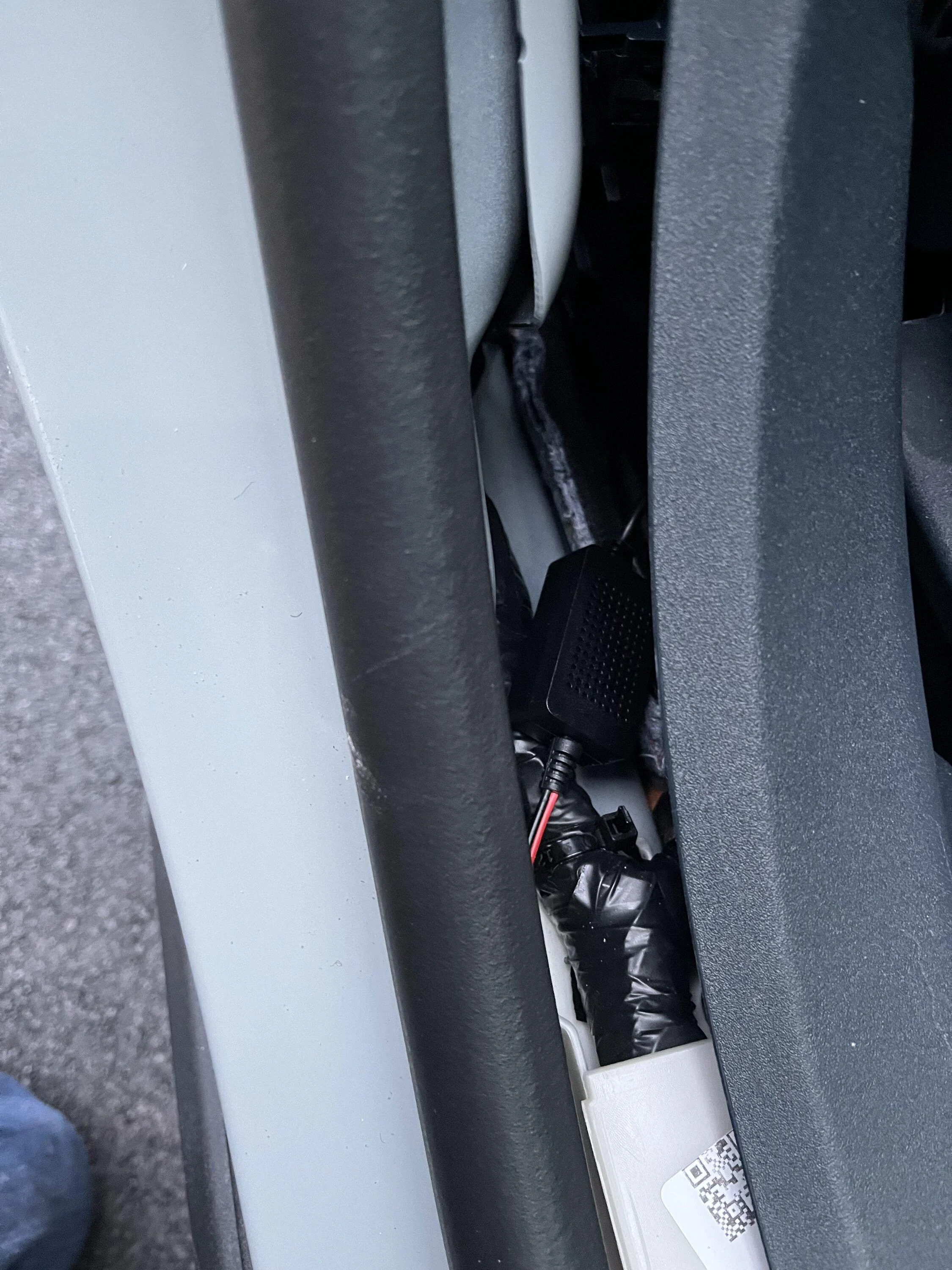

I've attached pics of the rear install.
