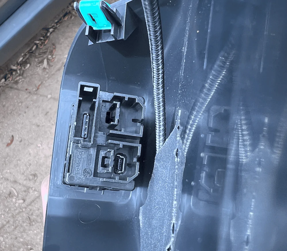

Here is the back of the USB media connector for reference (USB-C is the 4 pin on the left, USB-A is the USB mini B port on the right.:

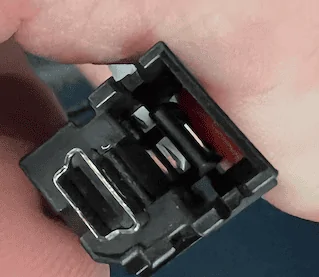

USB-A port harness:

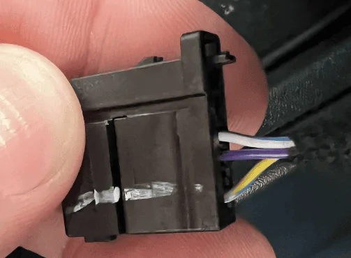

USB-C port harness:

From a quick glance at the 'Service Manual' that seems to be the case.
The mini-B port goes to the ACM (non-SYNC) or APIM (Sync 3). One of the tests for checking if the front ports is operational for data is plugging in a USB-A to mini-USB adapter.
The 4 pin connector seems to be used for supplemental power to the media port as service data says to check the connector for 11+V. In addition to providing the necessary power for the LED surrounding the media hub.
