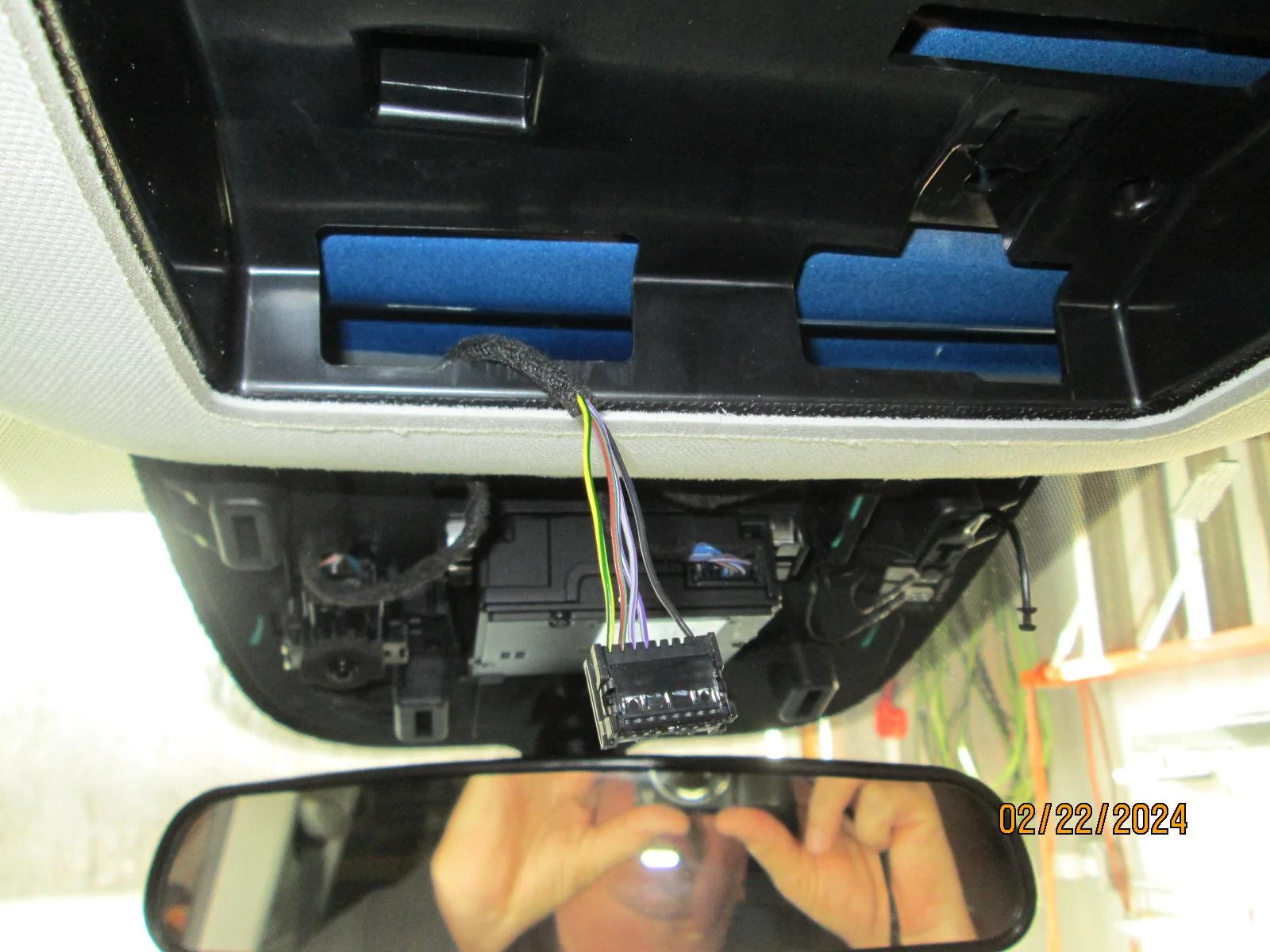

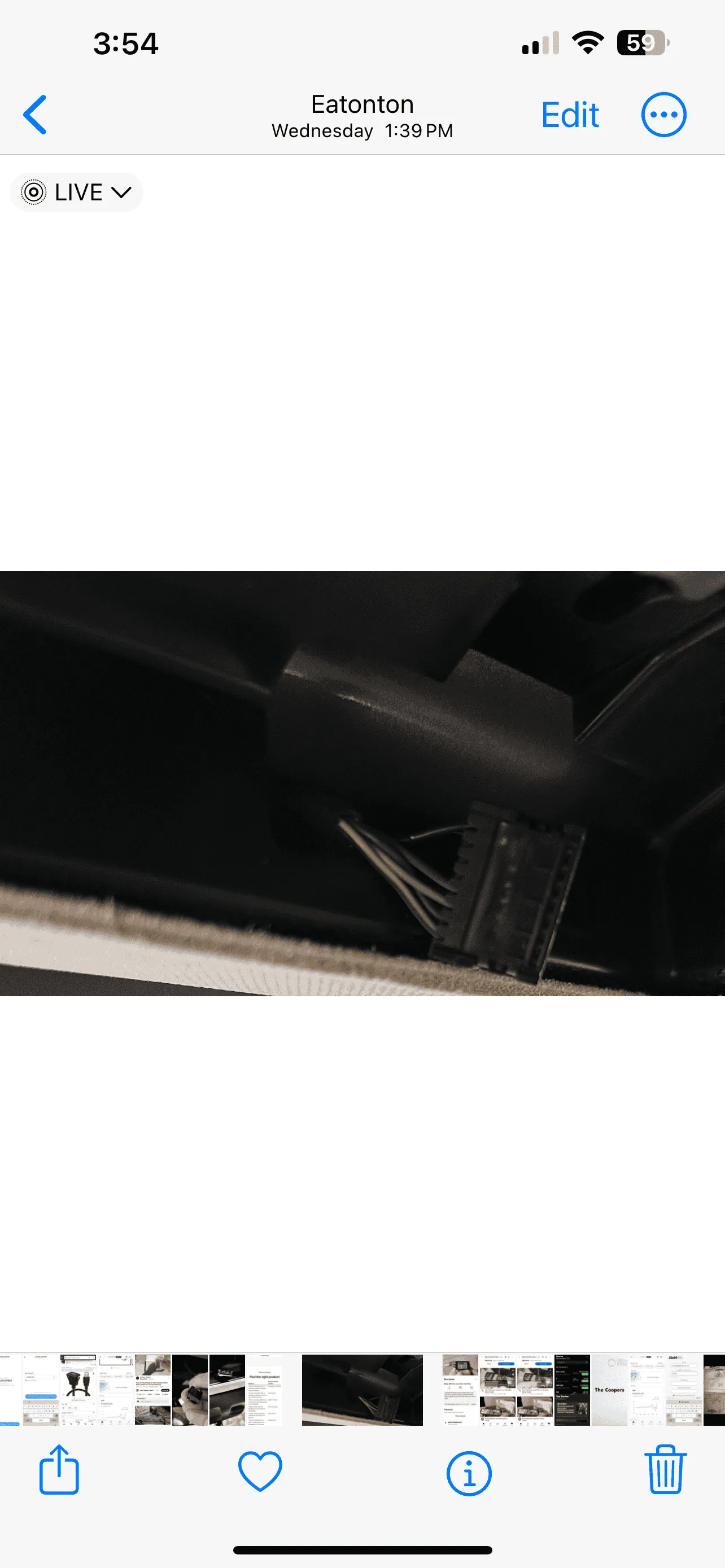

This is the plug that goes to the housing with the lights and sunglass holder.
Just tapped into the switched 12 volts…black and purple in my case.
Is it safe to assume, black to black and red to purple? Thanks.
FWIW, these are extremely small gauge wires, like 26-28awg. Here is a view with about another inch of the insulating tape stripped off.
