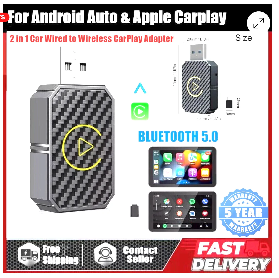

In my case, it was the adapter. That's not good news for others with the same problem, but it solves it for me. I'll just use USB C thumb drives from now on (I use a wireless adapter in the A port to connect my phone data). It's the little A to C adapter that came with it I was using, and it failed after 6 months. I can probably just pry up the pins inside, one looks like it seated low. But I'll probably just use C thumb drives from now on.
My wireless adapter:
