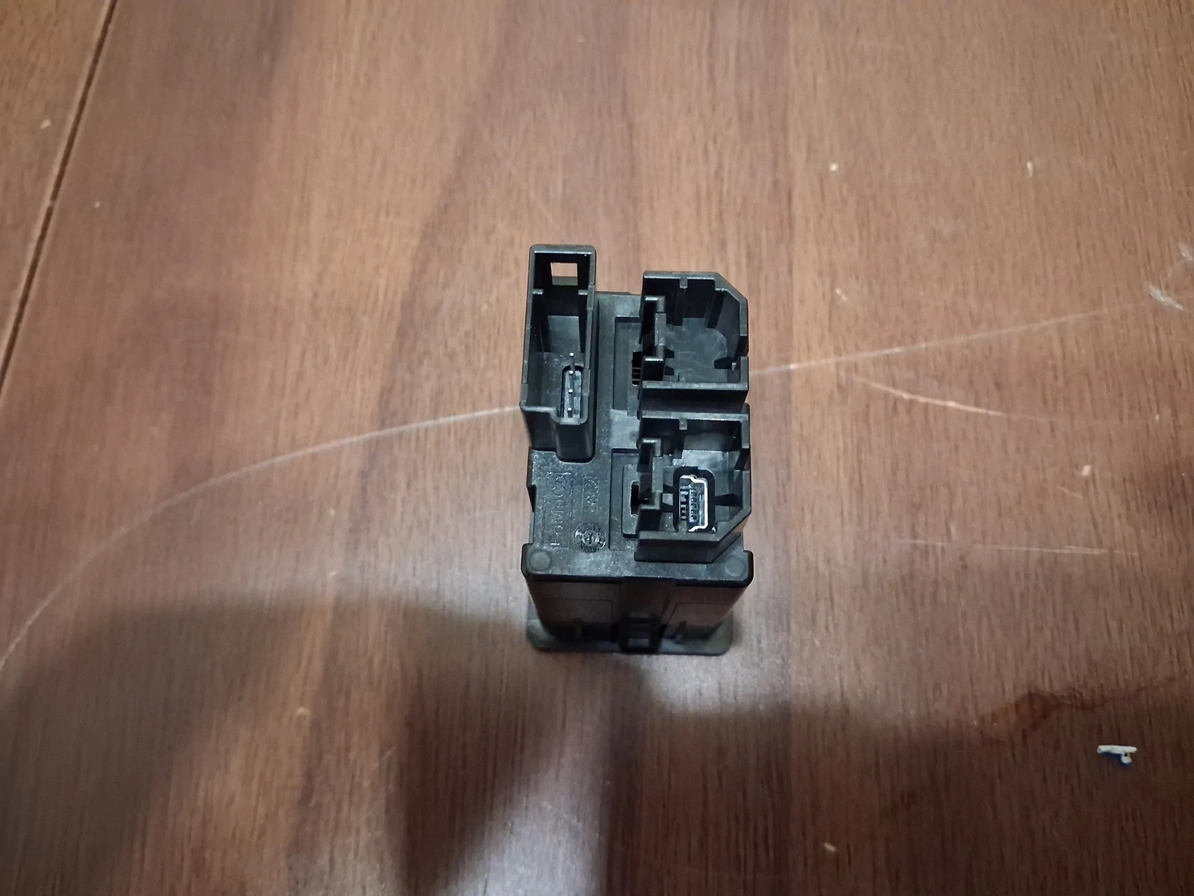

Just brought home my Lobo a few weeks ago and am having so much fun finding tweaks and things to “upgrade” what it didn’t come with.
One of them being the USB Port that lights up around the plugs. I’m kinda butthurt about it!
Does anyone have the Ford Part number for one? All it takes is a small straight blade screwdriver on both sides to pop it out. Again - only looking for the part number for the lit USB port.

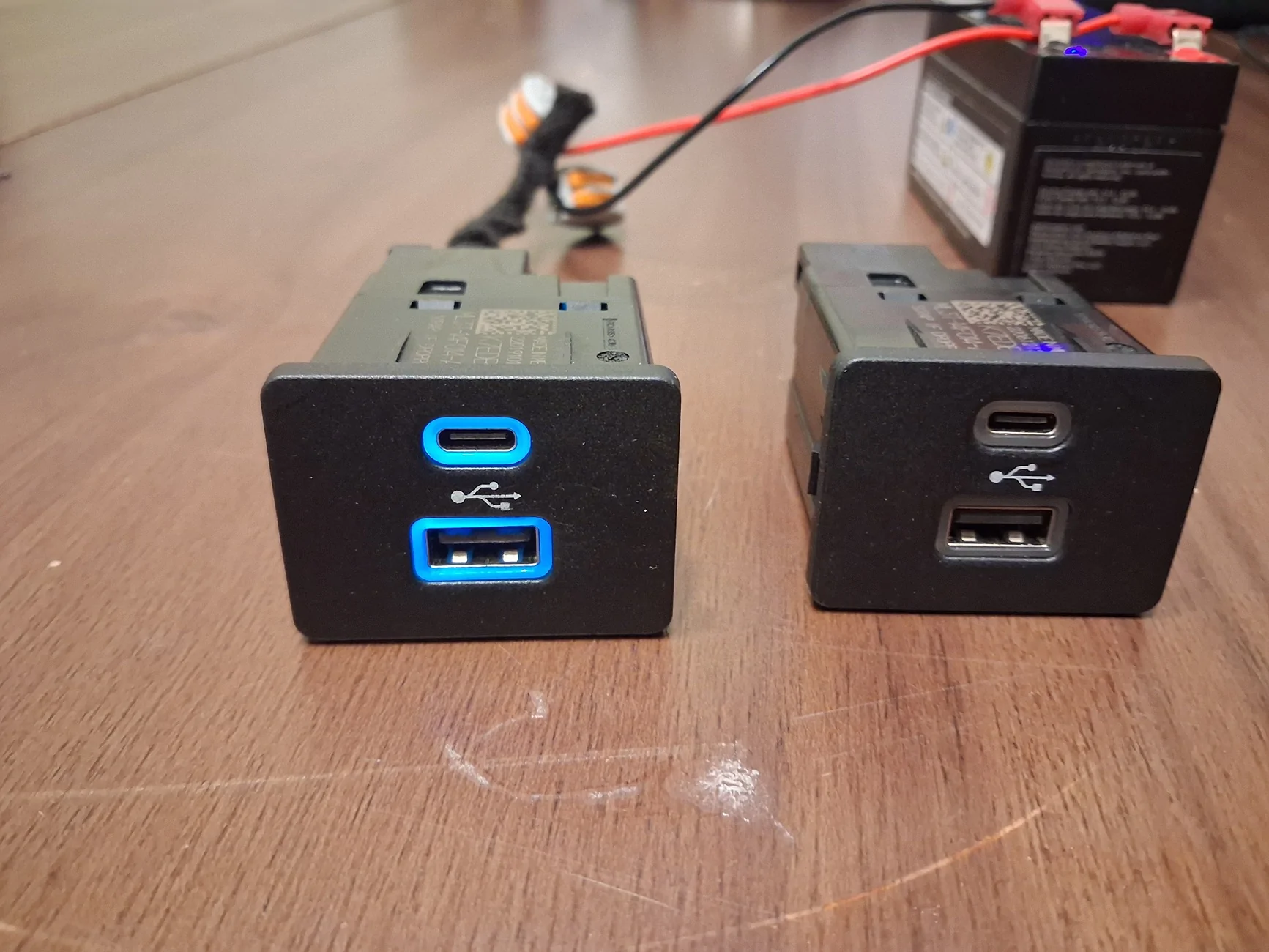

I don't think there's any difference in this adapter between Sync 3 and 4, other than the LED.
BUT, I'm really annoyed that I can't see the plug in the dark space.

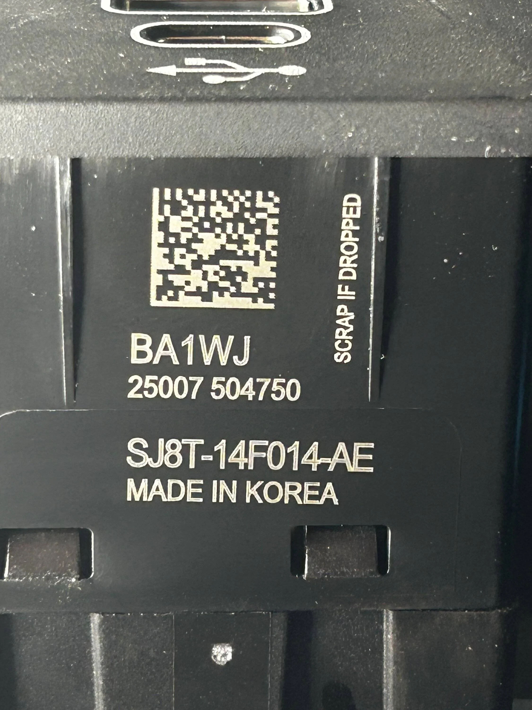

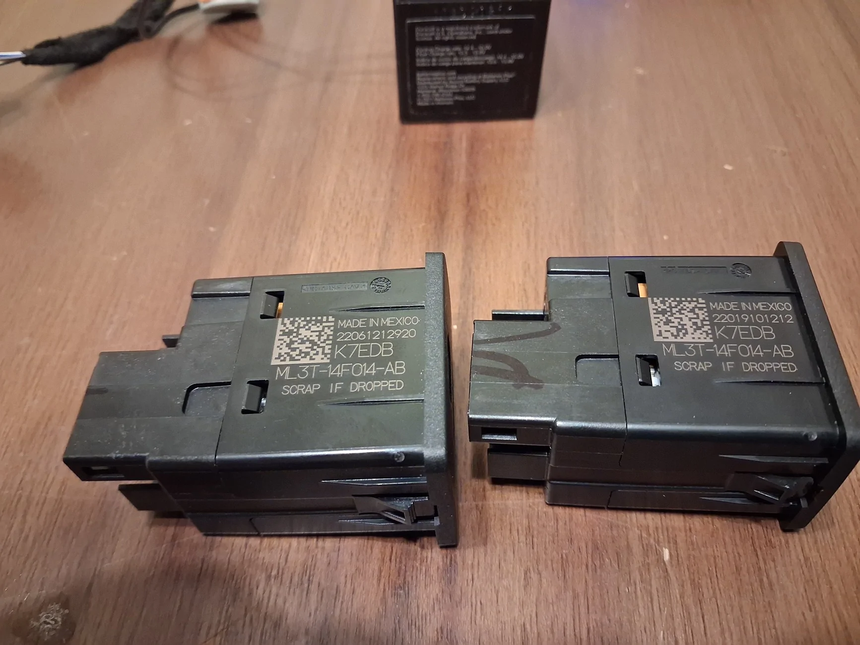

The 2024 adapter is ML3Z-19A387 aka ML3T-14F014.
They look identical to the 2025, except for the LED surround.

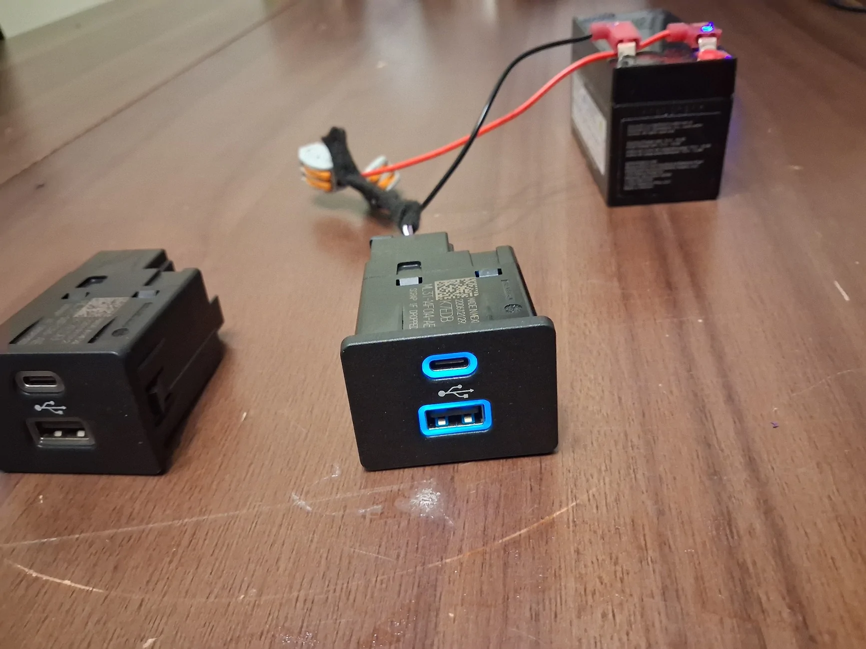

My understanding is that there are two plugs in the back, a USB mini and a 4 pin, and that the 2025 4 pin harness is missing a gray/white wire for power for the LED ambient light surrounding the USB ports.
I'm on the same hunt right now. If it's true about the lack of power, then maybe splice in a power supply wire from the ambient lighting in the foot-well?

I have two from a '22 non-sync Maverick. I don't think it matters. A USB data line is a USB data line. The part number is obsolete. If you search it on Ford.Parts the newer number will return.
DM me if you are interested. $50 shipped.
I ended up with them when buying used trim parts on eBay. Sellers just leave stuff connected without probably knowing a new hub sells for $150 lol.

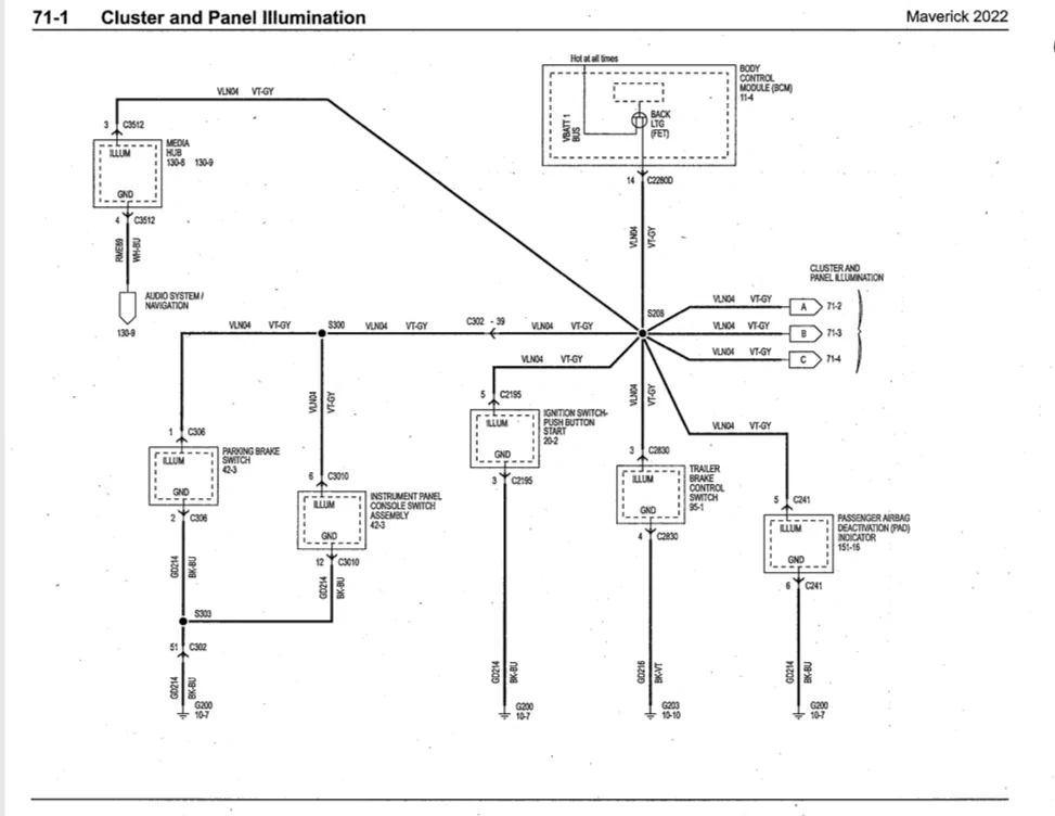

Ok, found what I was looking for...
Cluster and panel illumination all comes from the same hub and they're all wired Violet/Gray from the BCM, VLN04.
On the 2025 and later models, its connector only has 2 wires, nothing for illumination, but it's real easy to tap into any of the other Violet/Gray wires that are sitting right there, including the push button start connector.
This is from a 2022 Maverick, showing connector C3512 has/had the illumination circuit in pin #3.
