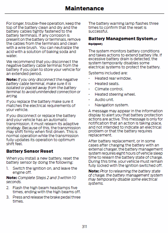

Was having the same issues with the overhead lights. Even the turn signals were not audible! I used a trickle charger for a few days and everything came back.
Another thing you can try is the Battery Sensor Reset shown on page 311 in owners manual.

Not sure if it will work but worth a shot, let us know.

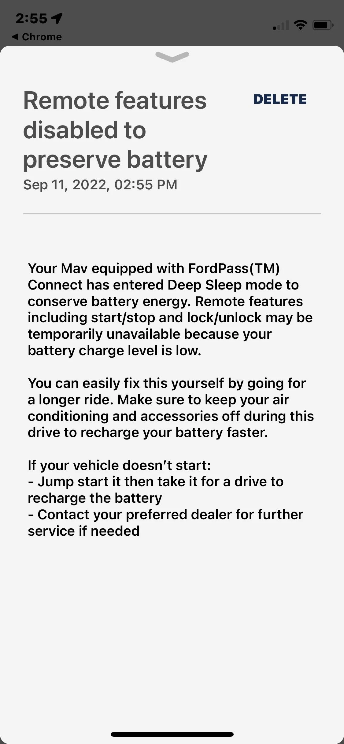

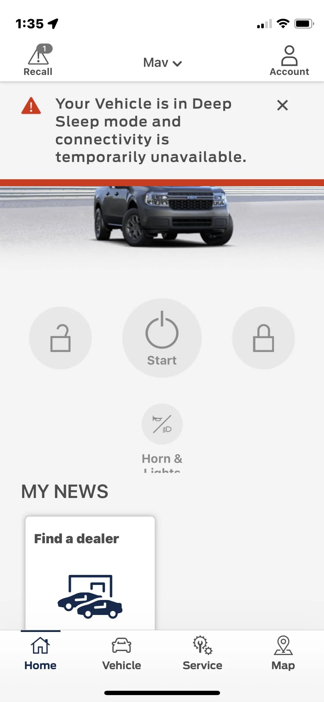

Okay guys, while watching the games today, I got the dreaded "Deep Sleep Mode" message on my Ford app. Went out and even though no dome lights or any power showing to the dash, I started the Maverick with the key. Remote everything on the app was disabled. My Maverick only has 2800 miles on it. Planning on calling the dealer in the morning so just want to make sure I have all the info from others such as print outs from their dealers as to how they diagnosed this. Assuming the problem is my hybrid harness like the others. I drove the vehicle 200 miles yesterday so there should be no reason for the battery to be discharged. I know there is no recall but is there an actual TSB for this anywhere? Also should the Maverick not start in the morning, I have a portable jump box to use. I assume I treat this as a normal jump and connect to the positive jump point under the red cap under the hood and anywhere I can ground. Thanks for any guidance and I still don't get why FORD doesn't stand up and issue a recall. I will keep their lack of doing so in mind when I shop for my next vehicle. How about it @Ford Motor Company
