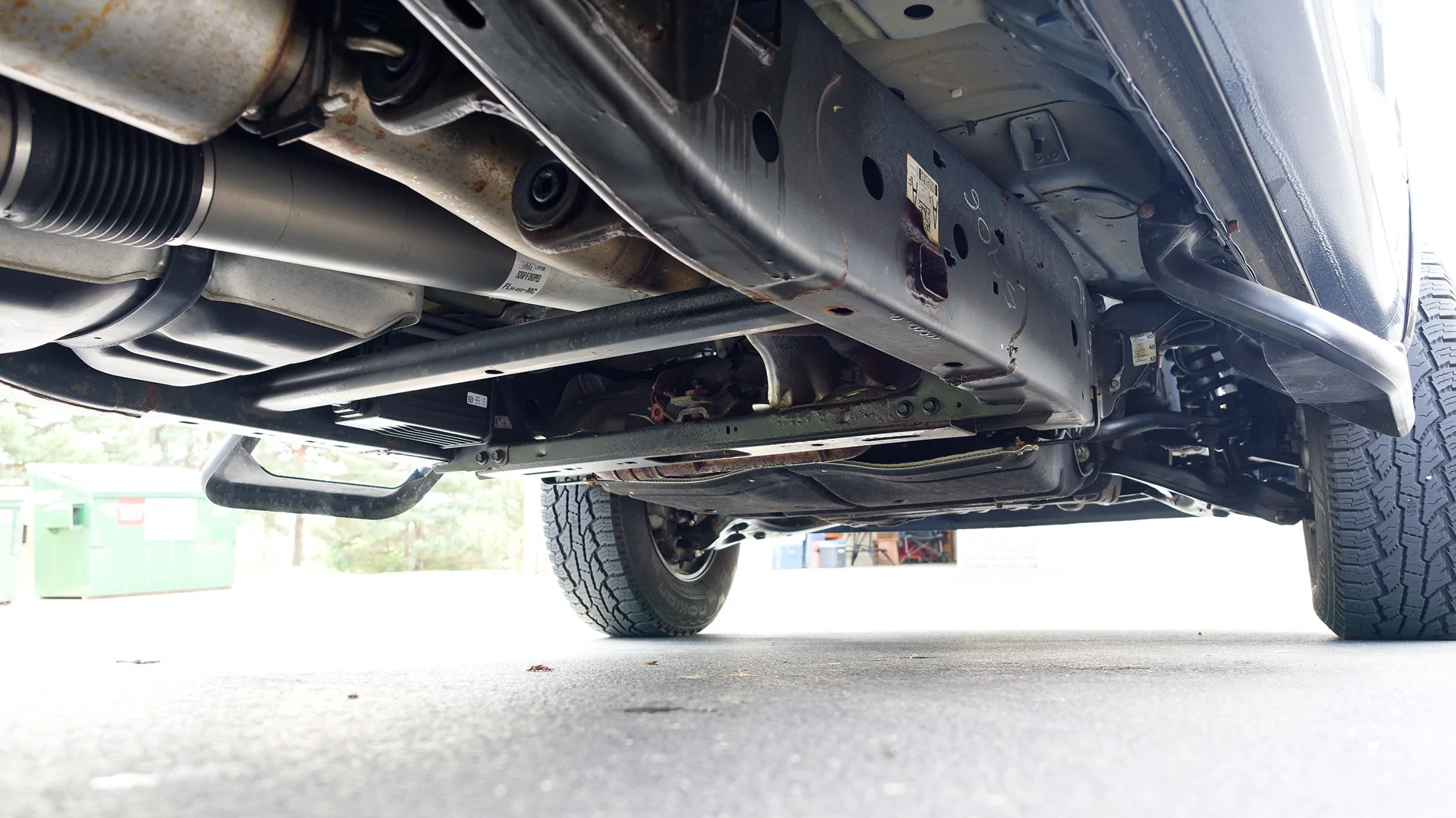

Just a suggestion for an unmentioned product Amsoil HD MP
I use this on my F150 in WI. Large spray can that can do my truck with a single can. If careful spraying there will be do drips, the protectant sets up quite quickly to a waxy feeling surface.
Ford Maverick Undercoating with fluid film? _8311482_DxO
2017 driven thru 9 WI winters. I use 2 cans a year spring and autumn.
