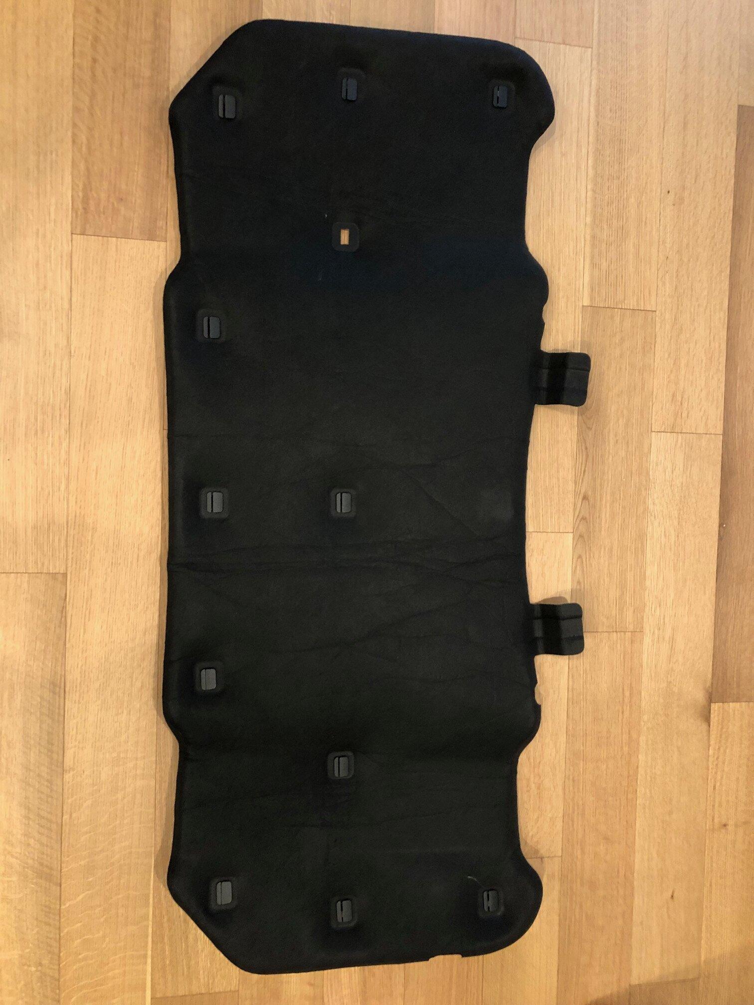

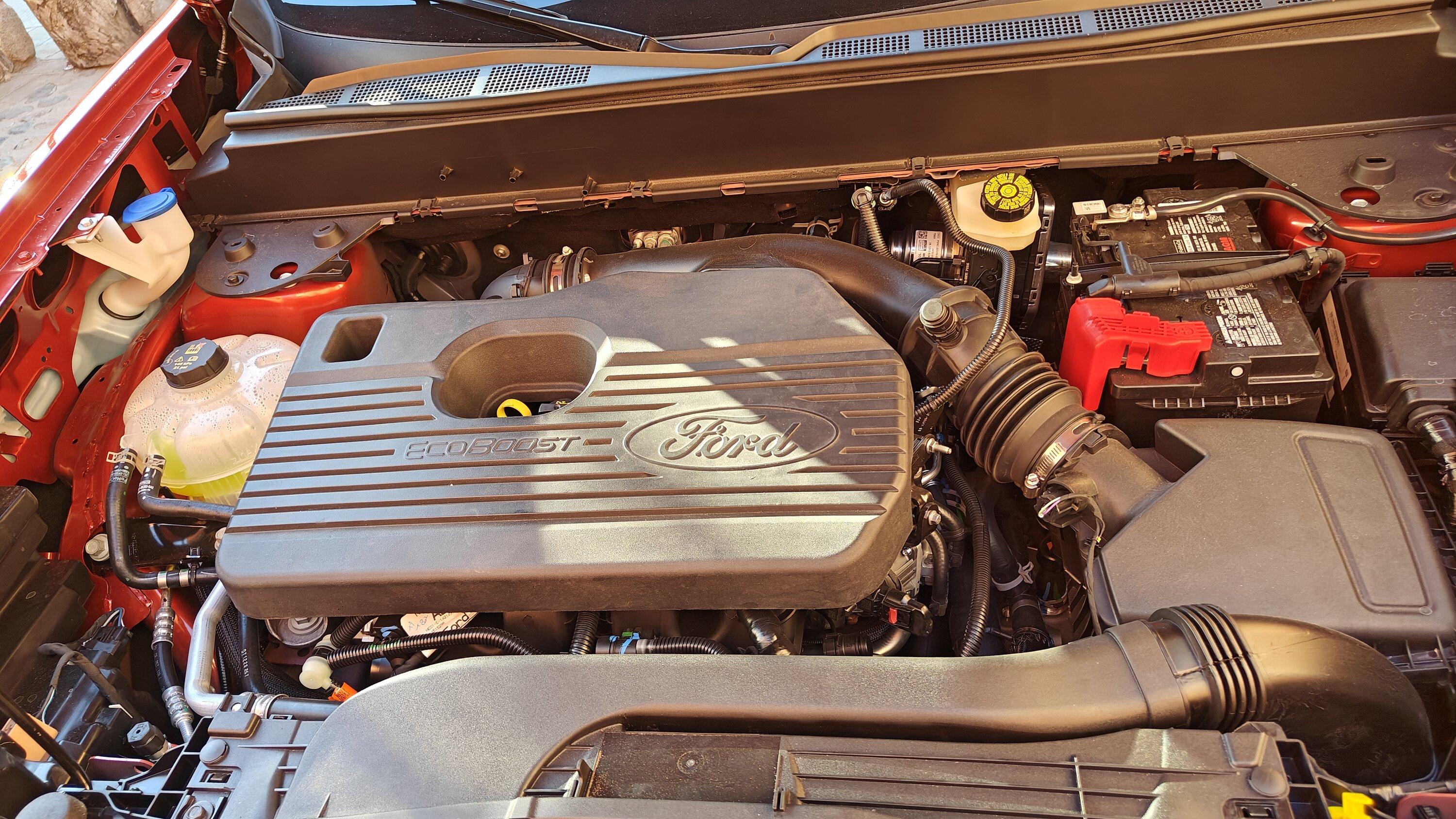

Hello - The cover has various names. The most accurate is engine cushion cover because the part is dense black foam designed to absorb the noise of the GDI [gas direct injection] system used in the 2.0 EcoBoost. The cover part number is
K2GZ-6A949-A. Other engine covers, for the 1.6L and 2.3L have similar numbers but won't fit so don't be fooled when you search.
My understanding is this part is no longer in production. Engines on Lincolns with the same 2.0 EB engine had a cover that has "Lincoln" embossed whereas the part number above has the "Ford" script logo.
There are two round plastic studs molded on, if I recall, the valve cover and corresponding holes on the underside of the engine cushion cover it fits into. They are easy to overlook.
However, there are two metal studs you must purchase - a long one with threads on both ends with a nut, and a short one. Unfortuately I lost track of the part numbers.
If you look at an image of the cover, you will see a smaller rectangular hole. This is for the longer stud with the nut that secures the cover. The short metal stud fits on the right. For both studs there are existing threaded holes for the male stud threads
At this point you will most likely need to look in wrecking yards for a 2.0 EB with a cover unless Ford or someone started producing them again. I haven't checked.

I found one from a seller here on MTC a few months ago. Installed it last Friday (picked up my truck last Wednesday). So they are out there.
Ford Maverick Under Hood lining options? EcoBoostEngineCover
If you get it used, make sure the seller gives you not only the stud and bolt, but also the hidden nubby that you screw in.... The engine has 2 nubbies you press the cover onto... but the 3rd nubby must be screwed in... My seller included a hardware kit that had the stud bolt combo and the screw in nubby...
