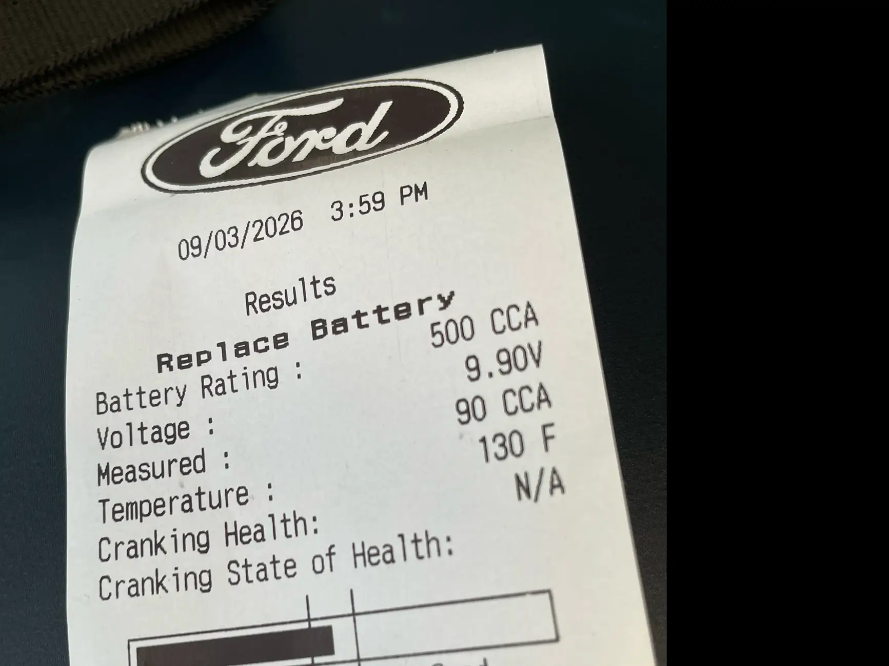

Battery issue resolved. Ford Mobile came out and ended up replacing the battery, here is the readout he was getting.. He said the brakes and steering wouldn't work because the battery could not power the systems because they are based on pneumatics or some such!
Ford Maverick Unable to hold a charge 1788470422514-fh
