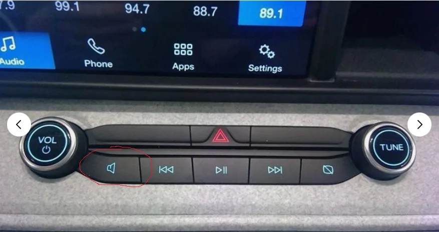

After playing music in Android Auto such as Amazon Music or Musicolet, the next time I get into my 2022 Maverick I am unable to access the radio. If I press the "Audio" button as shown, nothing happens. If I press the "Audio Off" button, nothing happens. Have to go into Android Auto and play something from a music source in AA. THEN I can switch back to the screen below and access the AM and FM radios. Very annoying!
Is there any fix or way to circumvent this issue?
Try the Physical Speaker button, next to Volume. That's what I do.
That does not work in the situation I described. When I switch back after pressing the speaker button, I am still unable to access the radio, i.e., AM, FM, etc. When I press on "Audio" or "Audio Off" it does nothing. Nothing until I access android auto, and play music using an AA app such as Amazon Music. THEN I can access the radio again.
