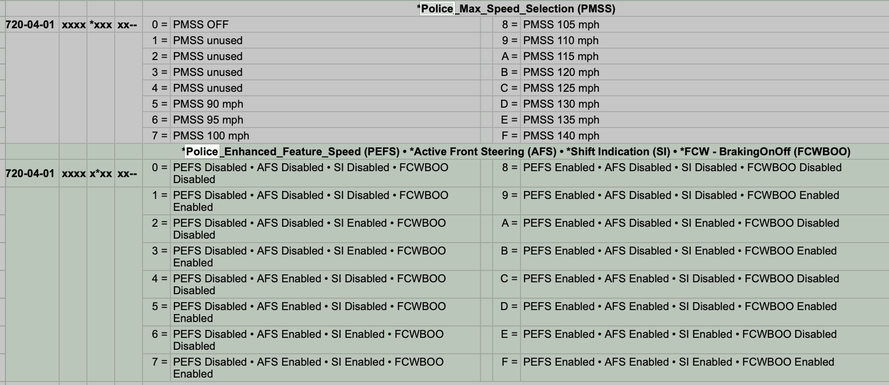

It's my understanding that for the PMSS if you set it to 0 it should just disable the speed limiter completely.
Also on the 720-04-01 for Shift Indication, does this mean it will actually display which gear you're in on the Instrument Cluster?

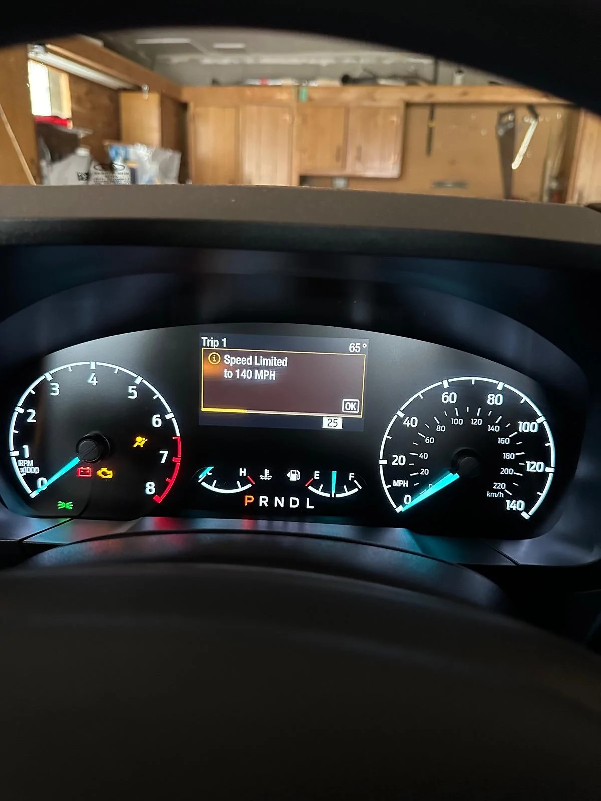

Yes so change the factory coding from "01" to "09" for no max speed selection or "F9" for 140 max speed. I am not sure it works as I have not tested it and I don't recommend others test it either. It may not work!
So I have tried everything I can to get the transmission gear display to show up in the IPC including shift indication and it does not work on my 4 inch display. It may work on the 6.5 inch display. As of right now, you need paddle shifters installed and a few codings to engage the gear display. I have tried several codings with no luck in an attempt to display the gear on my "stock steering wheel" maverick. I believe you have to click the paddle shifter (when installed after coding) for the gear to start displaying on the cluster.

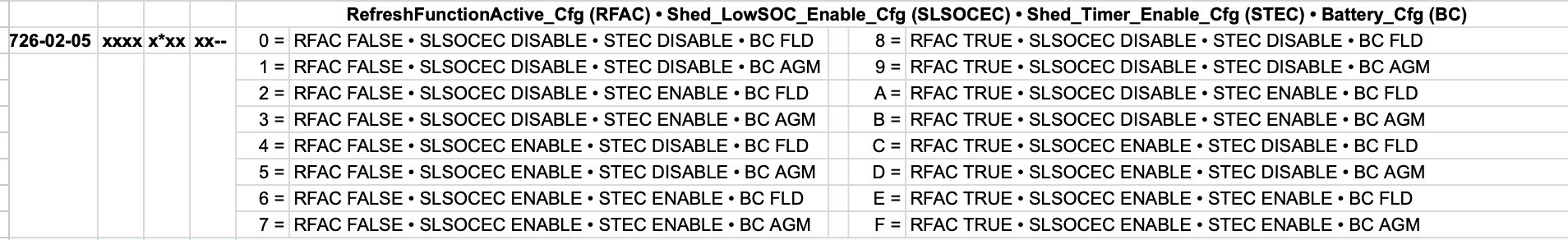

@Packer Bill Check out this picture below. seems to be battery configuration for AGM or FLD
Ford Maverick ULTIMATE FORSCAN Ford Maverick Spreadsheet (MASTERLIST) 🗒️ Screenshot 2024-04-10 at 4.08.48 PM
Packer Bill
Jun 21, 2021
1,928
2,592
South Dakota
I am unfamiliar with these settings. Perhaps one of the local experts can help us to understand these settings.
