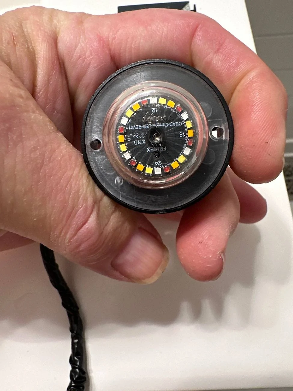

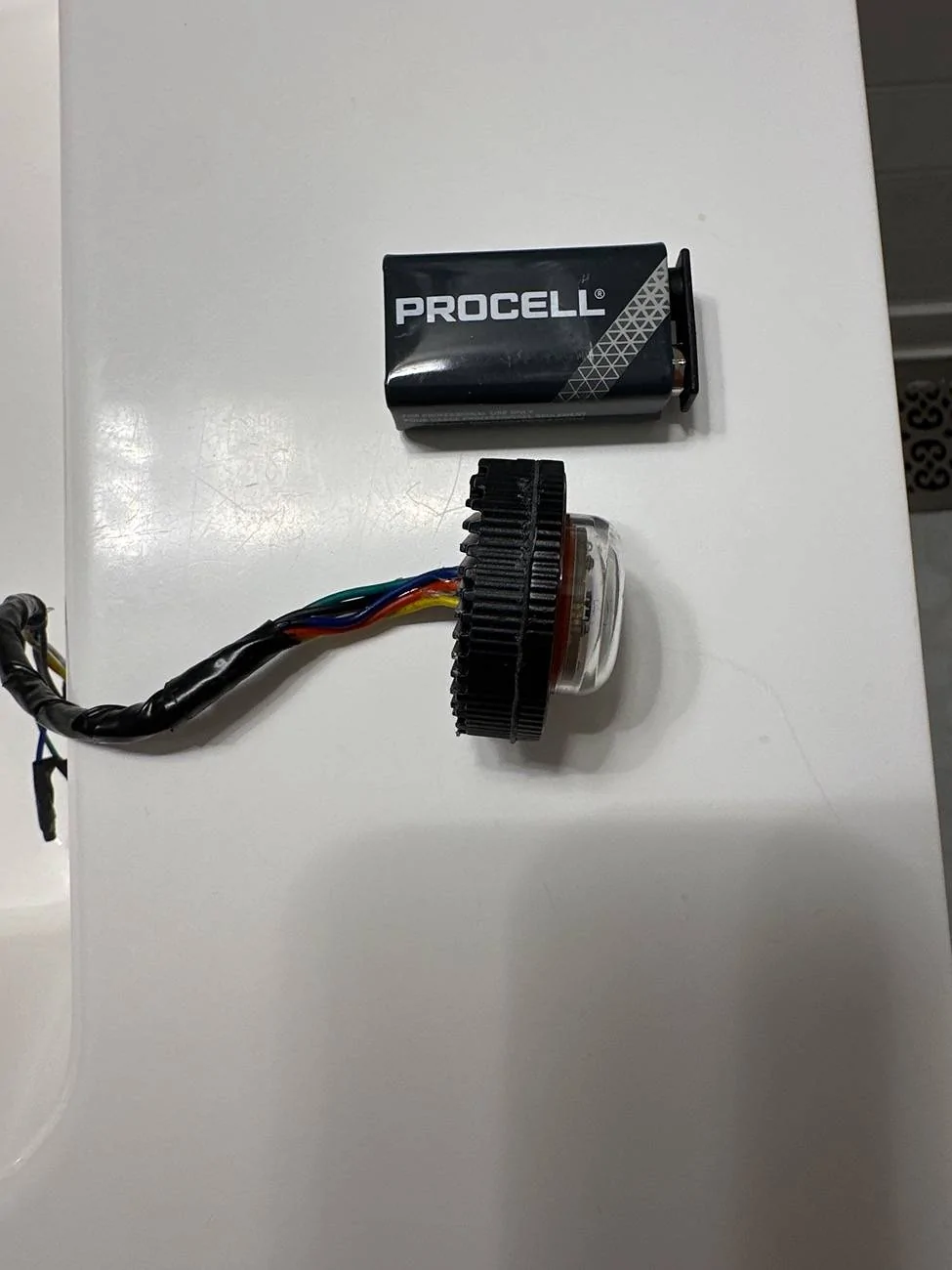

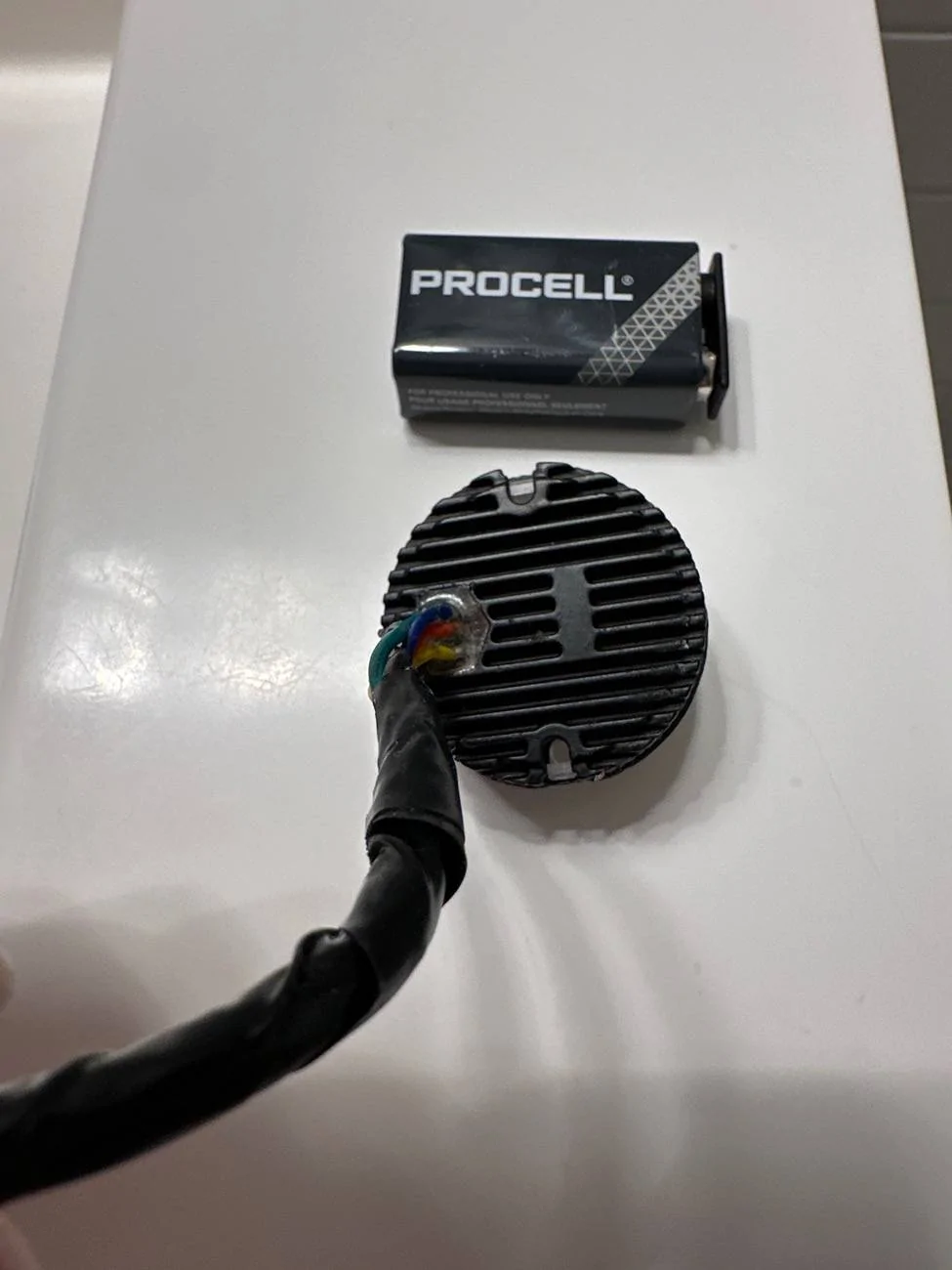

The ones in the XLT badge are FENIEX QUAD CANNONS. If you surface mount these you will need the cover for them or drill a 1” hole and hide them as they have a 120 deg spread. I wanted mine to stick out so people can see them as they approach. They have 3 modes too as well as 4 colors built in and are SAE CLASS 1( not toys)

That’s cute, but it’s a toy light. If you want to grab attention , only use CLASS 1 SAE rated as the toy lights have a very narrow beam to make them look bright at a certain angle. Also they tend to leak water in them too.

If your going to use the FENIEX or WHELEN, use the solid on option in the strobe patterns so your maverick does the flashing, the lamp just acts like a standard bulb .

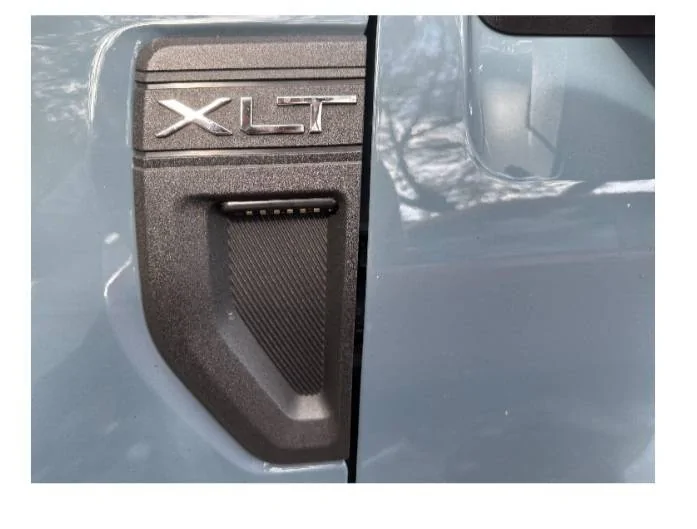

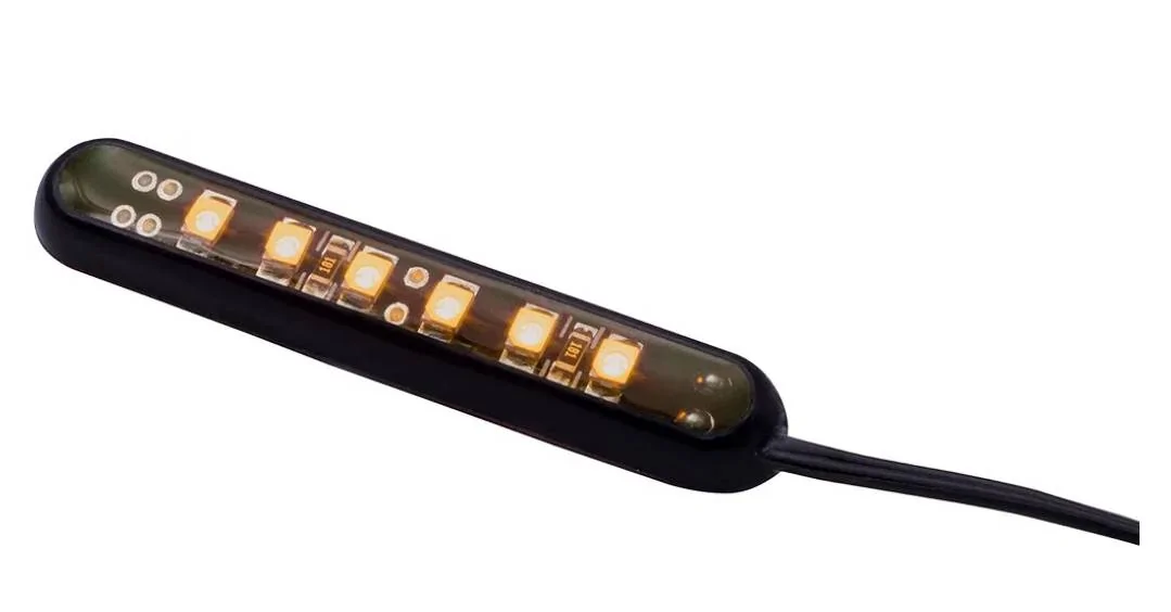

🤔 I like the idea of a mirror cap turn indicator. Short of that, I think I like something fairly subtle. Mounted in the side badge here's one example there are a couple out there.
OR
There is one that's more like a capsule shape with three small LEDs at mounts in the top recess of the badge.👇👇
And here's how they look mounted👇👇
That is exactly what I did to my 2023 , it also flashes when I lock/unlock the doors and it is a turn signal as well. Like it also It's the small Amber light I believe I got them pretty cheap on Amazon.

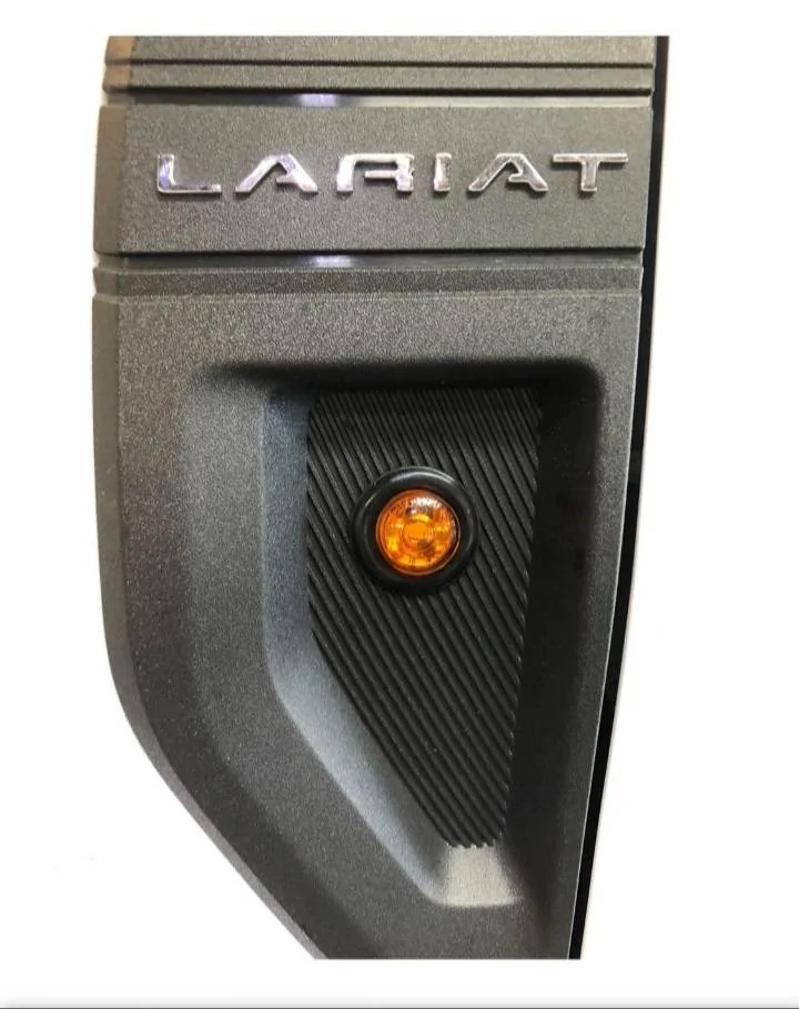

OR
I like the single LED fixture installed in the side vent but will consider covering these with a 3D Printed lense my dilemma is finding a plug and play wiring harness
I feel the same way about having a plug-in play harness.
Wouldn't it be nice if Mabett sold just a plug-in play harness?
I've got the same lenses in the he smoked color and have assembled the rest of the parts; LEDs, wire, wire wrap, and plug set, to make my own plug n play setup. I'm all ready to go but have to wait for the weather to clear a bit so I can stand the cold working in my shop to get it all together. I'm planning to put it all together with pictures and parts references and post on here. Should be a couple weeks.
