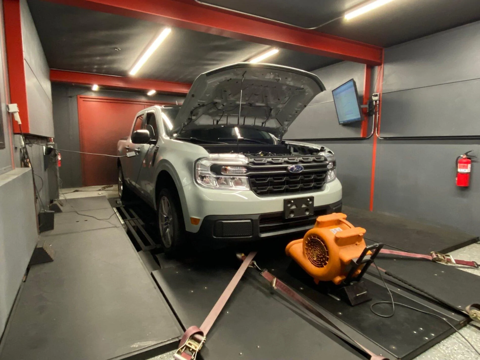

Got the truck on the dyno yesterday for some preliminary testing. Got our baseline in on 100% stock tune, only change to the truck that would effect the numbers are the wheels. However the wheels were on the truck for both baseline and initial tuning so the delta is what is most important. I would guess it would have a slightly lower number if I put the stock wheels back on it as they are taller and a little more heavy.
Dyno'ing this truck proved to be a little difficult as there isn't a manual mode or paddle shifters so keeping it in the gear I want for pulls isn't possible in factory form. Additionally this isn't an AWD all the time setup, this truck is AWD when it "needs to be". It is mostly FWD and the RDU (Rear Differential Unit) kicks on as needed based on torque input, steering wheel angle, and most importantly wheel speed ratio from front the rear. If the front wheels are spinning faster than the rear then it detects this as loss of traction and will engage the rear diff as needed.
We work on a linked dynojet dyno so the rollers spin at the same speed, so theoretically the truck should be fine because all 4 wheels are spinning at the same speed. However on the Focus RS we have to put it in Dyno Mode which is FWD only in order to dyno tune them because even with the wheels spinning at the same speed they still freak out. This was the same case for the Maverick, however on the RS it will turn the RDU off but on the Maverick it stayed on so we were able to do the entire session in AWD mode without any issues besides the dash lit up like a Christmas tree.
For the gear solution I was able to dig and find the coding for diagnostics testing that Ford uses themselves. From there I found a switch for locking the truck in a specific gear and it won't allow it to upshift or downshift. I stuck the truck in 4th (5th would work just as well and show slightly higher numbers) to keep the overall speed down for less wear and tear on the dyno brakes and the truck itself.
By the way, when the calibration is told to run a single gear that is all it will do. So when we went to pull it off the dyno it didn't have reverse and I was a little confused. We pushed it out of the shop and tried to see if driving it around fixed it. Then I realized, damnit I forgot to turn off the test lock haha. It only had 4th! lol.

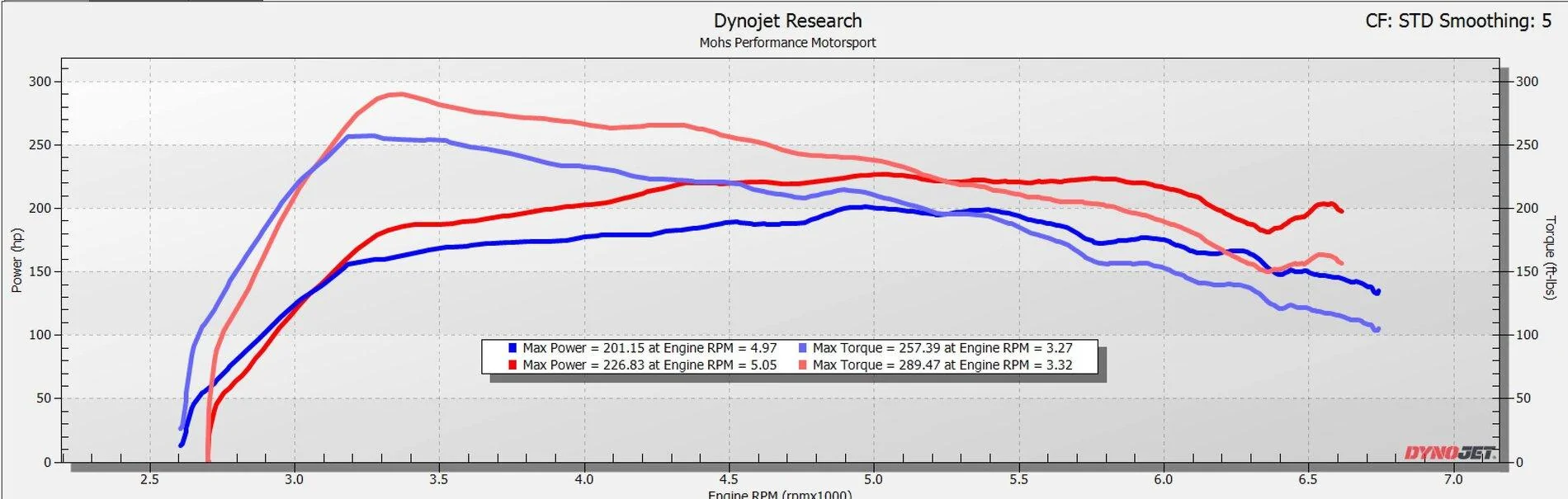

I have attached a picture of the baseline numbers along with my first tune changes to show what we picked up on a 100% stock truck.
Stock - 201whp/257wtq
v100 Tune - 227whp/289wtq
Gain - 26whp/32wtq
Not to shabby of a gain, but there is definitely more to be had. I ran into some setbacks and need to work with HPTuners to get some changes added to the software and need access to a few different tables. Once we get that sorted out I believe we will be able to pick up another 10-15whp on 93oct.

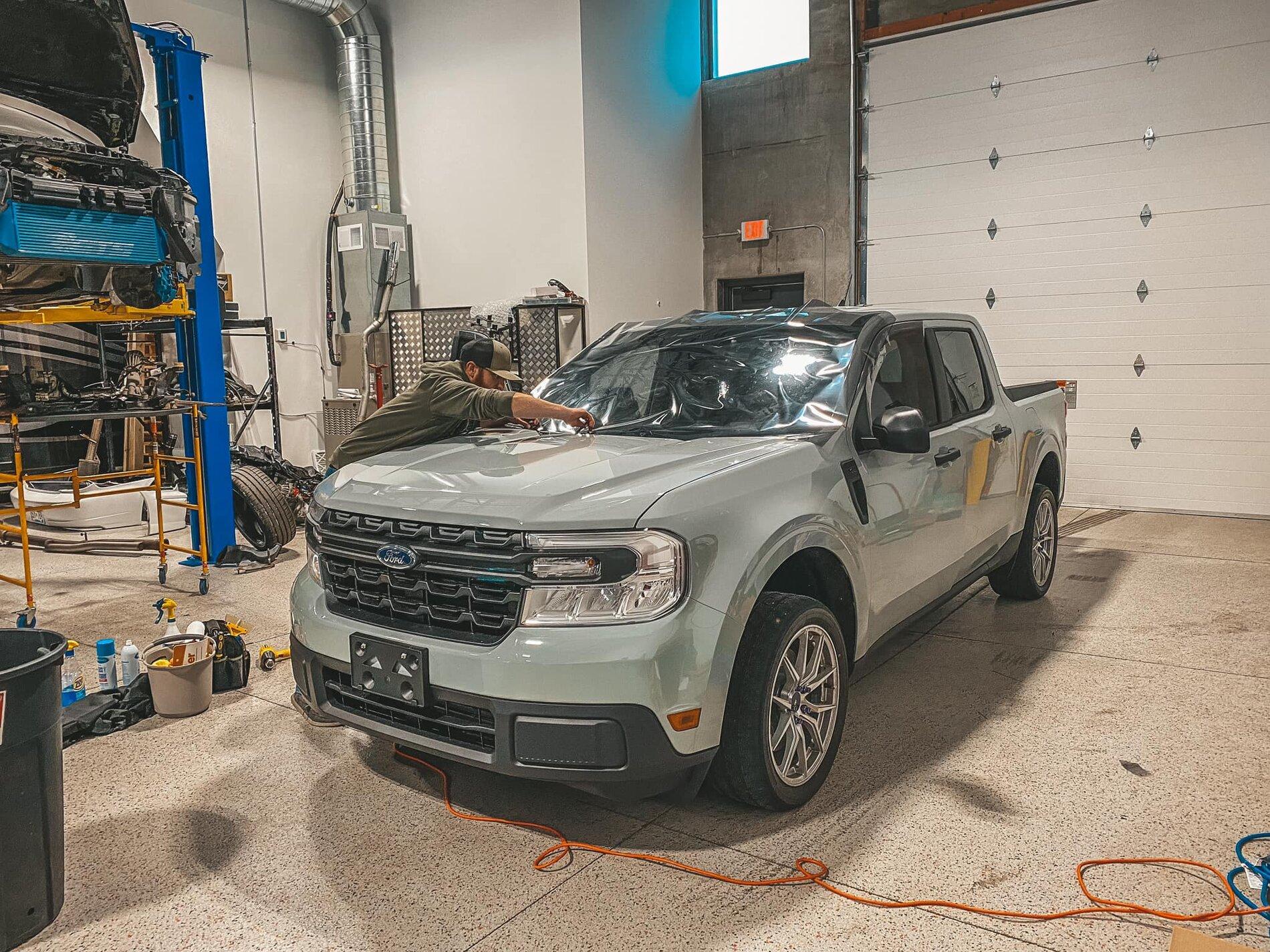

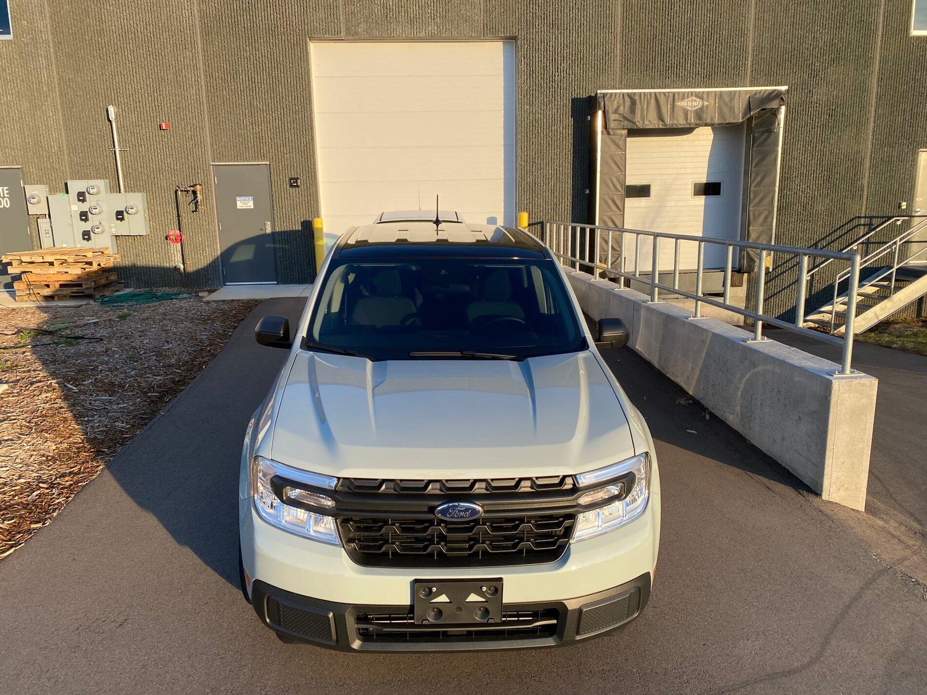

Now onto the roof wrap. The other day when I posted up pictures of our truck getting some tint someone wanted to see what the roof would look like wrapped black. Well, luckily the shop next to ours is a wrap shop and I just walked over and said "hey, do the roof on the Maverick in gloss black. K THANKS!
An hour later it was done, and it definitely is something I would recommend. I have the front windshield tinted and having the roof wrapped makes it look like a continuation of the windshield and it just flows better in my opinion. Again, that is just me, you might not like it but I do so I do what I want!

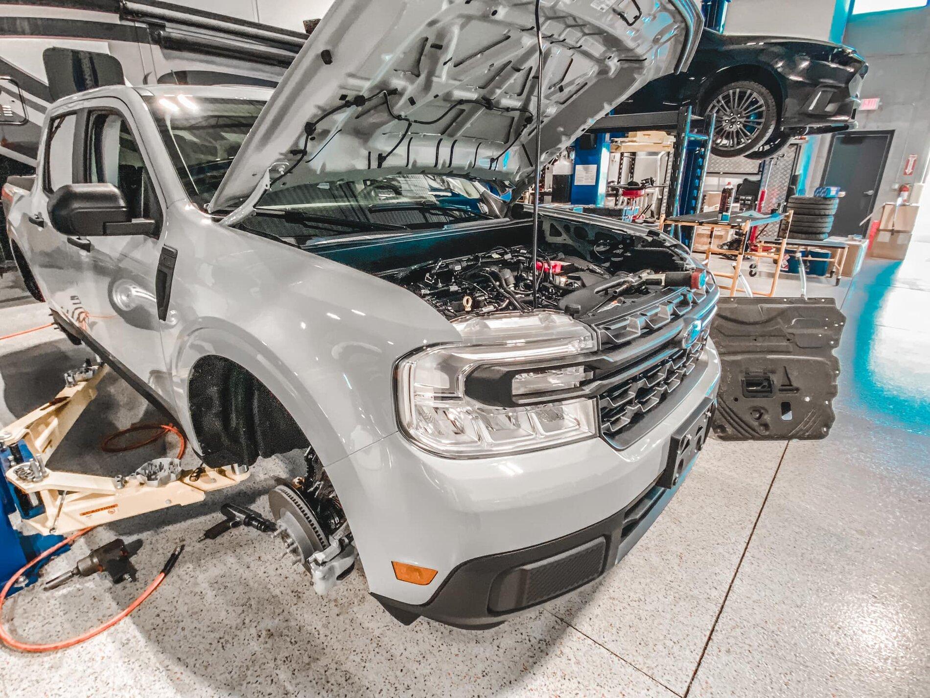

Lastly, first parts for our Coilover production came in yesterday. A little too late to get them on the truck yesterday after being on the dyno. Then today I'm working from home to spend some time with my son so we will likely get the truck up on the lift tomorrow and start test fitting the first batch of parts we got. I'm crossing my fingers that we can get something road-ready tomorrow because I can't stand driving this mini "monster truck" with the temporary wheels on it. I want to get this thing on the ground and toss the wheels I have set aside for it. I think it's going to look sick!
