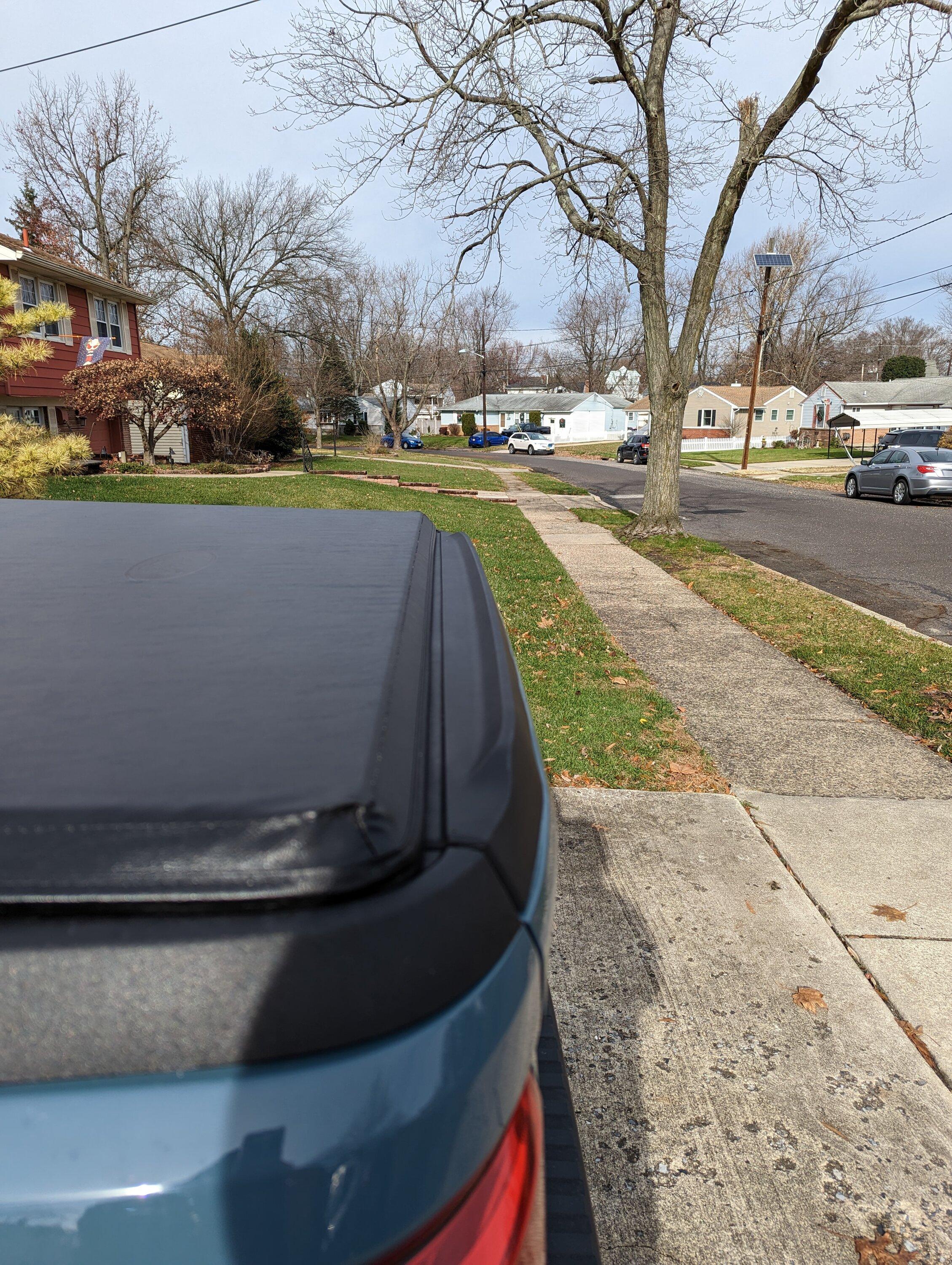

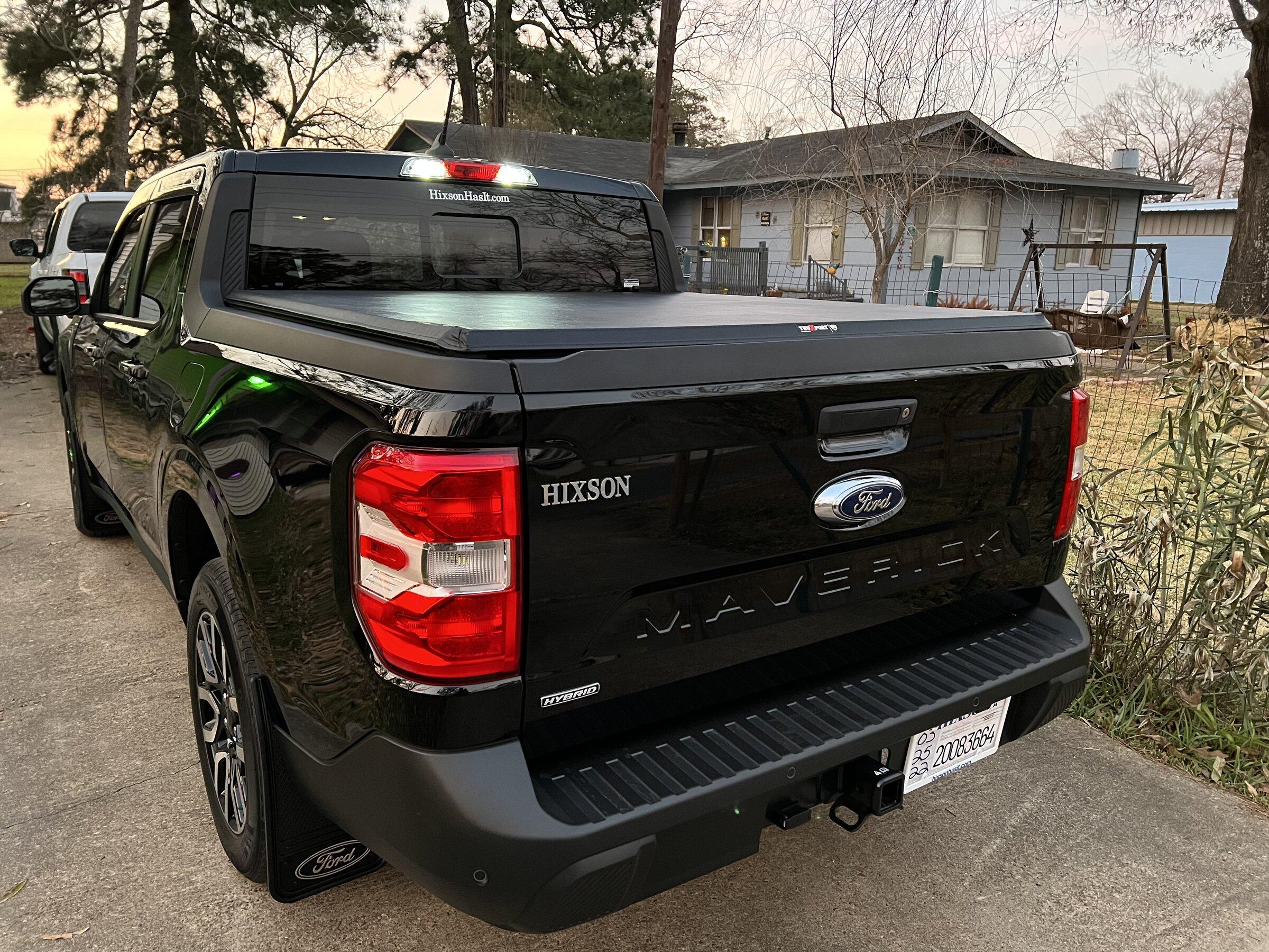

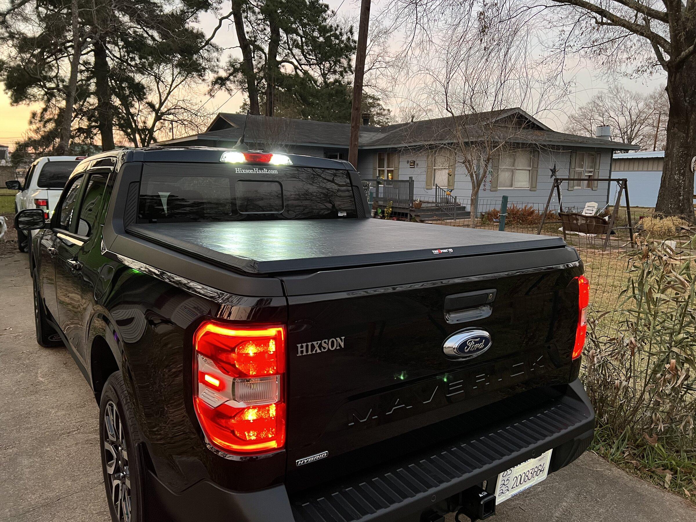

I installed mine and if you push it up all the way against the cab, which you aren't suppose to do. It will likely be short. If you follow the instructions and mount it at the edge of the bulkhead then it will fix properly. Now it won't have any extra at the tailgate for sure. But it does fit just fine. I seen one guy do an install video and he mounted his all the way against the cab and so YES it was too short. He also put the seal on the tailgate instead of the bulkhead. Which was also wrong!
I've spent so much money on accessories between two trucks I had to go cheaper on this bed cover. I am happy with it for the most part.
I can post some pics later today. Harder to see it on my truck though because it's Shadow Black! :)
Ford Maverick Truxedo truxport cover too short? IMG_0195
Ford Maverick Truxedo truxport cover too short? IMG_0194
I will try to get some better angles for you later today!

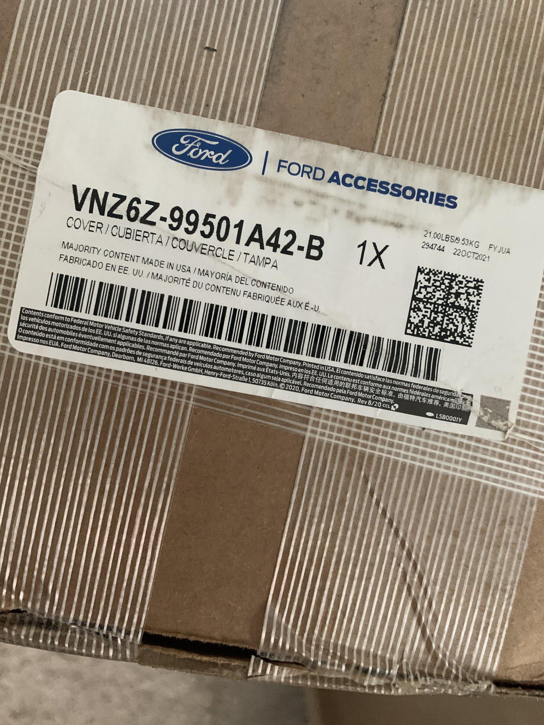

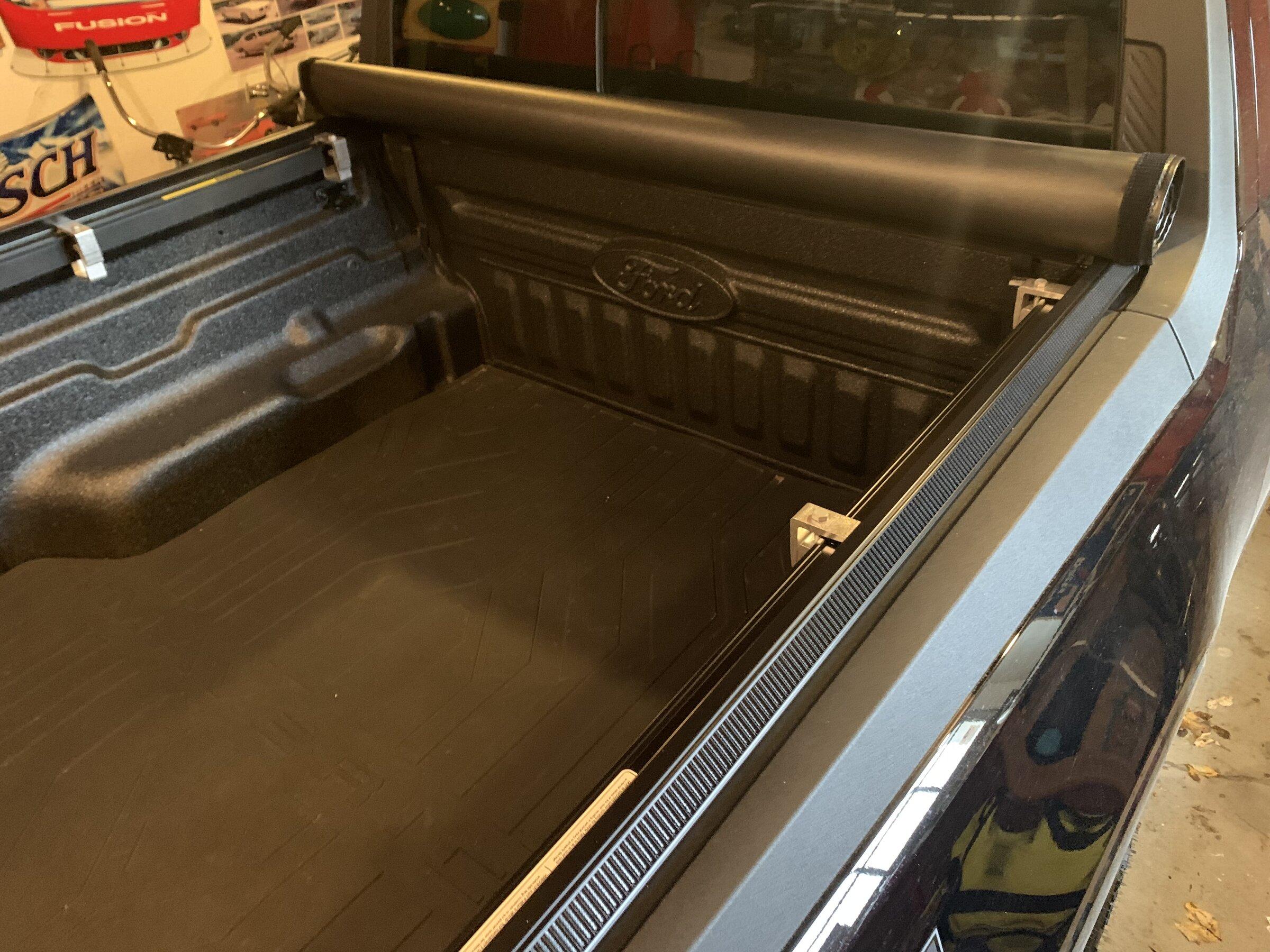

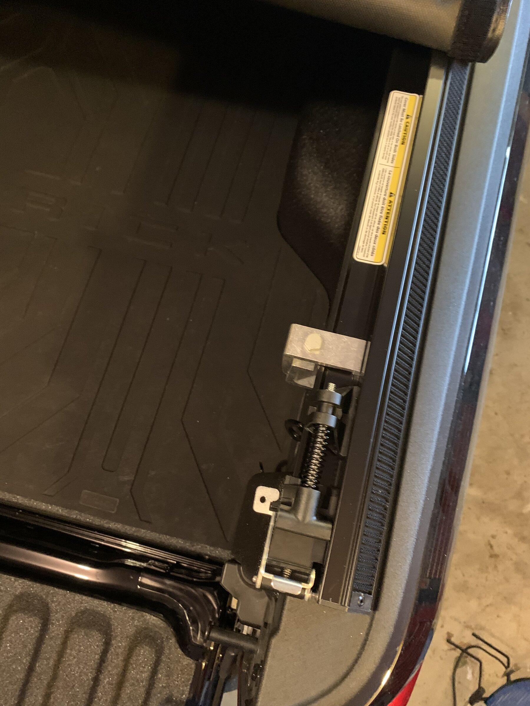

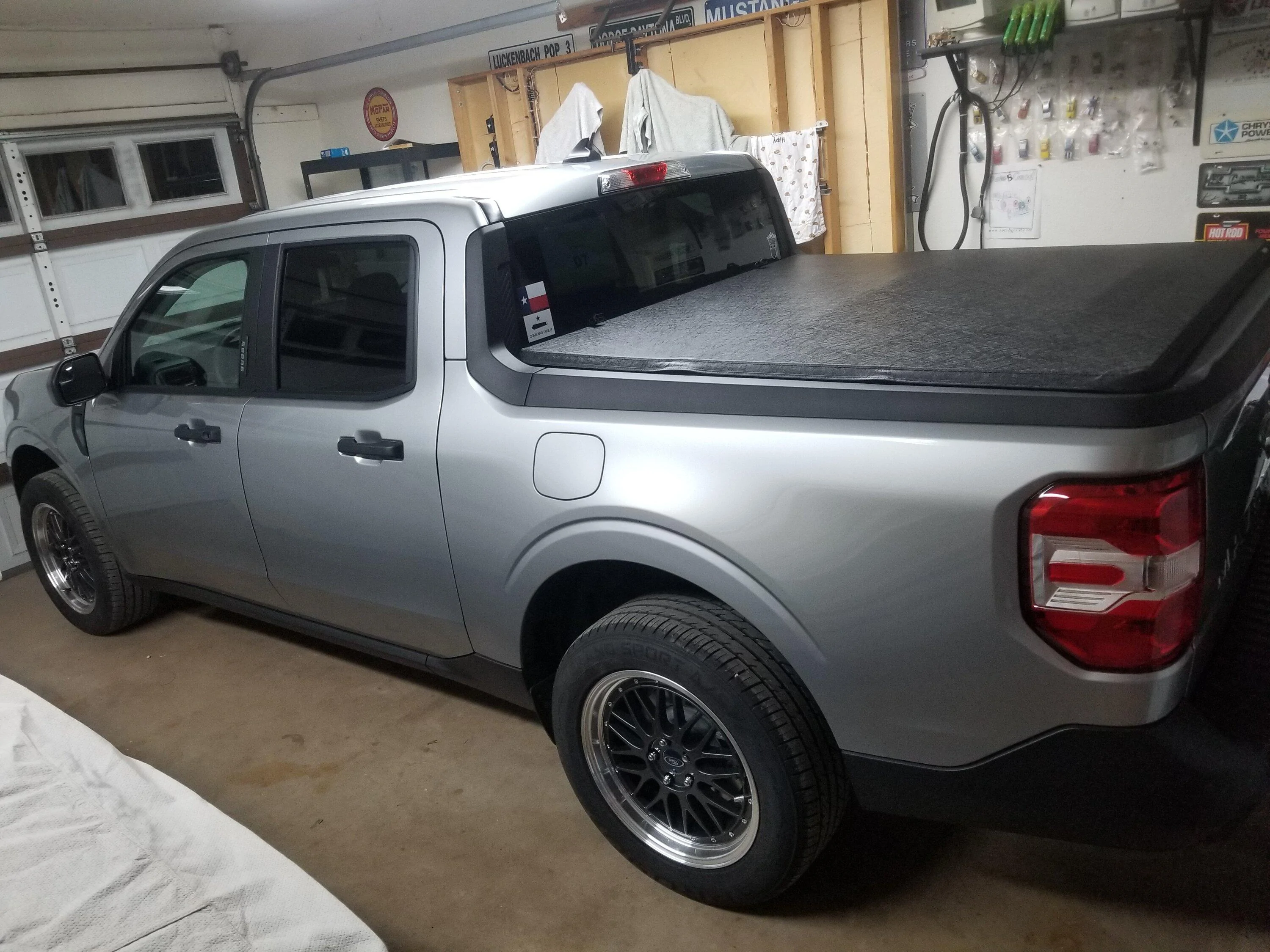

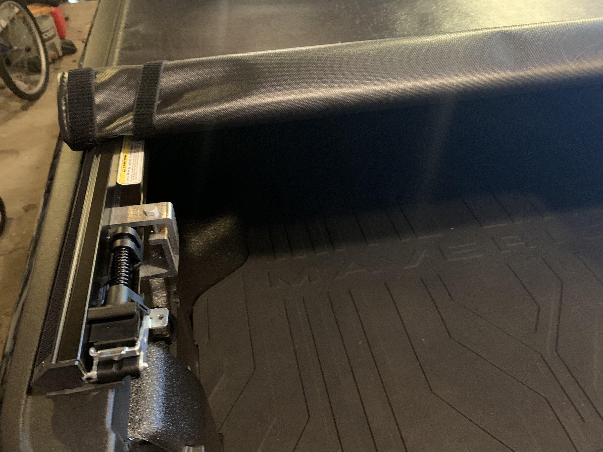

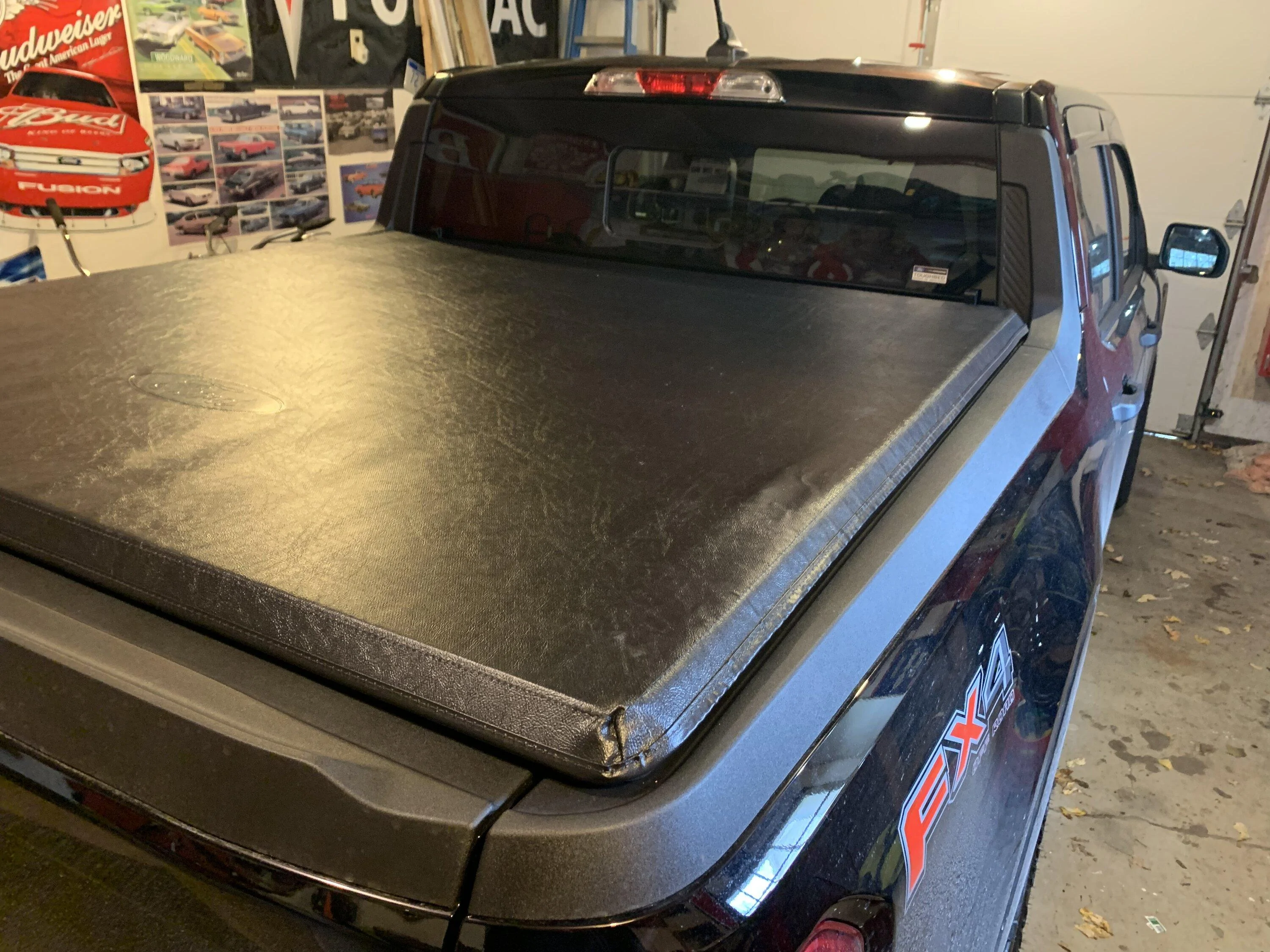

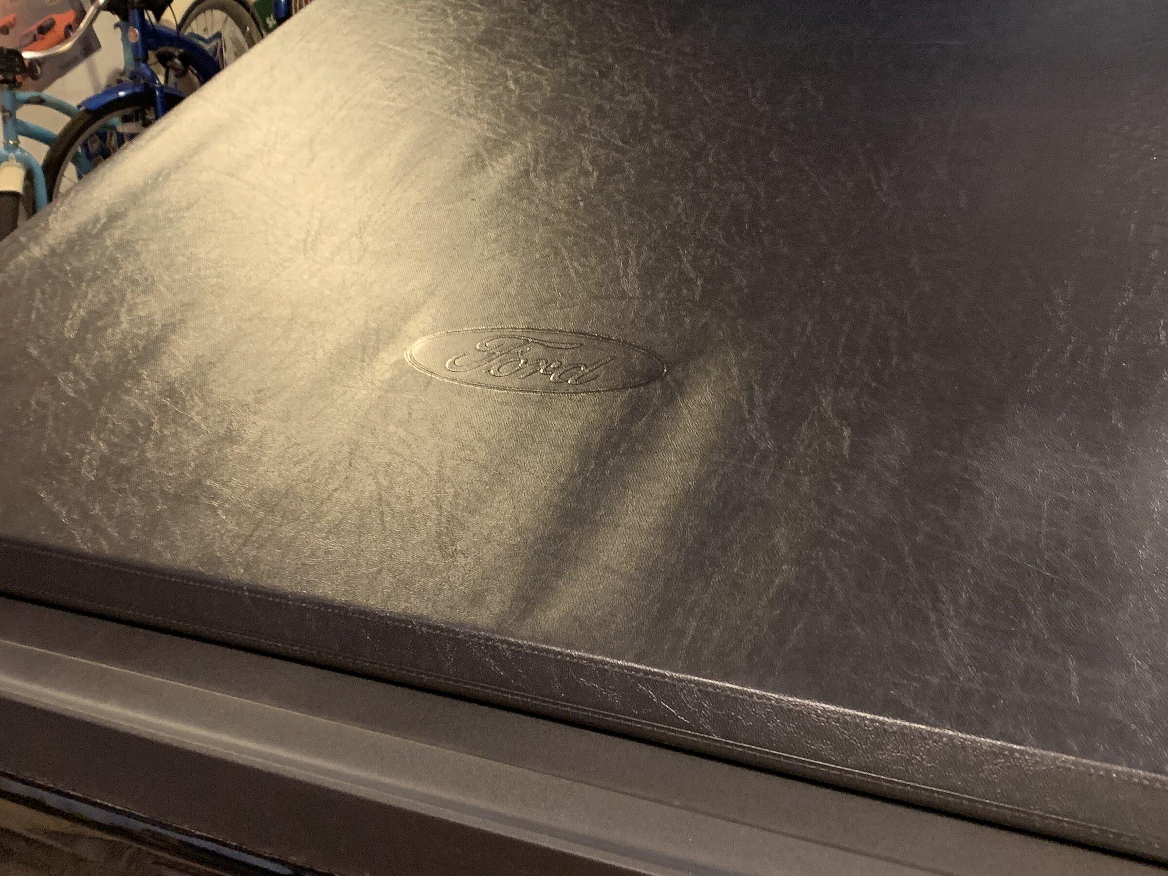

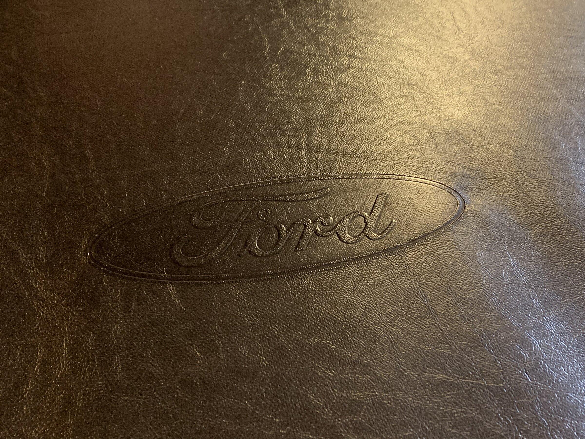

I ordered the truxedo from ford accessories since it was the only one available back then & was also able to use my ford pass points towards purchase and it has a ford logo on it… I wish it were longer approximately 1” too short (I guess when you “say” four and and a half = 4.5, but when you “measure” four and a half it’s 4ft 6inches 🙄) yes it keeps rain & snow out but car wash leaks in - here’s a few pics I had already

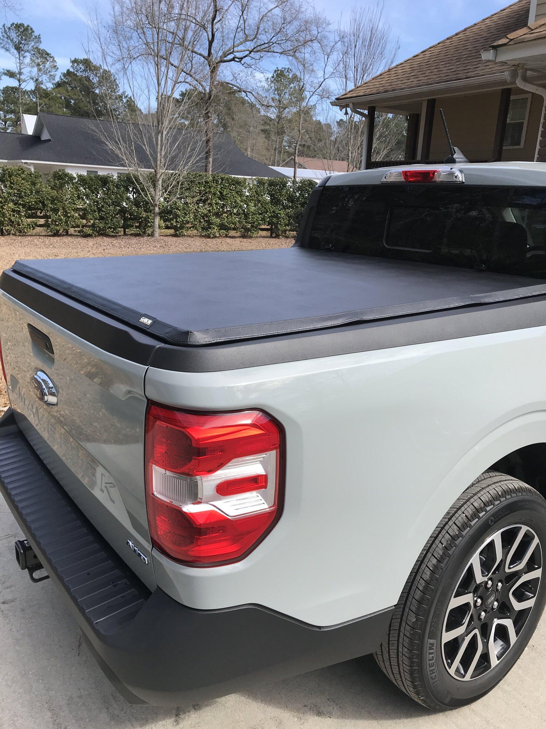

I just got my Gator tri fold and am very happy. Its not up agains the glass at the front but about 1/2" back. I did not install the extra bulkhead seal as I am not sure its needed but very easy to add.

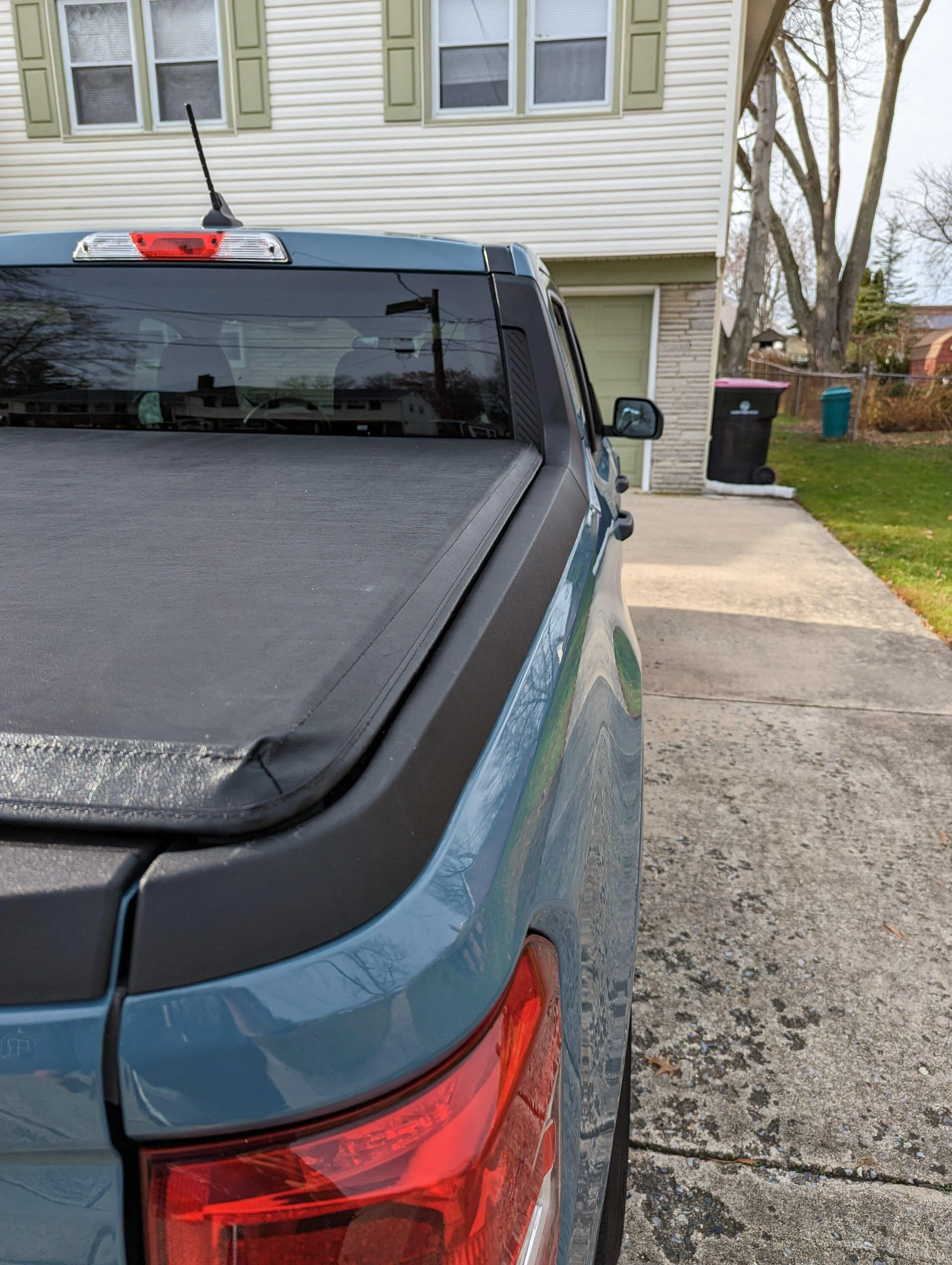

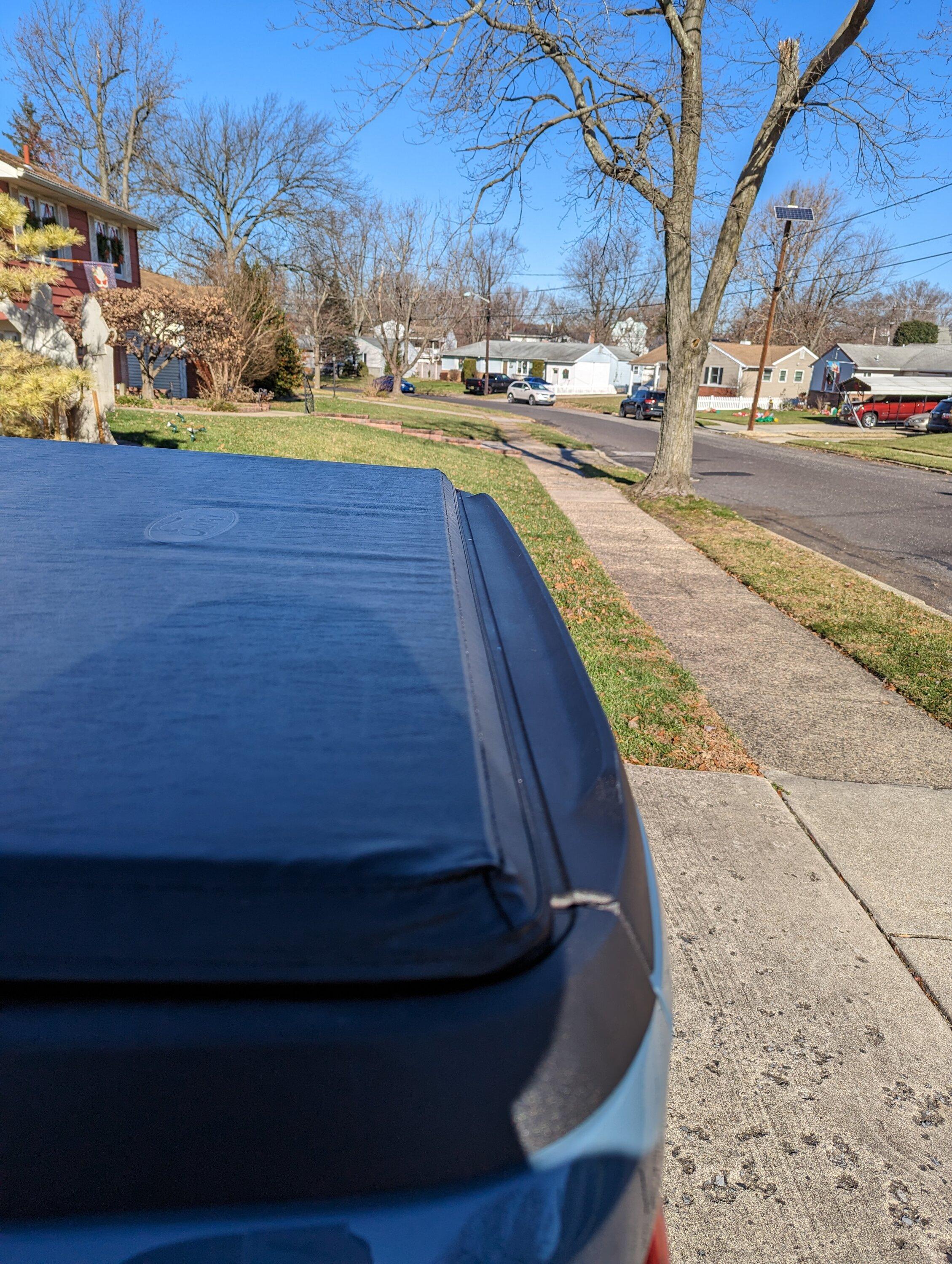

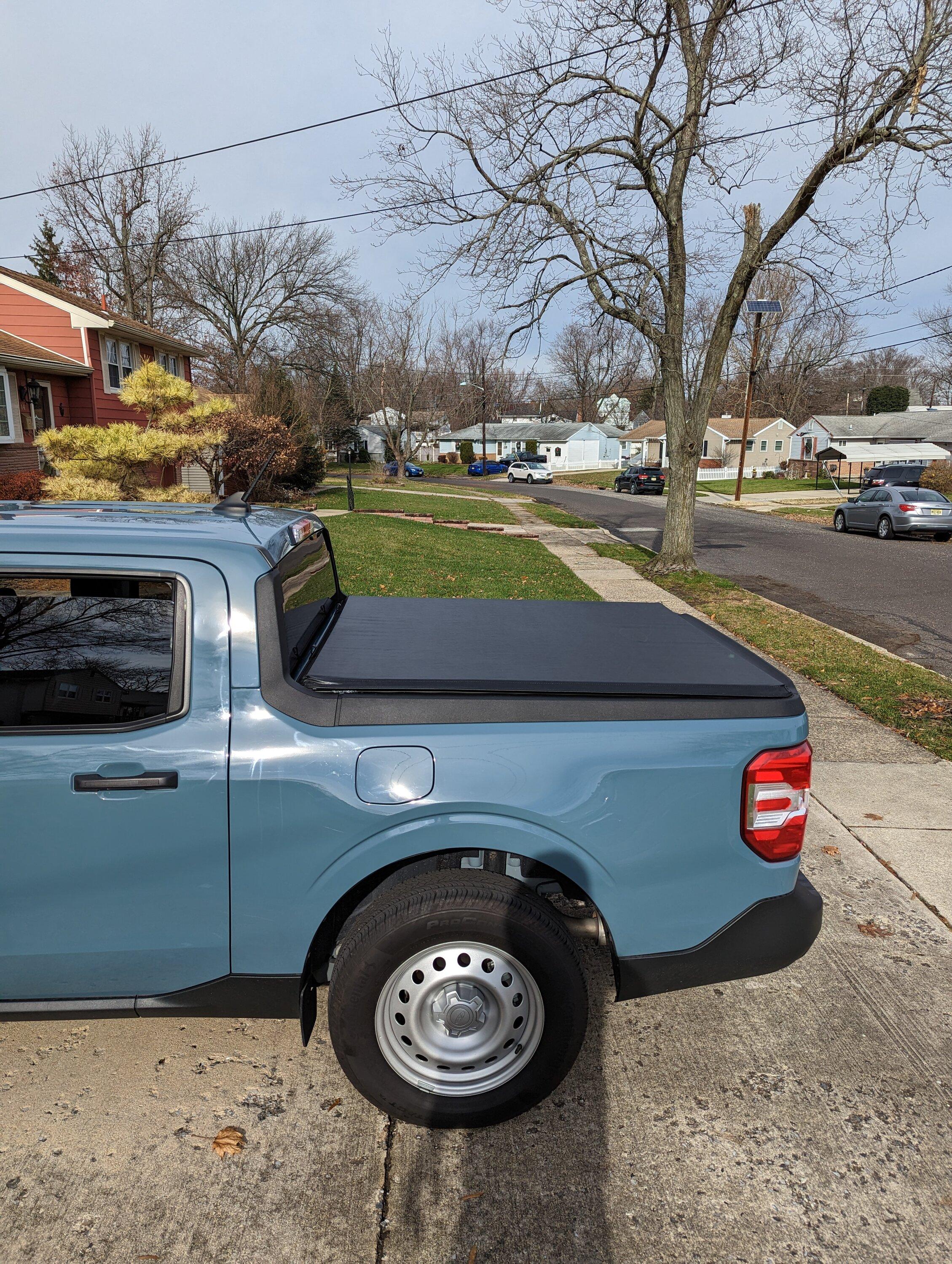

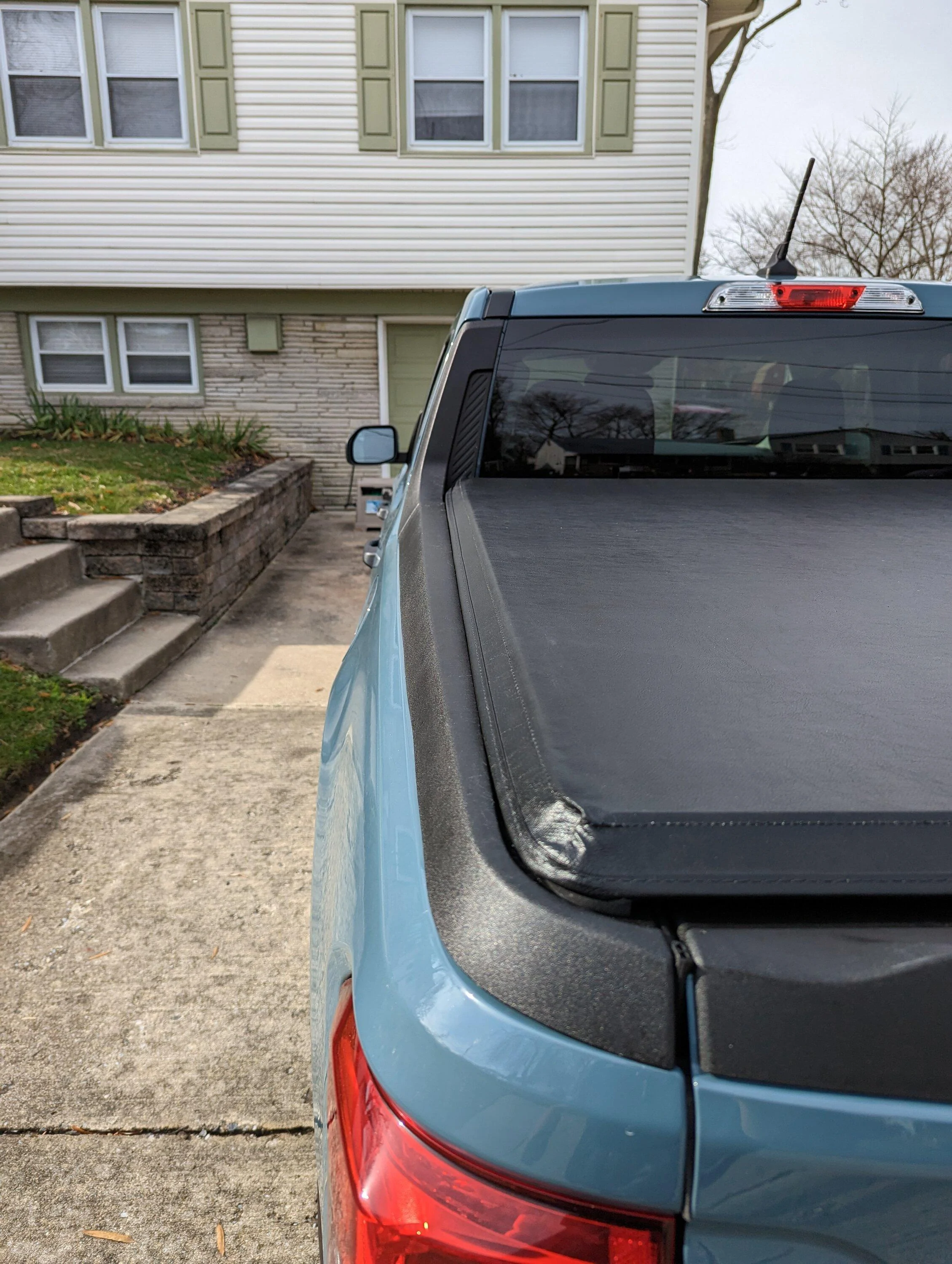

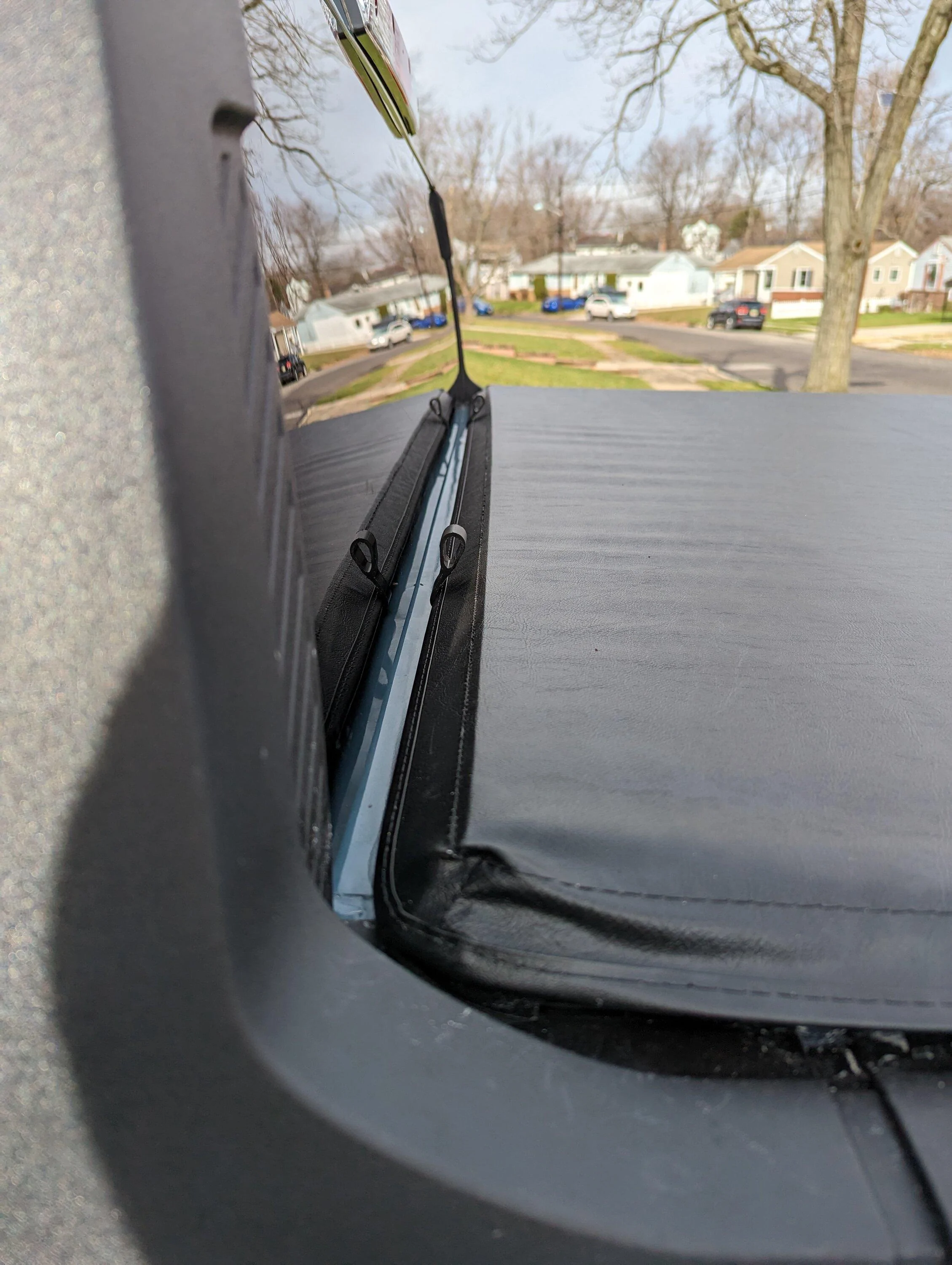

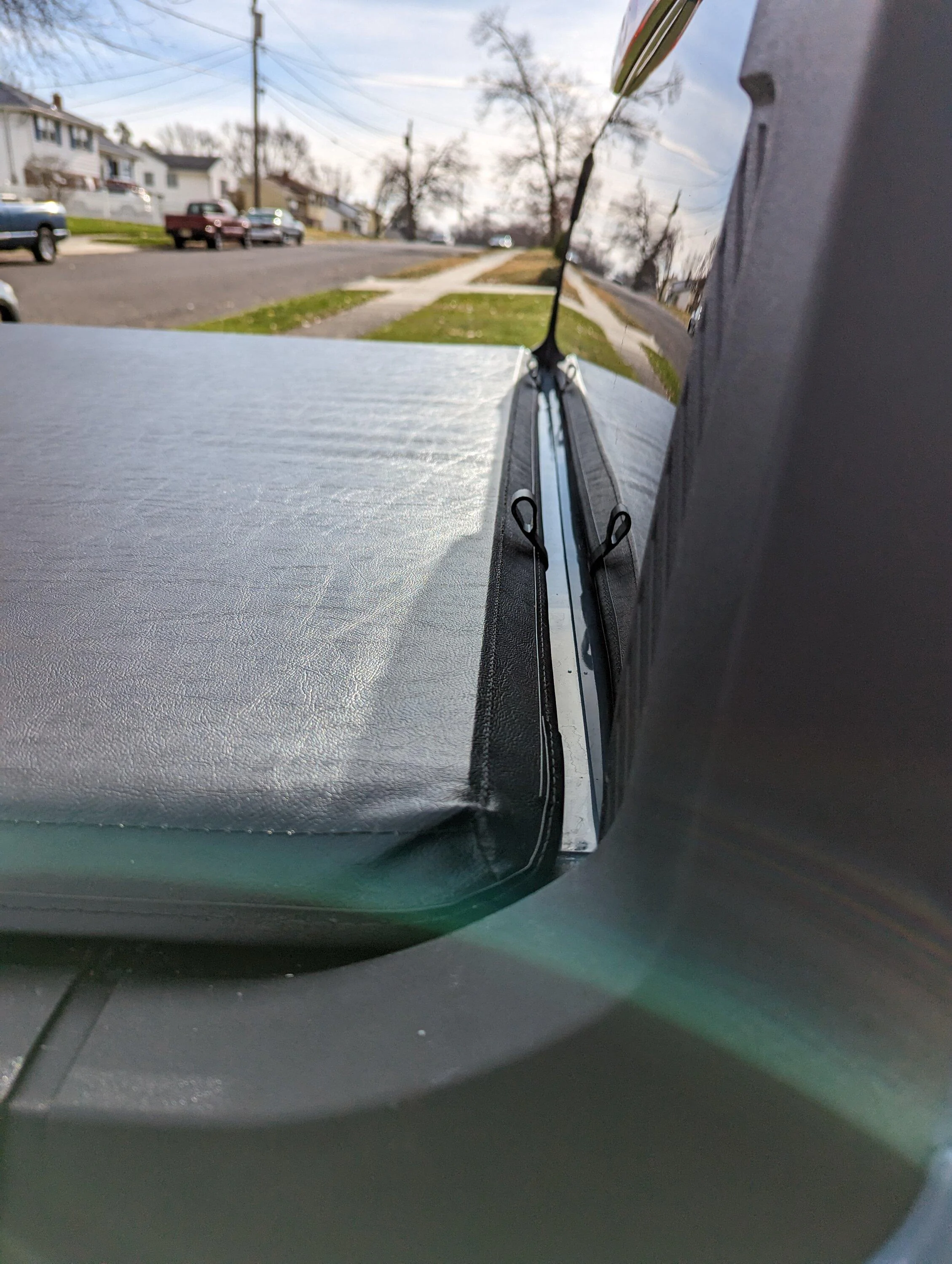

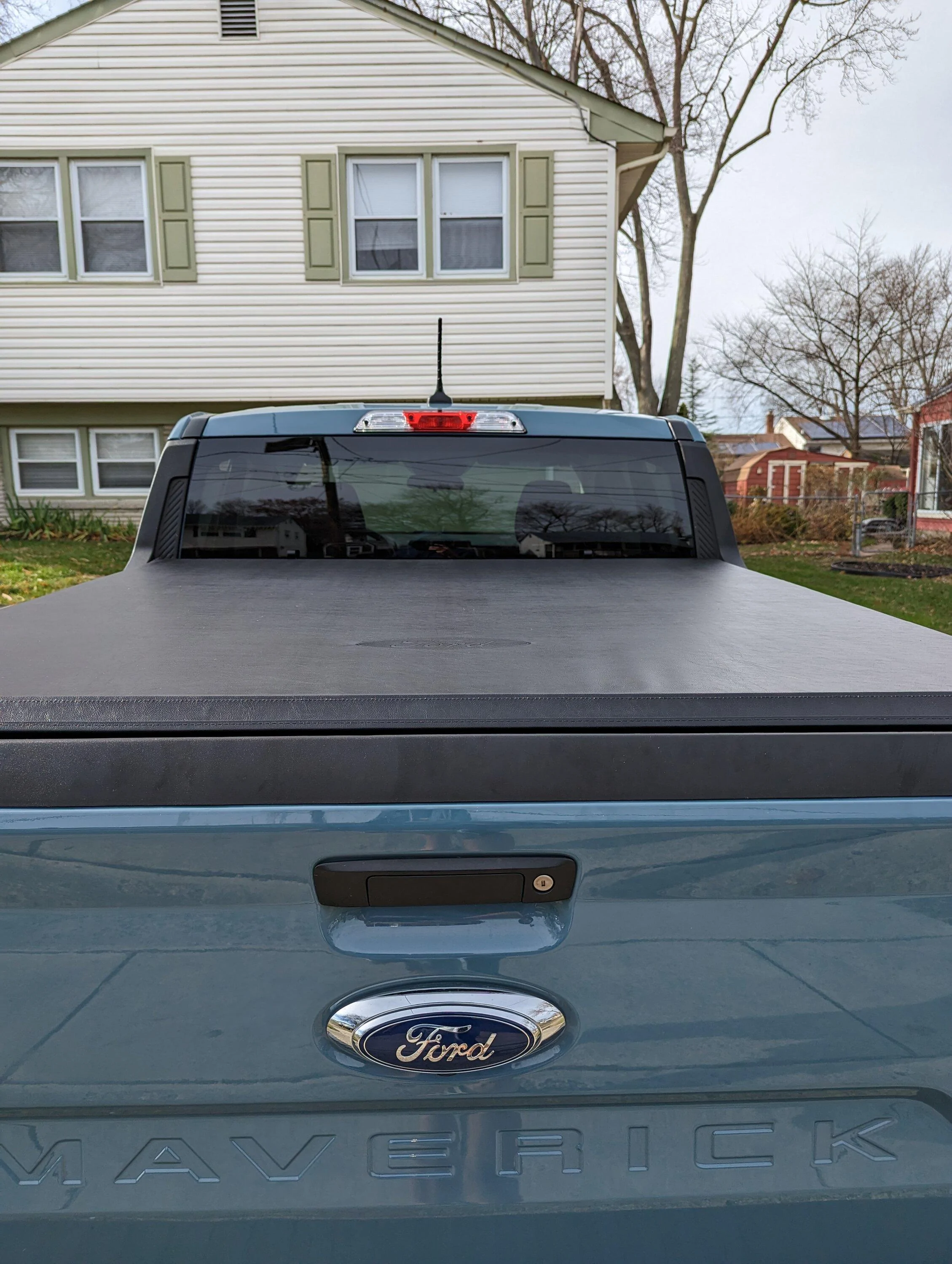

How far to the bulk head is yours? I get some water by those front corners. It looks like that's how it's designed to drain water off the unibody bulkhead.
It appears yours is definitely longer than mine, I have about the same in front by the cab & short at the rear seal barely touch tailgate
