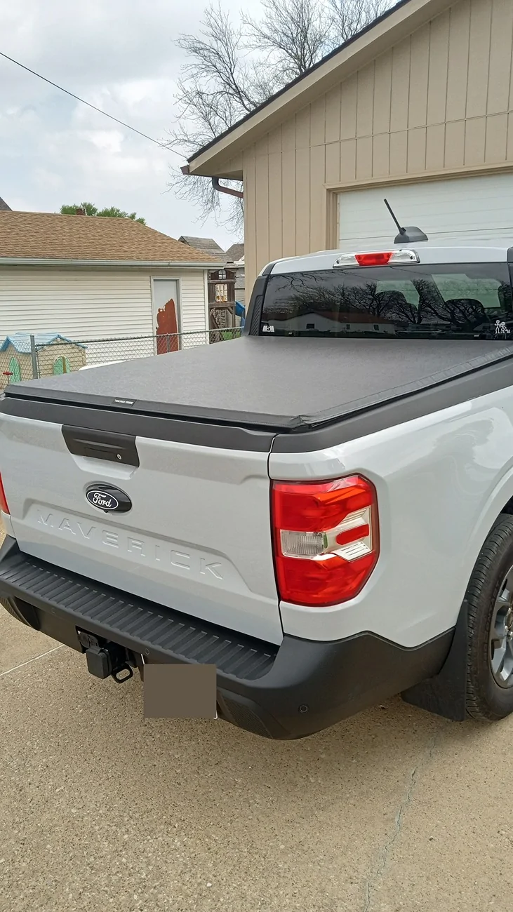

I've had this now since October and really like the fit and looks. It also has held out rain good. Except with the power car wash does get a small amount of water in, but nothing to worry about. My main issue is driving at highway speeds and especially with a 20-25mph wind this cover will flop up and down and make a lot of noise you can hear in cabin. It was so bad yesterday, and it was a breezy day, that I just pulled over and rolled it up. I do not think air is getting under it, just the way it blows across it?? Was just curious if anyone else has experienced this as well. The cover is tight as a drum, maybe why it sounds like it :)

Ford Maverick Truxedo TruXport (GEN 2) Soft Roll-Up Tonneau Cover Flapping Issue IMG_20260417_120024845
Ford Maverick Truxedo TruXport (GEN 2) Soft Roll-Up Tonneau Cover Flapping Issue IMG_20260417_120031074_HDR
Ford Maverick Truxedo TruXport (GEN 2) Soft Roll-Up Tonneau Cover Flapping Issue IMG_20260417_120010755_HDR

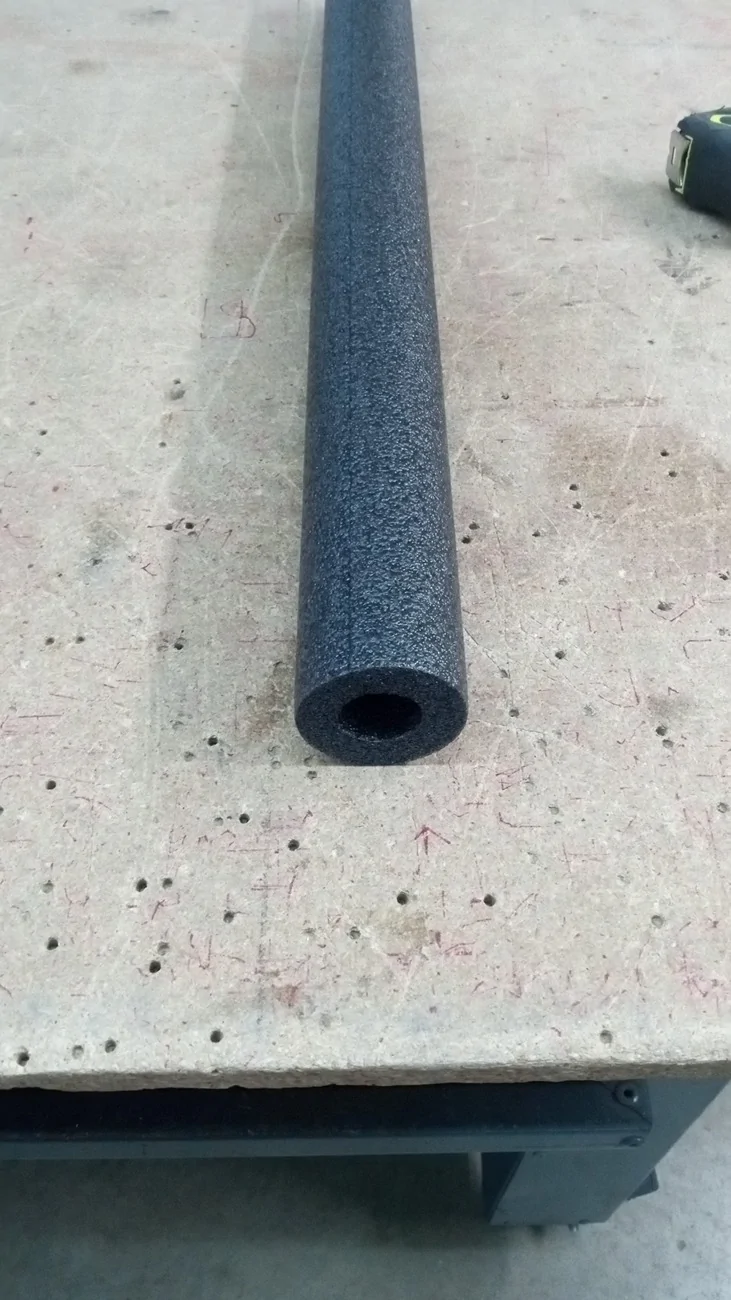

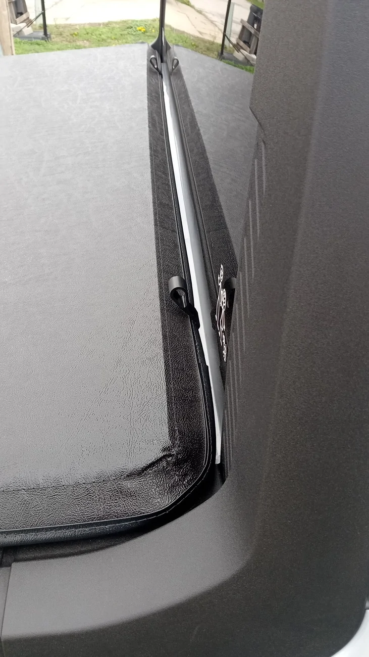

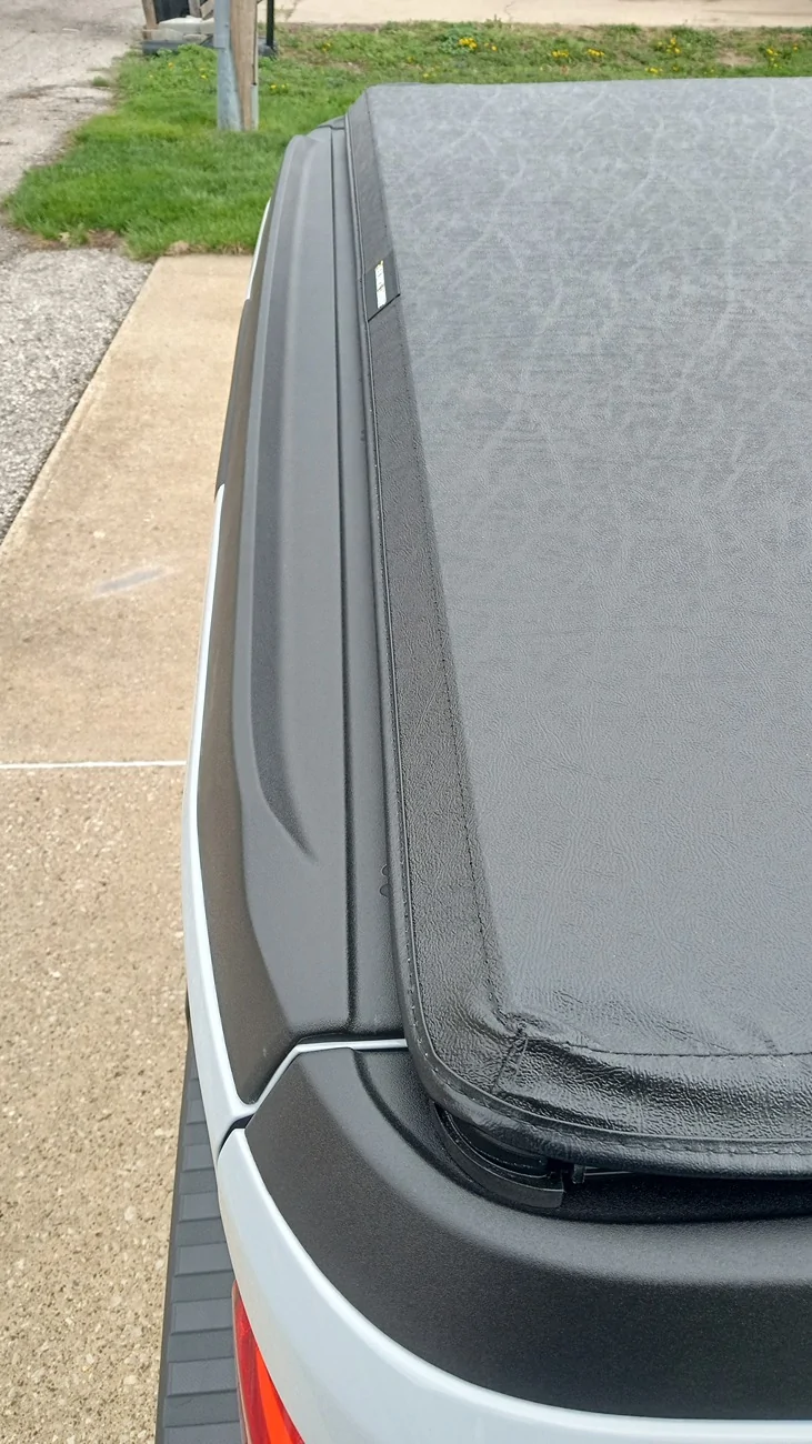

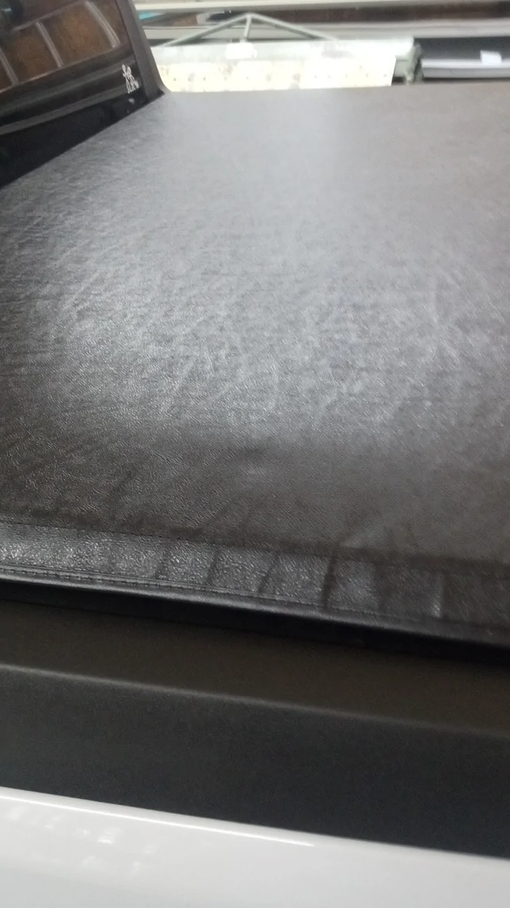

Just a little update here. I went to the hardware store and bought (2) 3/4 condenser pipe foam covers. They are pre-split and were 5'0 long. I cut them down to the fill length of the tonneau bar supports. I just slipped them over the tubes and nothing else needed. This made a huge difference in the fluttering and noise. Cost me another $6 for the foam covers, cheap fix. BTW the foam wall thickness is about 7/16" and you really cannot not see them. If you get just the right angle you can see a small deflection right at the edge where the foam starts.
Ford Maverick Truxedo TruXport (GEN 2) Soft Roll-Up Tonneau Cover Flapping Issue IMG_20260422_125816637
Ford Maverick Truxedo TruXport (GEN 2) Soft Roll-Up Tonneau Cover Flapping Issue IMG_20260422_124553862

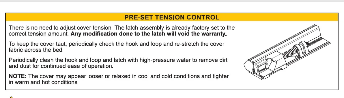

Well, The version2 model of this is preset from factory. There is no adjusting the spring tension. Any adjusting will void warranty. The cover is tight as drum. See my update (post #10)
Ford Maverick Truxedo TruXport (GEN 2) Soft Roll-Up Tonneau Cover Flapping Issue Screenshot 2026-04-22 160337
I have a different brand. I suspect the "no need to adjust the tension" is probably about as effective as the Auto AC feature!!:unsure::sneaky:
