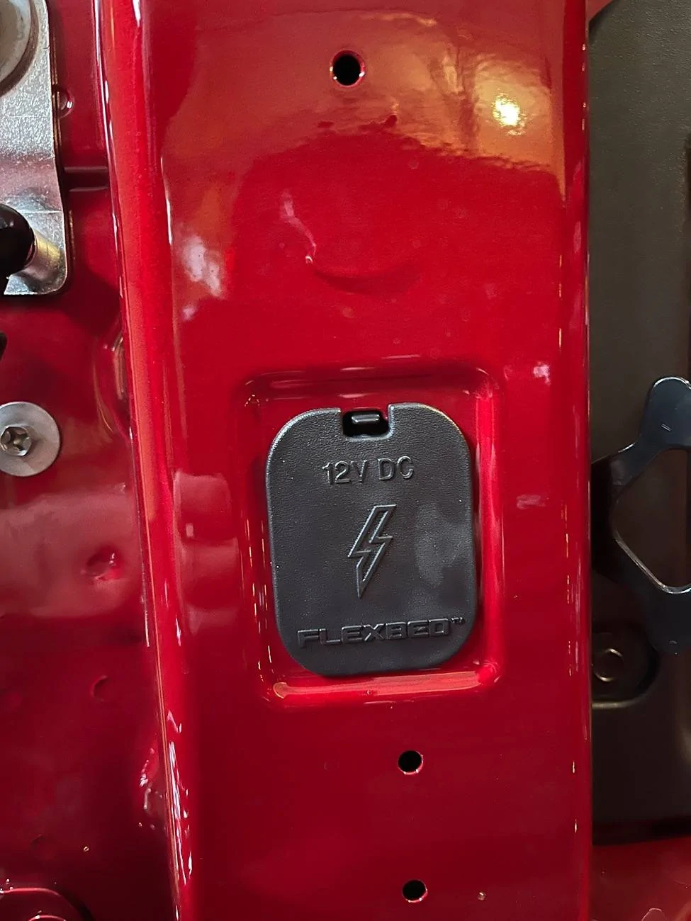

What is the 12 V DC Flexbed port for? Thanks
It's where the 12v wire that came loose with your truck can be plugged in to get (20 amp fused) tap which will stay hot if itbhas something using current.

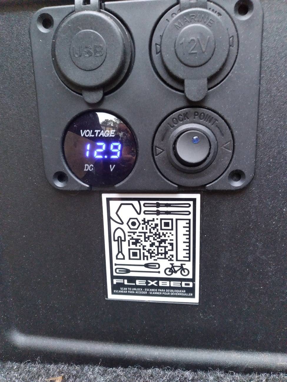

This is what I installed in my 2022. Putting another one in my 2025. The switch was for lights I put in the bed. 12v outlet was good for running my livewell for fishing.

Where did you get it and how is it held in there?
I got it off ebay. I used a 1 1/8" paddle bit to drill the holes to fit the switches-plugs. They each have a lock ring on the back side that I tightened down and that holds the plate in place, no screws needed. You do have to be careful to center the drill hole in the plate holes.

If this is tied to the terribly undersized and inadequately charged battery under the back seat, you put a 20amp load on it and you will get about an hour out of the battery before its dead, since the Maverick charging system only charges that battery to a 50% SOC.

I believe that circuit is the one that stays on for 90 minutes or until the 12v soc drops to 12.1 volts. So the battery save function would continue to operate same as it does currently. No difference just would still be recommended to put truck into ready state when using battery.
