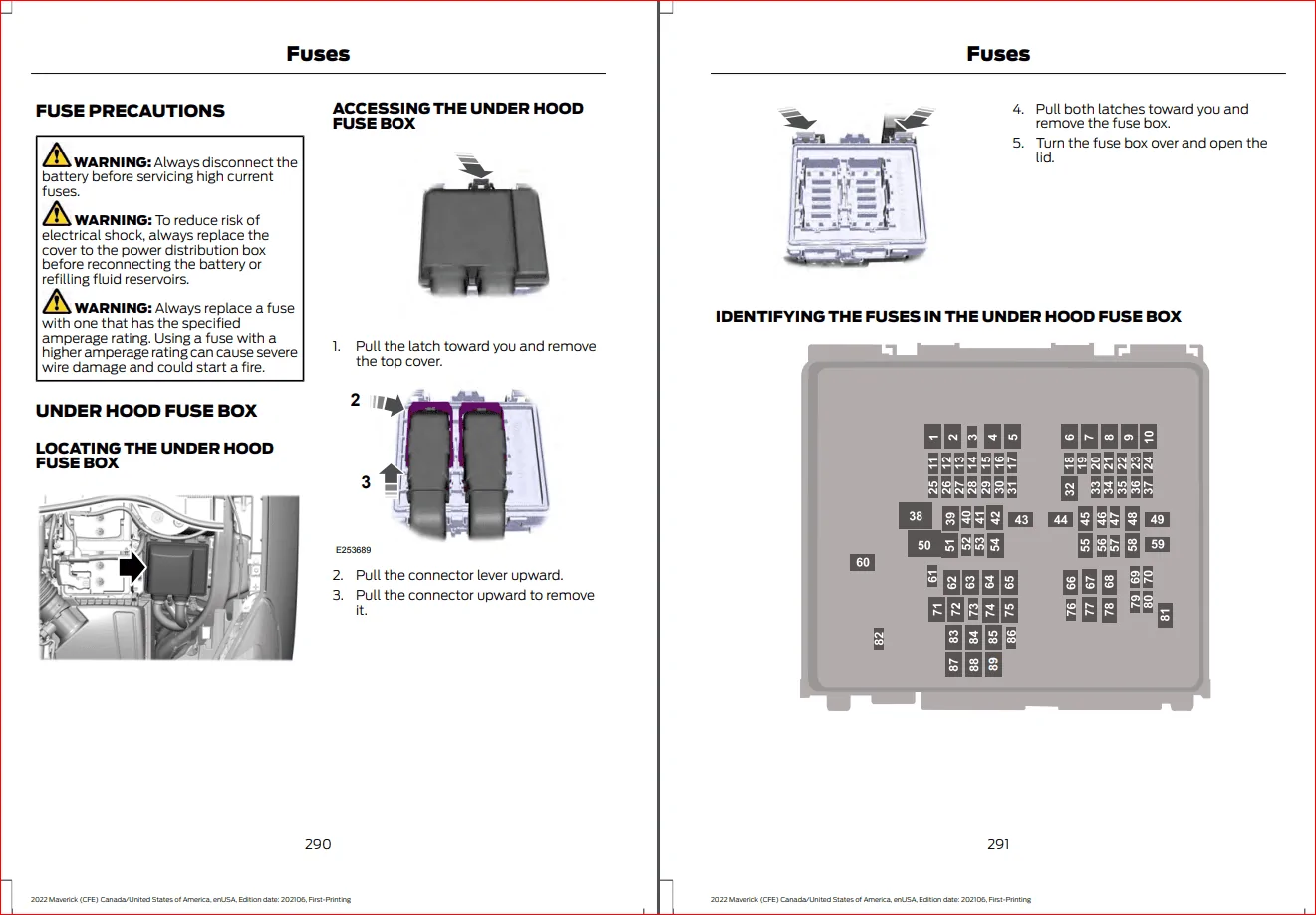

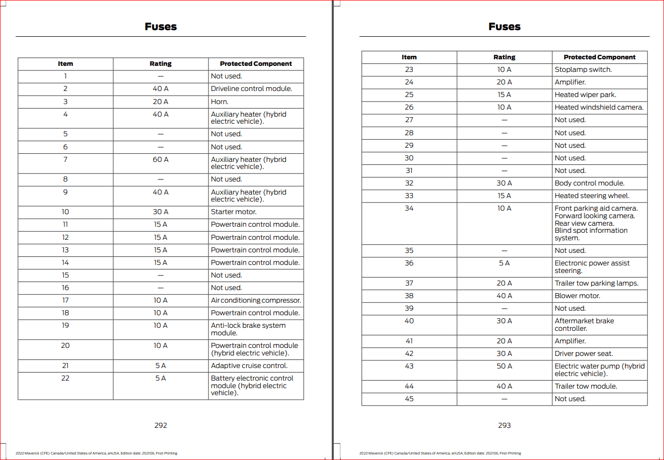

Well, stupid question....where are the fuses under the hood? I see a box with a cover, removed the cover and all there is are two large connectors. Do I have to take it apart?
Like an Escape BJB:
Yep.
Another better idea from the folks that brought us the Edsel, the fuses are hidden on the underside of that box. remove the 2 connectors on top, check for/there might be a wire or wire connector attached to the outside of the box that needs removed, and then there should be some clips to release to remove the box and flip upside down to see fuses. Just make sure the box you are going after has no orange coated wire harnesses going to it, that's high voltage and you are looking for the low/12 volt fuse box.
