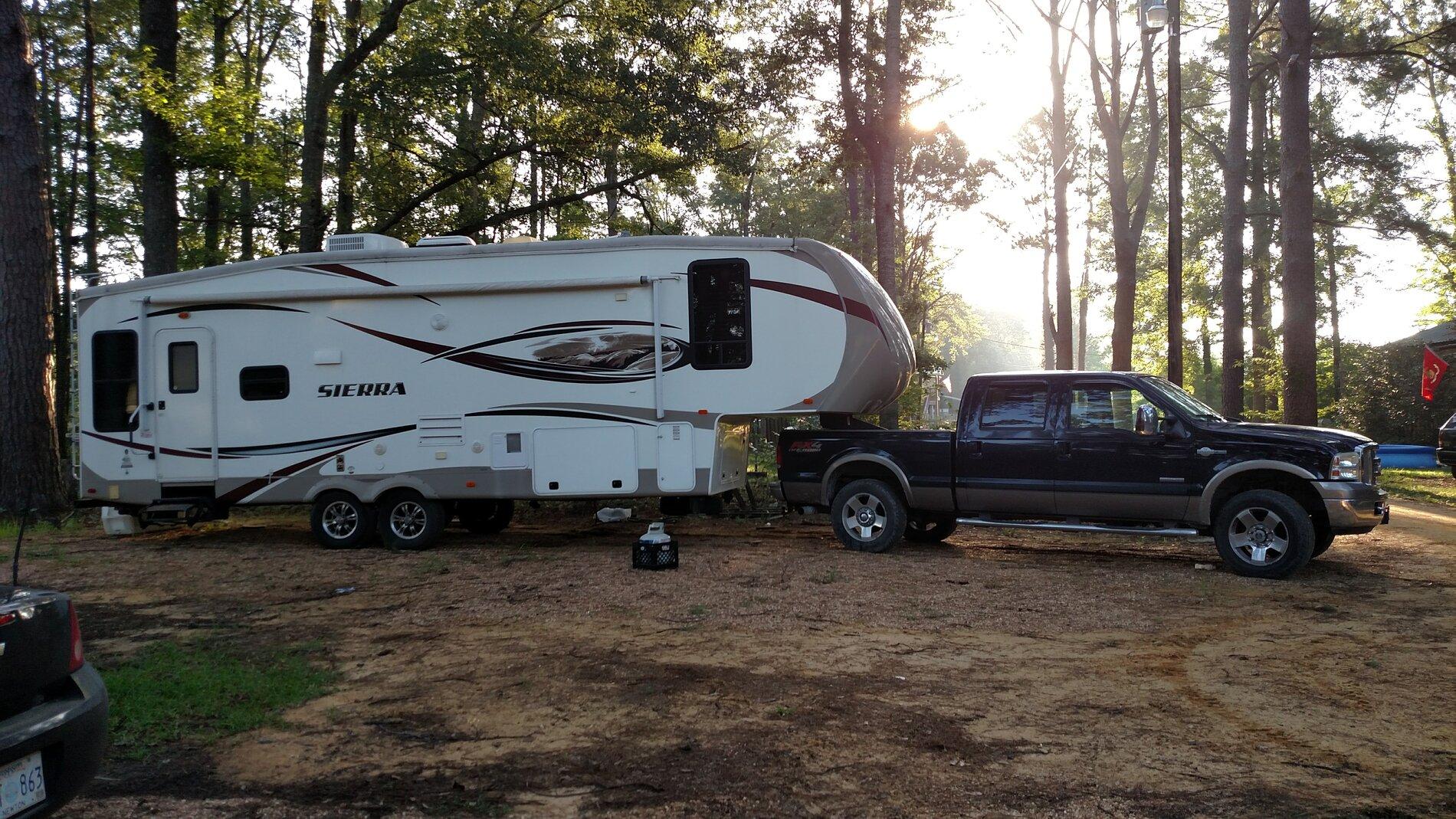

I'm sorry but if towing a camper is your main purpose then a 2k# one with the eb and 4k towing package is the only way to go with this truck or step up to the Ranger.
Ford Maverick Travel trailers for the hybrid IMG_20170706_070828807
You clearly have no appreciation for the minimalist aesthetic. I would NEVER tow the pictured beast...with ANY vehicle. I was a backpacker, just recently getting old and soft and transitioning to car camping. A teardrop trailer at 1300 lbs would be the next step. After that, I'll keel over dead.
