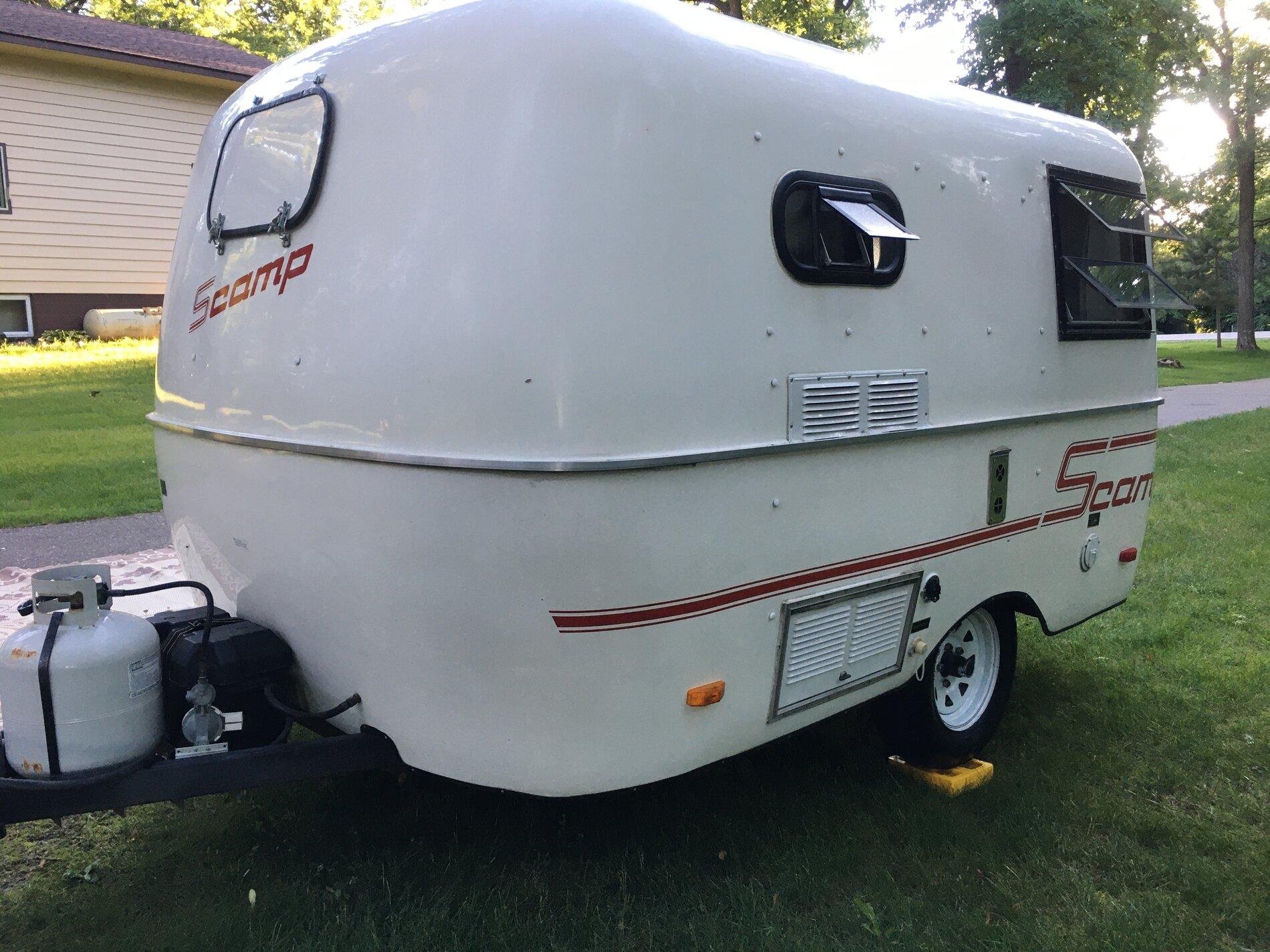

We towed around a 13’ Scamp all over the Midwest with our Honda Element (1500lb capacity). No trailer brakes, never had a problem. Camper probably weighs 1100-1300 pounds. (manual says 950 lbs, but I know it’s more than that). It would match up well with the hybrid, and be within all the specs except for the “frontal area” limit. Sleeps four, and can stand up straight if under 6’1”. Neat little camper, but a 3 to 4 year waiting list on a new one unfortunately.
Definitely more frontal area than Ford specs.

That Jayco weights 1585, the hybrid Maverick weights 3674, the Maverick's GCWR is 6010.
6010 - (1585+3674) = 751. As long as you, your family, friends, gear and fuel don't weigh more than 751 you're good to go.
I'd question the 20 SF frontal area limitations, since the frontal area of the Maverick itself is about 30 SF.
So if you exceed that frontal area, your mpg will drop. Anything else?
We are looking at a Scamp trailer like the one that was posted.
