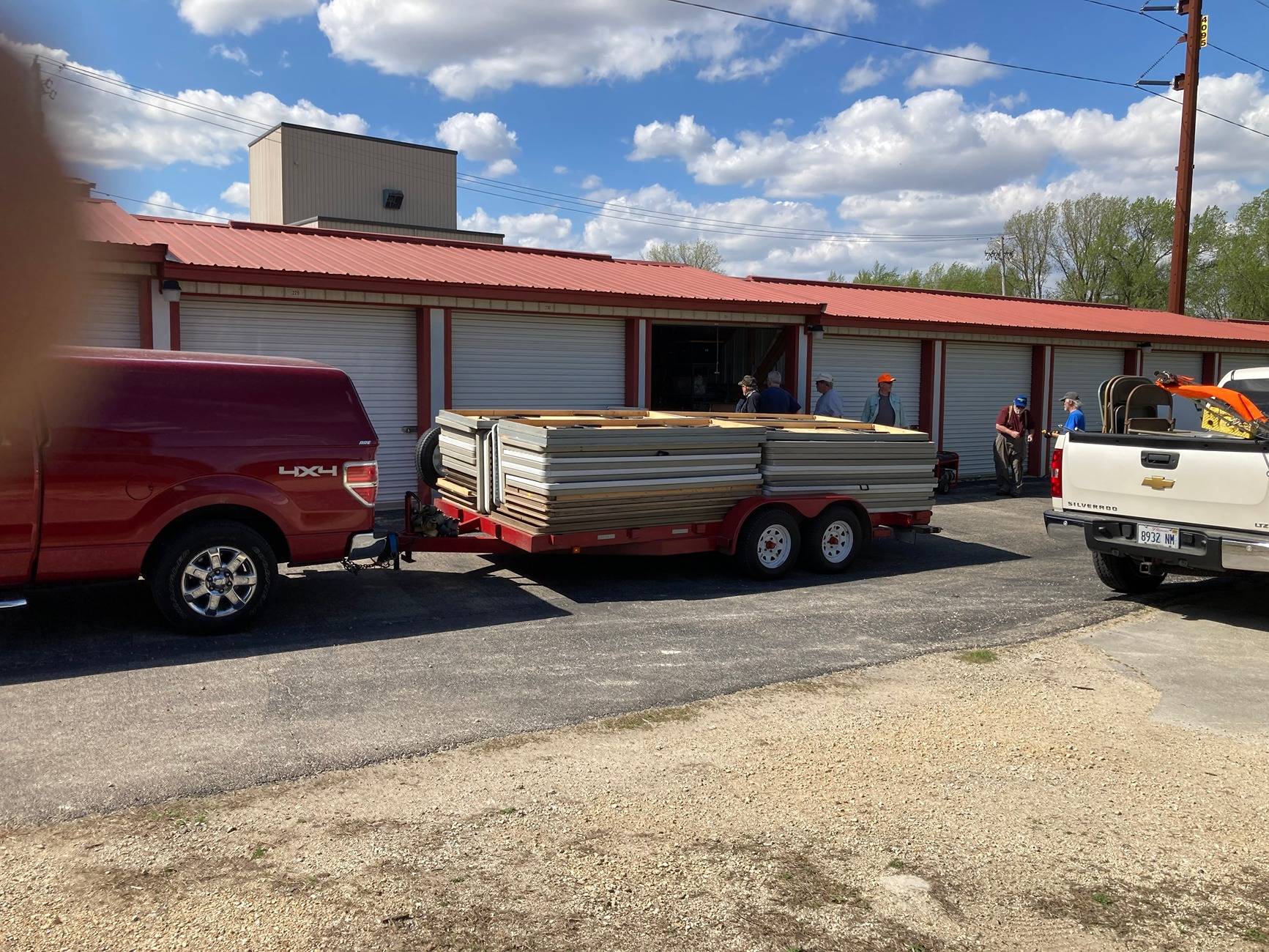

I was surprised first time I hooked up to this. I runs as stable as my old F150, accellerates as well too. Have about 2500 lbs here though the tongue weight is much less than yours will be. The proof will be when I haul a load of 70 plastic tables for our local HAM Radio Club this spring. Am estimating that will be very close to the 4000 lbs. limit!

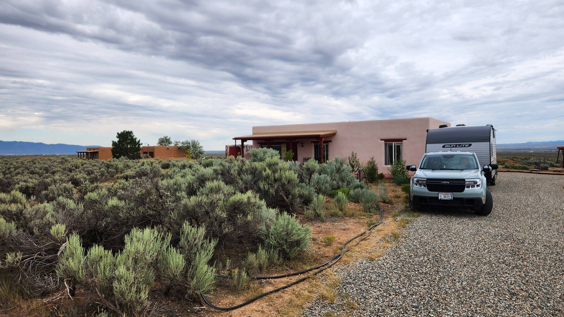

I pulled a Sun Lite 19RK, ~ 3000#, 5000 miles last summer, Illinois to California, with my 2023 XLT. I averaged 14.5 miles per gallon on my trip. I had zero problems going over the Sierras on I-80 and then coming back on Interstate I-40. Lots of mountain driving.
Ford Maverick Towing capacity 20240808_083236
