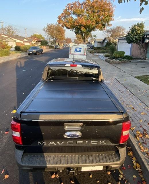

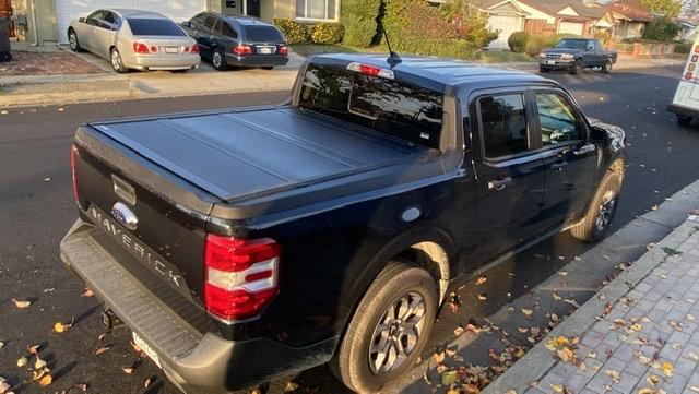

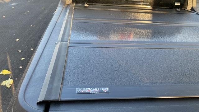

Installed today. Fits well. Looks great.
Needs one modification to the directions.
Undercover Armor Flex
Ford Maverick Tonneau Cover Buying Guide 4C95668B-2131-4E0B-BD40-3001D56672E9
Ford Maverick Tonneau Cover Buying Guide D18CA943-ADD5-4F89-97DC-D5F189CE87E4
Ford Maverick Tonneau Cover Buying Guide EA345EE6-1685-4CBC-82C6-1303ABF02718
Ford Maverick Tonneau Cover Buying Guide 50E4E20F-1CD9-47BA-89E0-4D46964D4E26

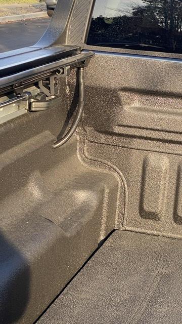

Water drain holes provided by Ford.
Ford Maverick Tonneau Cover Buying Guide 1C7965DB-D7FB-4F7C-9C5F-7CCC9B9CF5F1

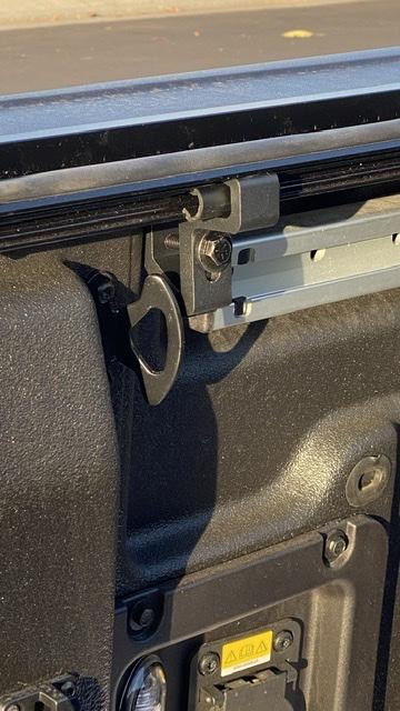

Have to move the clamp nearest the tailgate a little bit forward to clear the tie down point. No biggie. Easy to do. Just remember to do it
Ford Maverick Tonneau Cover Buying Guide CAD9F331-306D-4CCA-84C3-105A27FFDFCC
