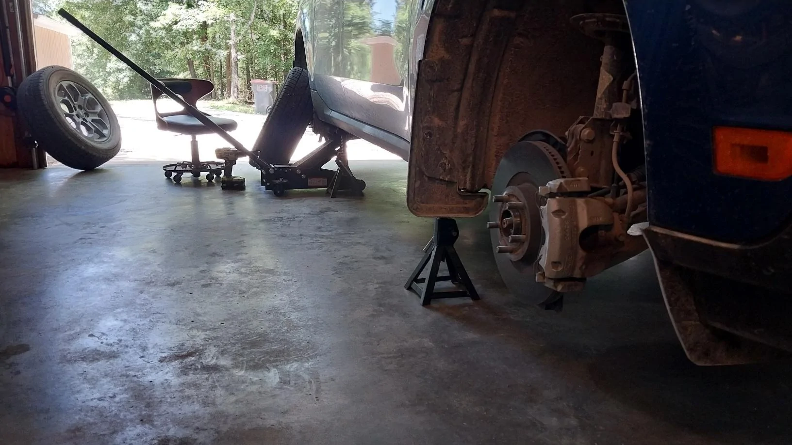

Going a bit faster this time. Should be done in 45mins or so.

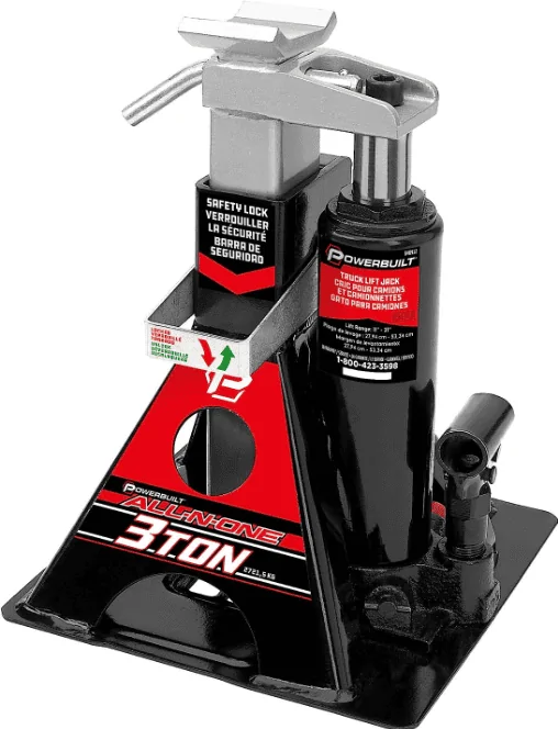

I bought two of these at the recommendation of a forum member and be damned if you don't need all 11" of clearance for them - so these won't work on the Maverick.
I had a 2x10 laying around so I cut two pieces and drive up on them which allows just enough clearance to slide them under the truck with the pinch weld rubber adapter on the bottle-jack-stand.
EDIT: I did buy the 3 Ton jack - the 2 Ton version should work.
you might consider the higher quality CAT 4 ton jack/stand combination for double the price
Amazon.com: Cat 240342 4 Ton Truck, Bottle Jack and Stand in One, Car Lift Equipment for Repair-240342, Yellow : Automotive
