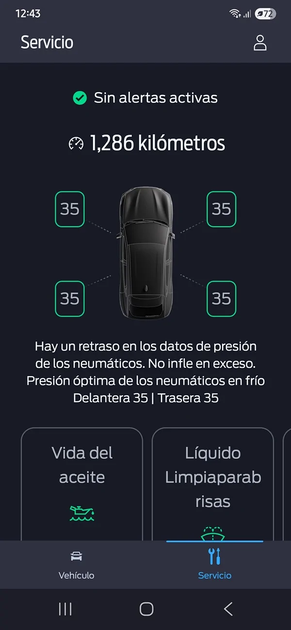

Expect to jump 2PSI itself, 35PSI cold jumped to 37PSI when hot
I like to running at 35PSI cold
Ford Maverick Tire pressure when hot. Screenshot_20250824_124340_FordPass
