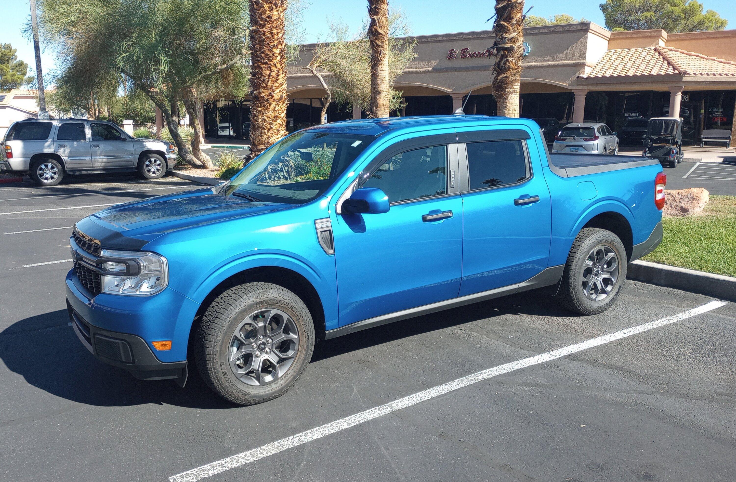

Ford Maverick Tire Pressure is suppose to be... IMG_20220925_145521030~2
3. 235/65/17 on my XLT Hybrid 32 psi cold 35 PSI when hot . 8000 miles rotated at 5000 been From Tn to Ca no problem .
