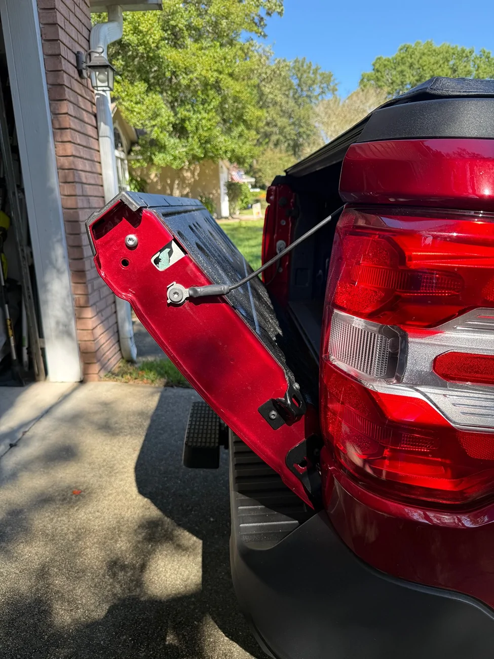

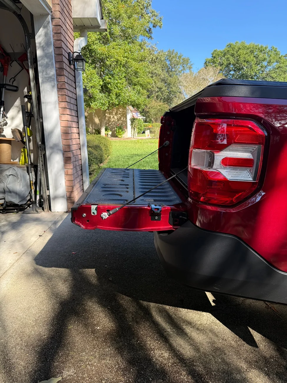

I am familiar with the two tailgate positions officially provided by Ford.

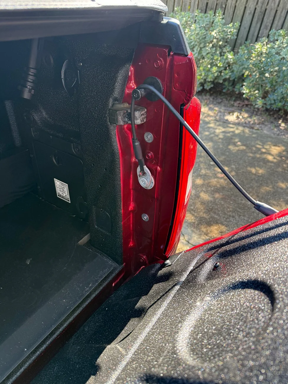

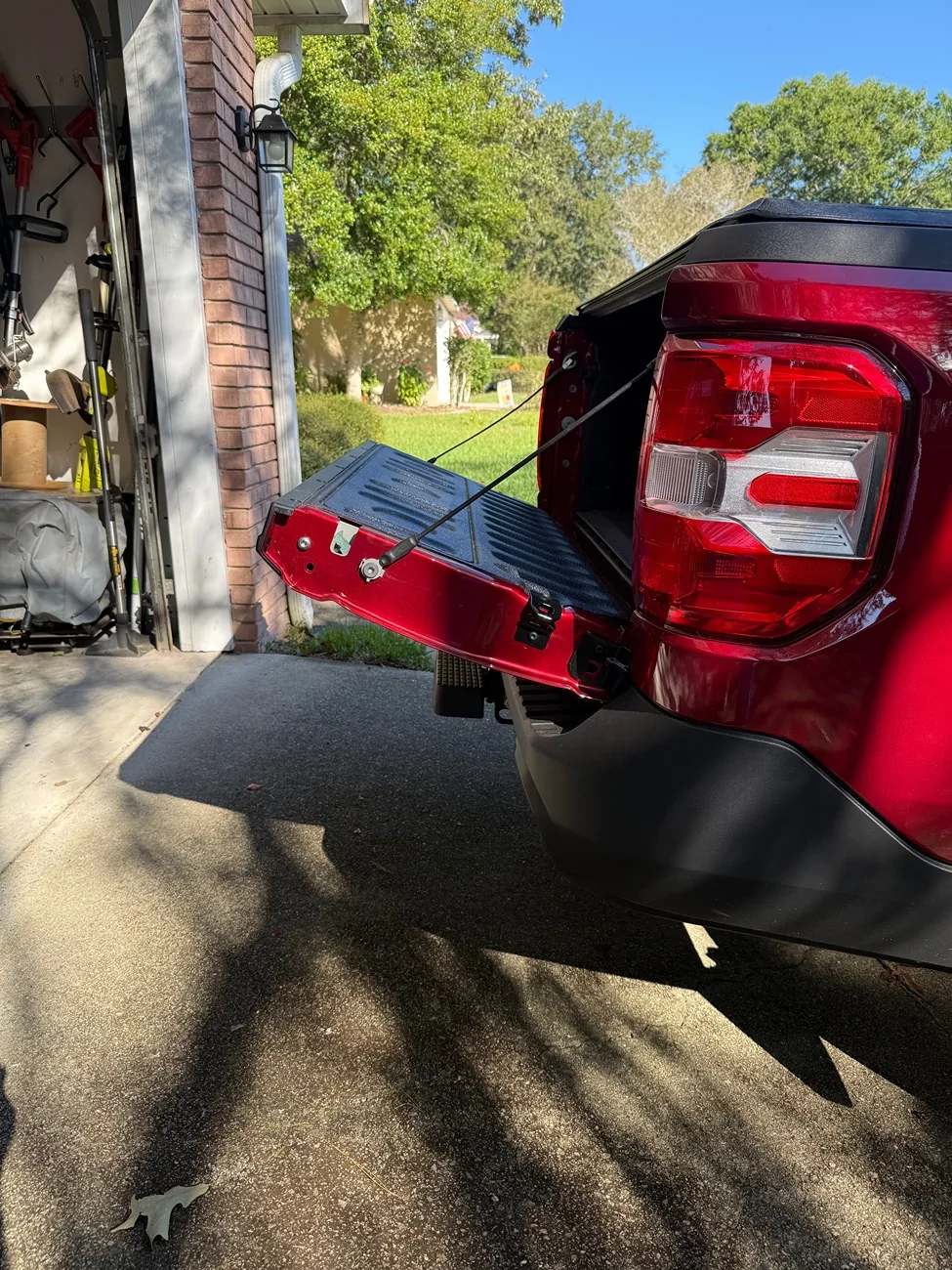

But looking at the provided arrangement, it seems that there is a third position that might work. This is what I found:
Ford Maverick Third Tailgate Position? IMG_1954
Ford Maverick Third Tailgate Position? IMG_1951
The standard connection point for regular tailgate operation has a wheel with a groove - about the same size as the tailgate cable. Looped in like this, it seems to be "home". I drove it around town for a while without a load on it and it held beautifully. I like that it allows a long load (just a few 2X4's, or in my case, a pole mounted lopper) to be held up a little higher without having to open up the bed cover.
What I don't know is if this is some kind of specific no-no from Ford, or if anyone has tried it with bad results.

My only thought about it is that, if the load on the tailgate is light and the tailgate is allowed to "bounce", the cables could slip out of the grooves causing the tailgate (and load) to slam down to the fully open position. I don't think it's likely that would happen, but it's possible.

I had that concern too - still do. But my test drive, with almost no load on, resulted in no suggestion that that might happen. The cable seems to set itself inside the tracks of the "bed flat" attachment point. I thought "Oh, great, now it's gonna get stuck". but, no, it just seems to settle in and comes right back out.
FWIW, in this position, if it slips out and falls, the tailgate is in the tilted position - not flat

Good points. It will be more secure if the cable "seats" into the groove, and of course it will only fall to position "2", not fully open as I stated above, which should minimize damage in the rare event that they slip out.

I'm familiar with that configuration. I've used it, like you said, to haul lumber. I don't recall exactly when, but I saw that position demonstrated in a video. With some weight on it, I doubt the cables would slip off. I consider it a viable option. 😬

Good to hear! Thanks!
