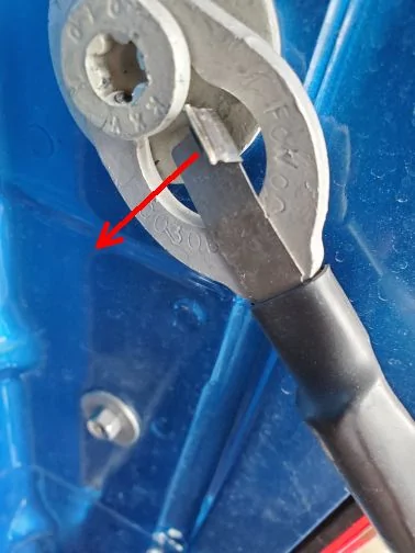

Don’t push forward or in, you need to grab the tab and pull out.
I pulled the tab away from the side of the truck per Brit24's advice, with the cable slackened, and the cable came off easily.
It is so funny, even with the other descriptions and your clear drawing I didn't get it. I showed the truck to my friend today and told him how I struggle with this and he did exactly what you are showing and told me "it is super easy". Yep, it is super easy when you think simply.........
