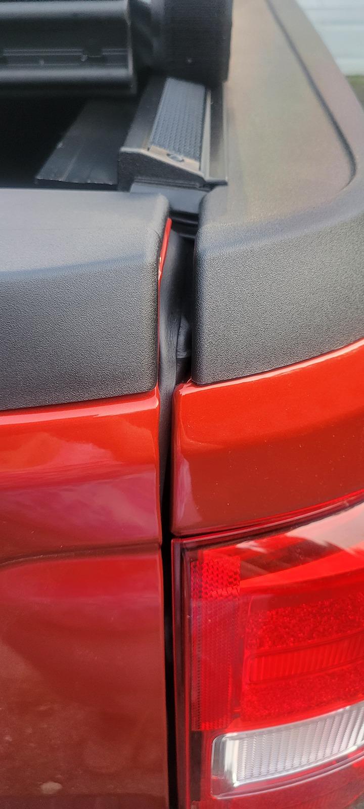

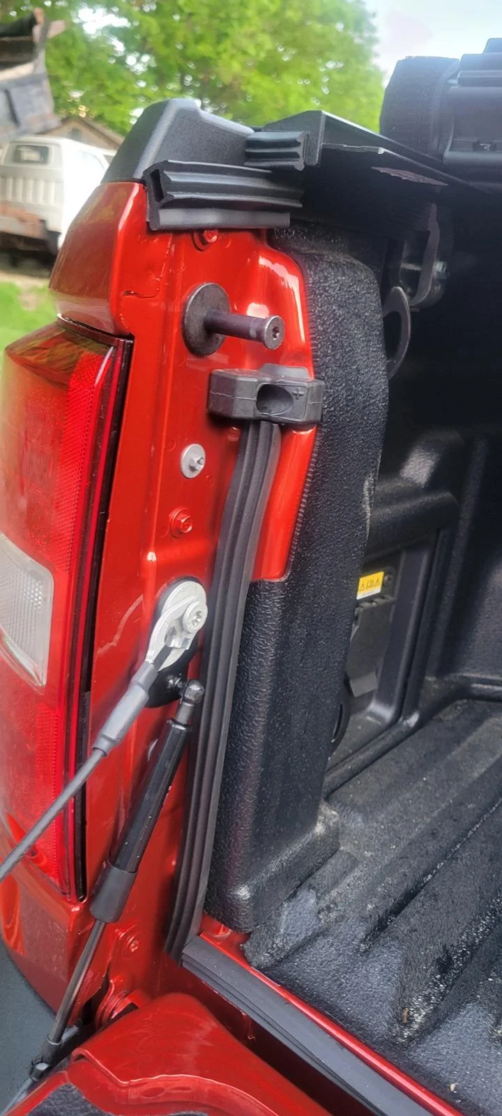

Tailgate seals don't work too well on the Maverick. I just faked an install yesterday. Nothing meets up like a regular tail gate. Gaps are way too big. I can show you what I did. Not sure how well it will work long run
Ford Maverick Tailgate Seal - Trailseal Tailgate Gasket 20240526_195433
Ford Maverick Tailgate Seal - Trailseal Tailgate Gasket 20240526_195425
Ford Maverick Tailgate Seal - Trailseal Tailgate Gasket 20240526_195411
If I had it to do over, I would skip the side piece on the inside at the side. (Photo 1) and just put a long piece the whole length of the side of the tailgate. (Photo 2)
Also, the piece across the bottom doesnt stick well because there is a little lip. Should have moved it up a little, or down a little.
It's a trial & error process figuring where to put the tail gate seals~~~ is your cover the Leer product or a Truxedo Sentry CT? Do you have water leaks at the front corners? If not, how did you solve that dilemma?
