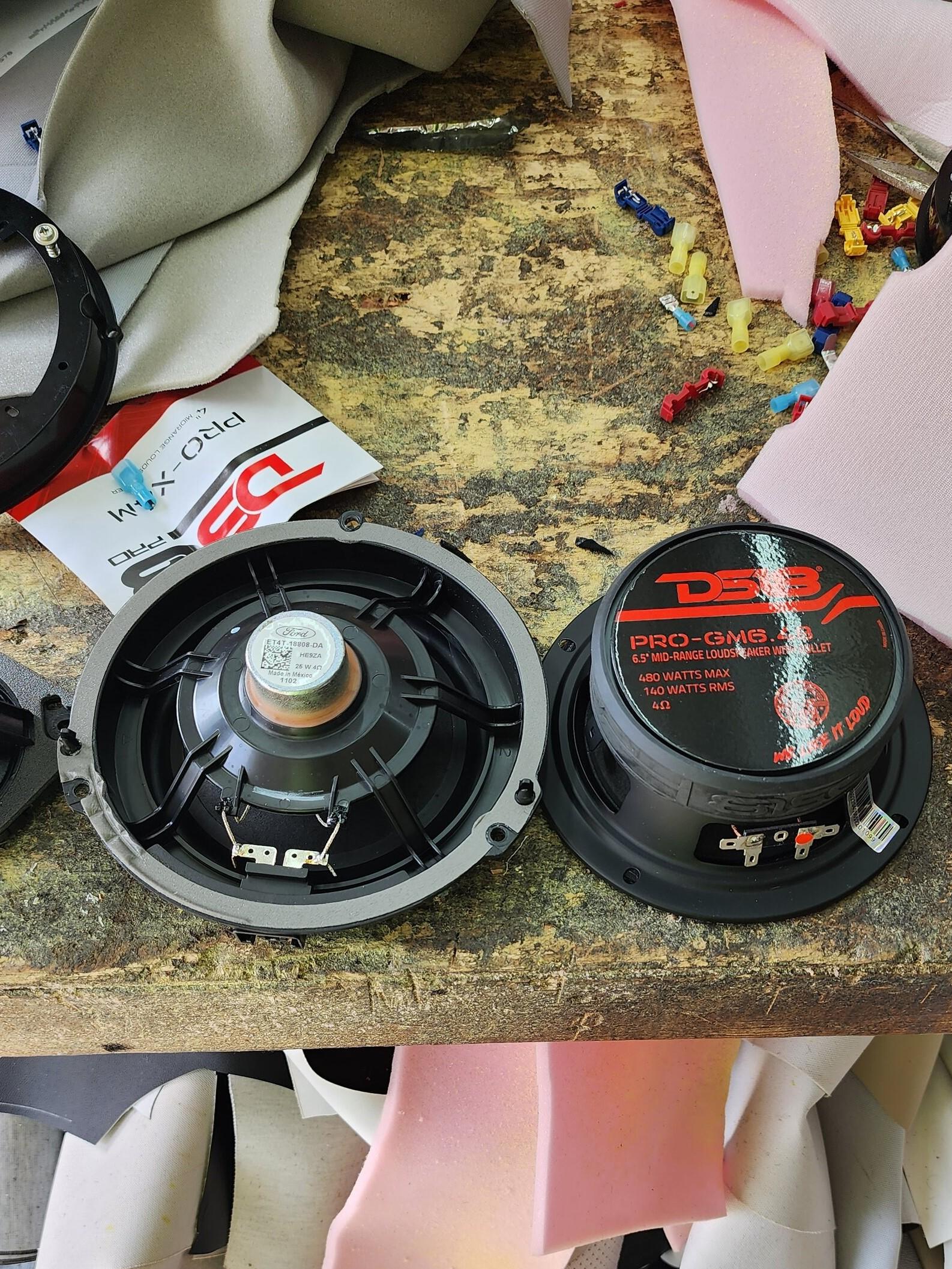

Yes, the speakers are so light because of the tiny magnet. They are only rated at 25 watts per the photo of the speaker with the Ford logo on the left. They sound fine until they distort at high volume. My guess is if the speakers are rated at 25 watts, the amp is only 25 watts per channel (output to each speaker).
You are right, the stock amp cannot power better speakers adequately, but new speakers help. A new amp would be far more expensive and will probably not integrate with the touch screen.
The B&O, though not the best, is far more powerful at over 600 watts of total output. I think people are not happy with B&O because they expected thumping sound levels. Of course Ford limits the max volume for driving safety.
Sound quality is not just about max volume. A better amp, along with better 100 watt rated speakers with a bigger magnet, allows you to hear the full sound at lower levels.
This quick 3 min video has a sample of the stock sound system for those waiting for their Mavs. Sorry, I had to cut it short to not get a copyright strike.
Ford Maverick The stock audio system is great, actually. Here's why. Standard Mav spkr vs aftermarket spkr

Thanks for the speaker photo and video, maniac! This is helpful.

The stock speakers are cheap paper cones with tiny magnets. Audio technology has come a long way since the 70's.

Factory speaker use roughly 7 watts of power and have a crazy sensitivity hence why they can play loudly but not great. You can buy high sensitivity speakers that can also handle additional power if you amplify them. All aftermarket speakers come with massive magnets that requires power to move the cone for optimal results. Without amplification any speaker swap will only render slight audio improvement. Once amplified it will sound significantly improved. It's kind of similar to owning a sports car, you don't want to run cheap gas in it when it calls for race fuel.

What's the true RMS output of the B&O system? It sure as heck isn't close to 600 watts; 200, maybe? I'd be real pissed if I paid extra for the B&O system; total garbage for an "upgraded" system.
