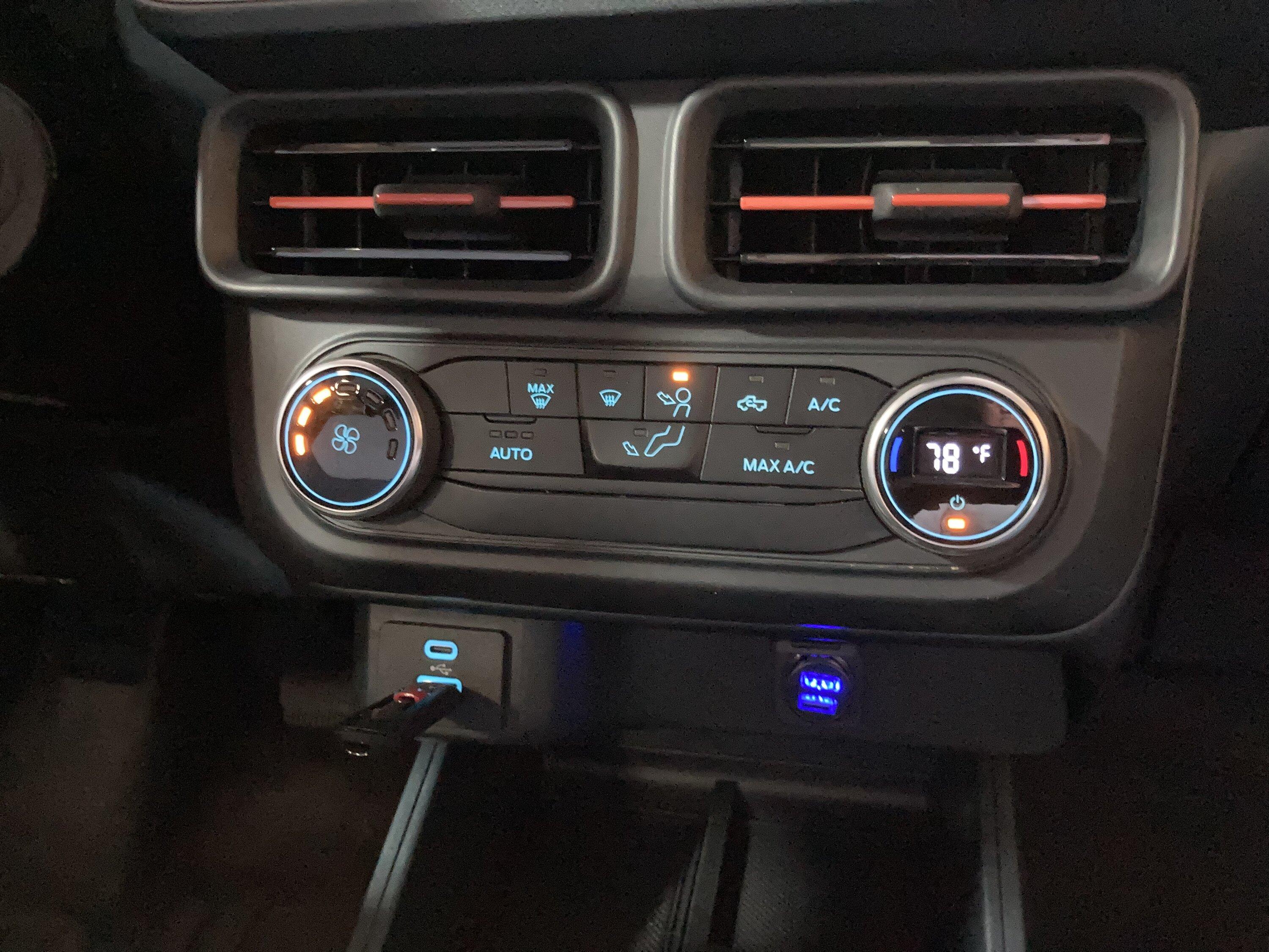

Hi, I may try that if it bothers me enough. Was the swap just a plug and play? Anything to do software wise?
I got an early Mav HVAC module with digital temp display from another forum member whose Maverick got wrecked. Very simple swap — plug and play, and it worked.
That whole section of the dash pops out, containing the two center vents and the HVAC module. Then it’s just two wiring connectors that snap into the back of the module.
But I understand that IF you happen to find one NOS (new old stock, never installed) you may need to run some Forscan to program it.
And, make sure you match your truck’s HVAC system, whether standard single zone or upgraded dual zone HVAC. (Mine is single, so temp reading on one dial)
I like having the temp setting always visible on the knob.
BUT you can live without it. Whenever you touch the temp knob, a big honkin’ temp display graphic comes up in the center of your screen, showing the setting, and changing if you turn the knob,
AND the current temp setting also shows small at the top of the screen, with the time.

It only shows up on the main display when you change it, IF you are using Android Auto..... If you are NOT using Android Auto, it does show at the top of the main display....

It was a simple plug and play swap for me but it was like pulling teeth getting those connectors off the back!! Lol
